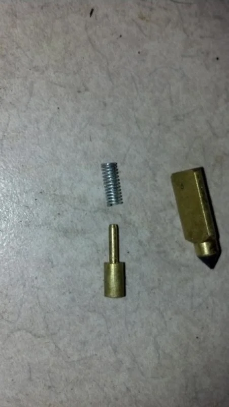

If I may I have one thing to put on here I have noticed building one now. The kit from Napa 2-1312 is the kit I used. I noticed the hard way you need to use the original needle for the float. They are too short in the rebuild kit and it dumps pure fuel thru the carb non stop because of this. The following pics will show what I am talking about. Other than that everything else in the kit was great for the 2 F carb that I worked on. Unfortunately I did not get a pic of it but will be going thru mine here in another week or 2 so will take a comparison pic then. But the following pic is the piece that was too short in the rebuild kit. The piece to the bottom of the spring is what I am talking about . It is about a 10mm too short if I remember correctly.
Hope this helps someone out there.
