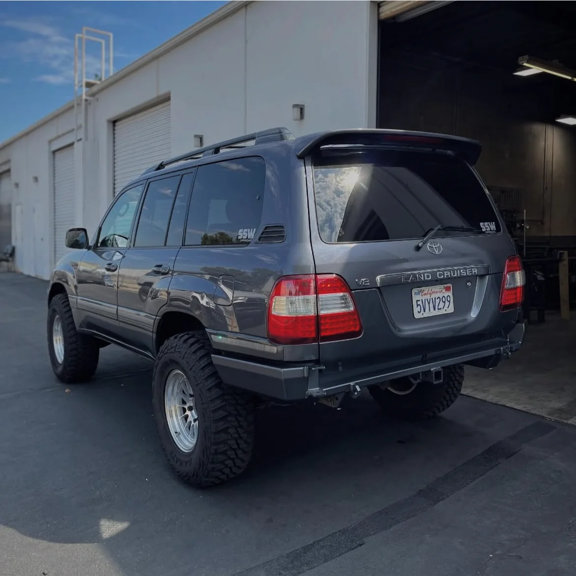

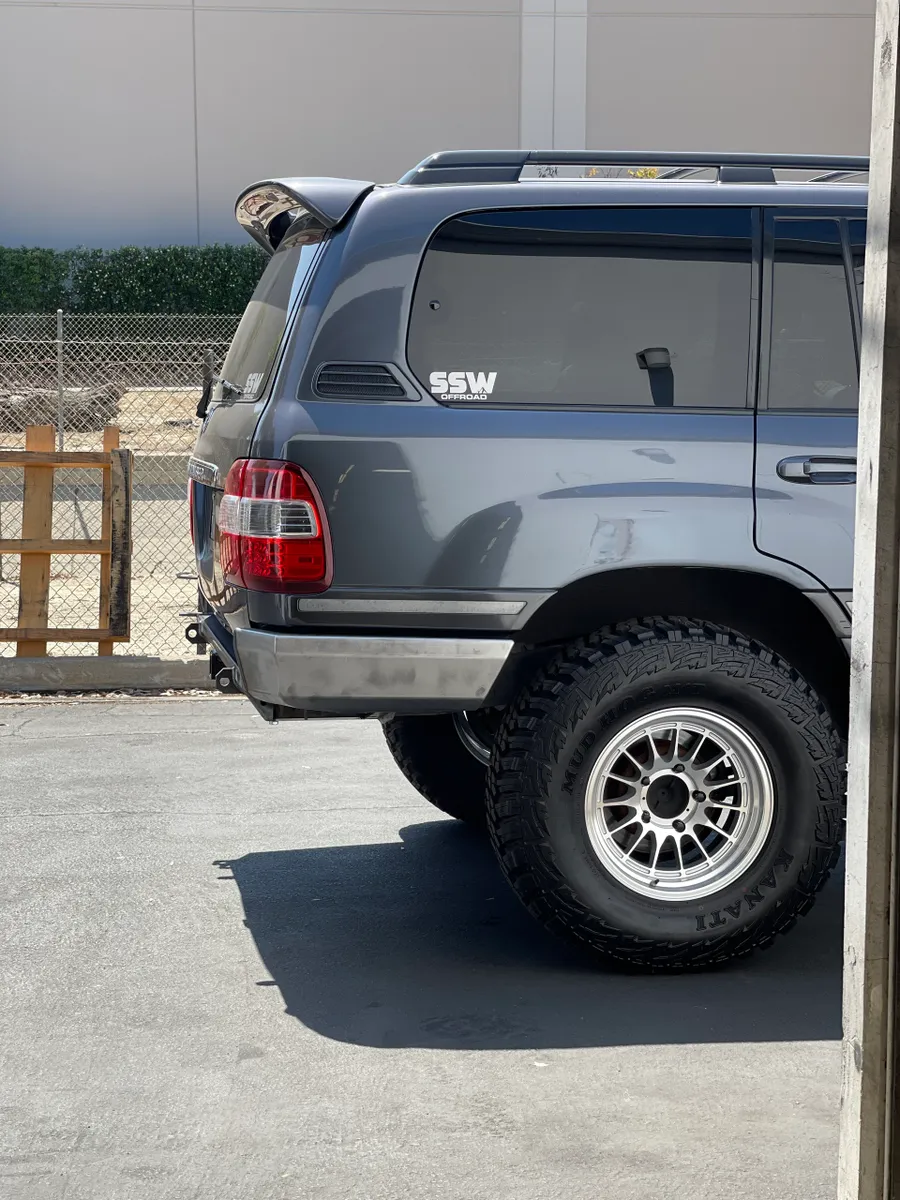

Does anyone know of any extreme clearance/ low profile rear bumper options for the 200? I don’t need swingouts so most of the bumpers that are made for swing outs look like they stick out too far when they are empty or don’t relocate the hitch so they still hang pretty low. Here are some pics of the style I am looking for from a 100 series.

Not a problem for me. I assumed cross member would need to be cut as that’s what’s necessary for the high clearance bumpers on the 100’s and 4Runners anyway

the nguyenworks bumper you pictured is awesome and indicative of most so cal off road shops ability to fab up a bumper. however the frame issues that others pointed out are really the limiting factor to a high and tight rear bumper. that being said if simplicity and clearance is what you want go for E&E, his products are stellar. If you want overbuilt and insanely stout, dissent is your choice without a doubt. seriously there's a video here somewhere of a dude's parked 200 getting rear ended by a hit and run driver in front of his house and the rear of the 200 is virtually unscathed.

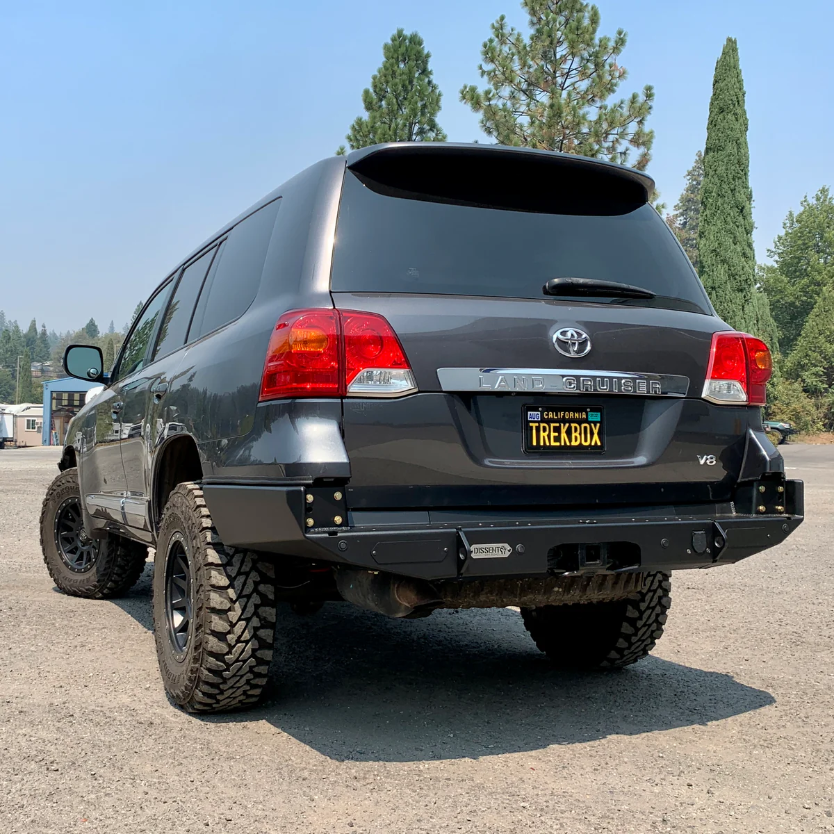

Yeah Dissent is what I am leaning toward the most but I don’t love the big underbite look with no swingouts.View attachment 4007845
The "underbite" is the minimum clearance required to open the tailgate. If you don't need/want swingouts, your spare will be a point of clearance. You'll also want to "resonator chop" because that will become the low point
