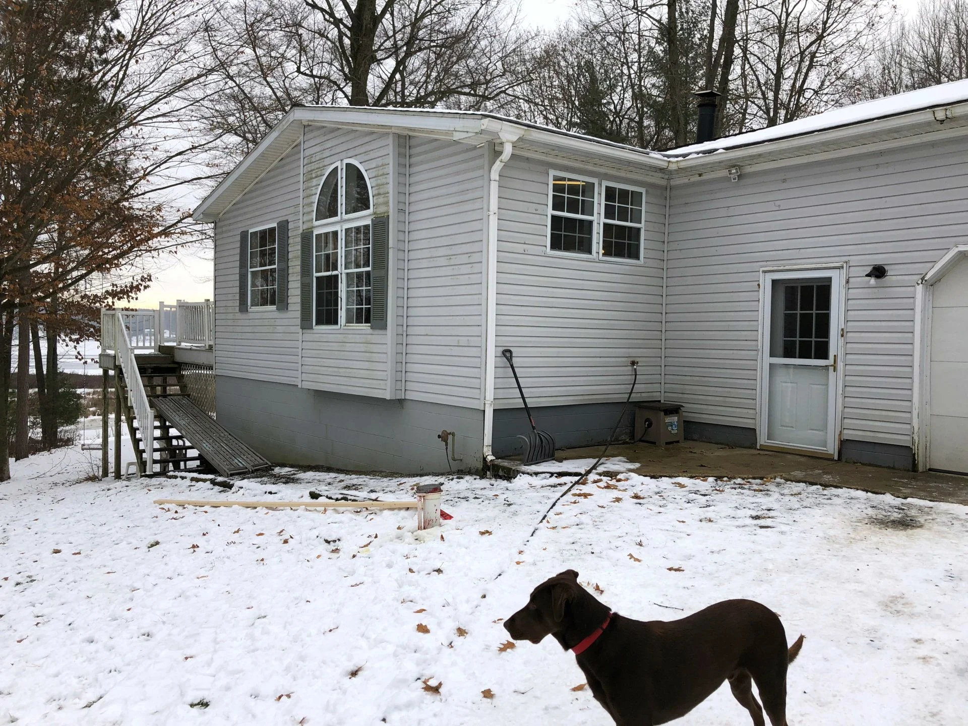

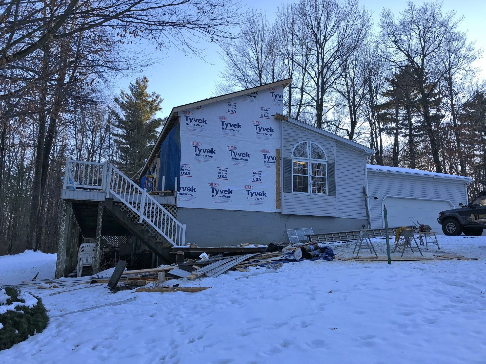

Here is how the home looked prior to us starting this project:

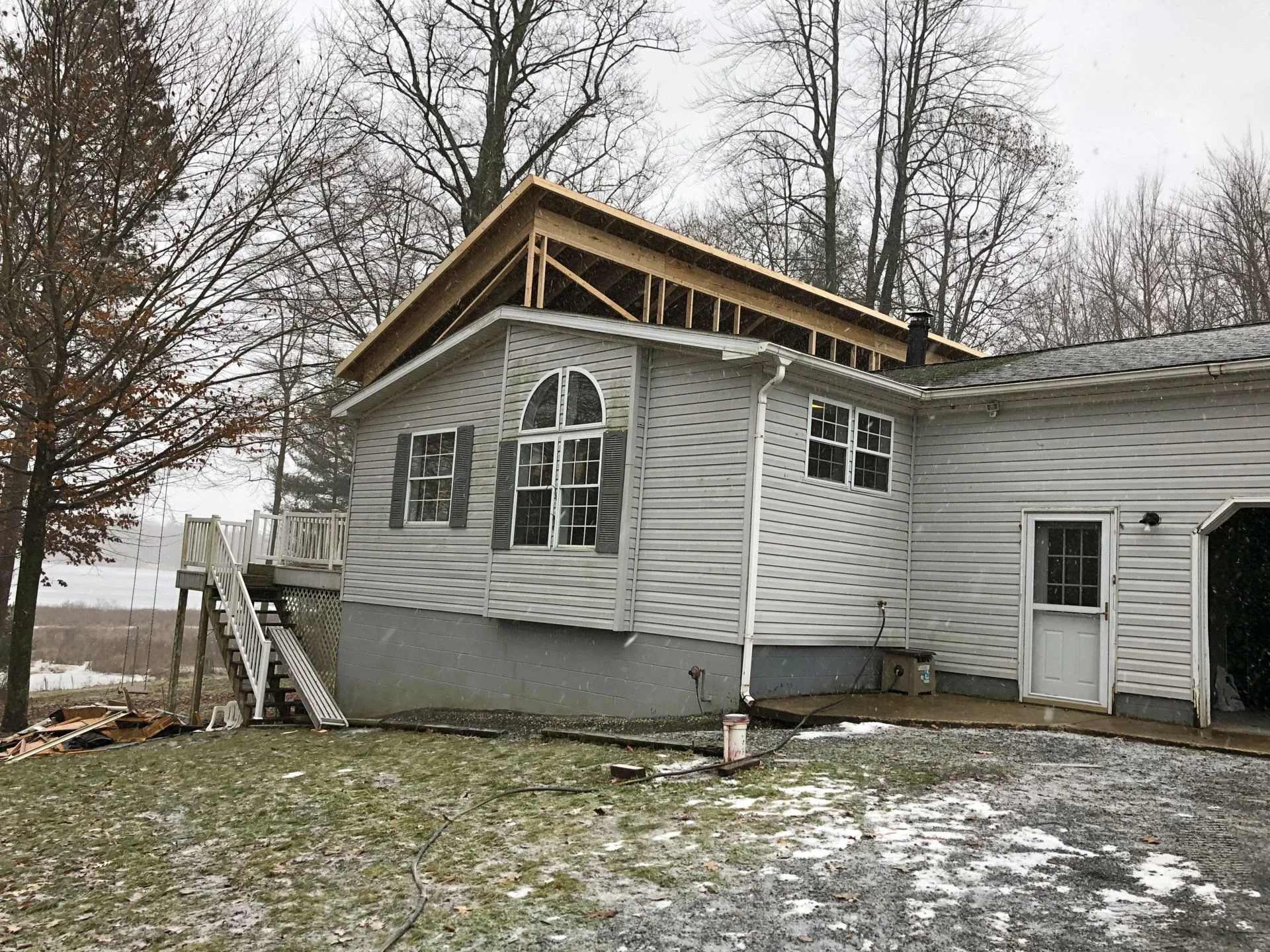

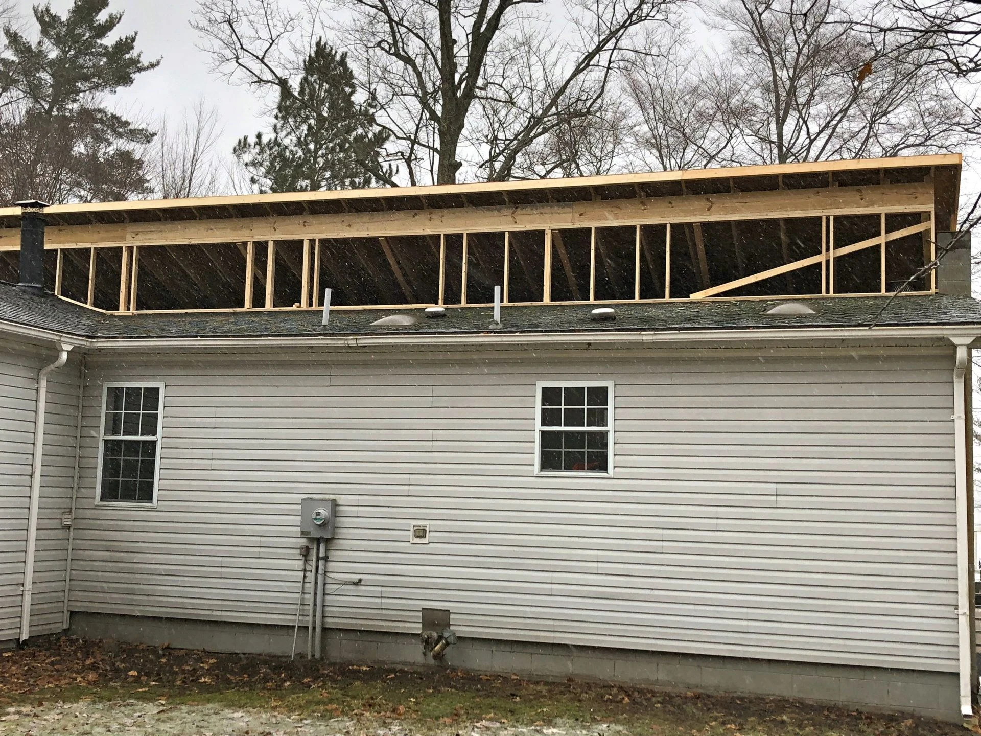

We started by installing beams to support the new roof:
First load of lumber arrived:

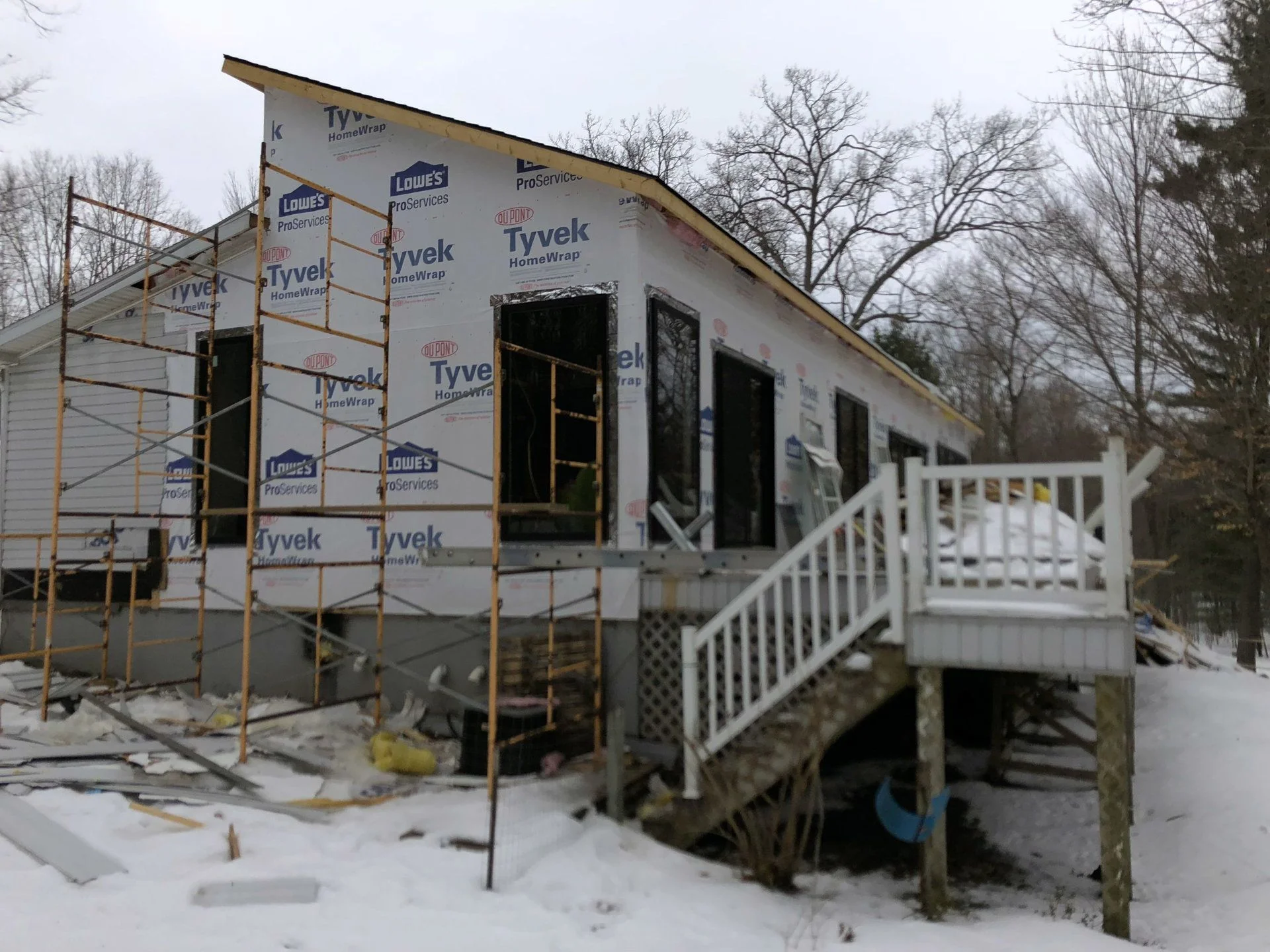

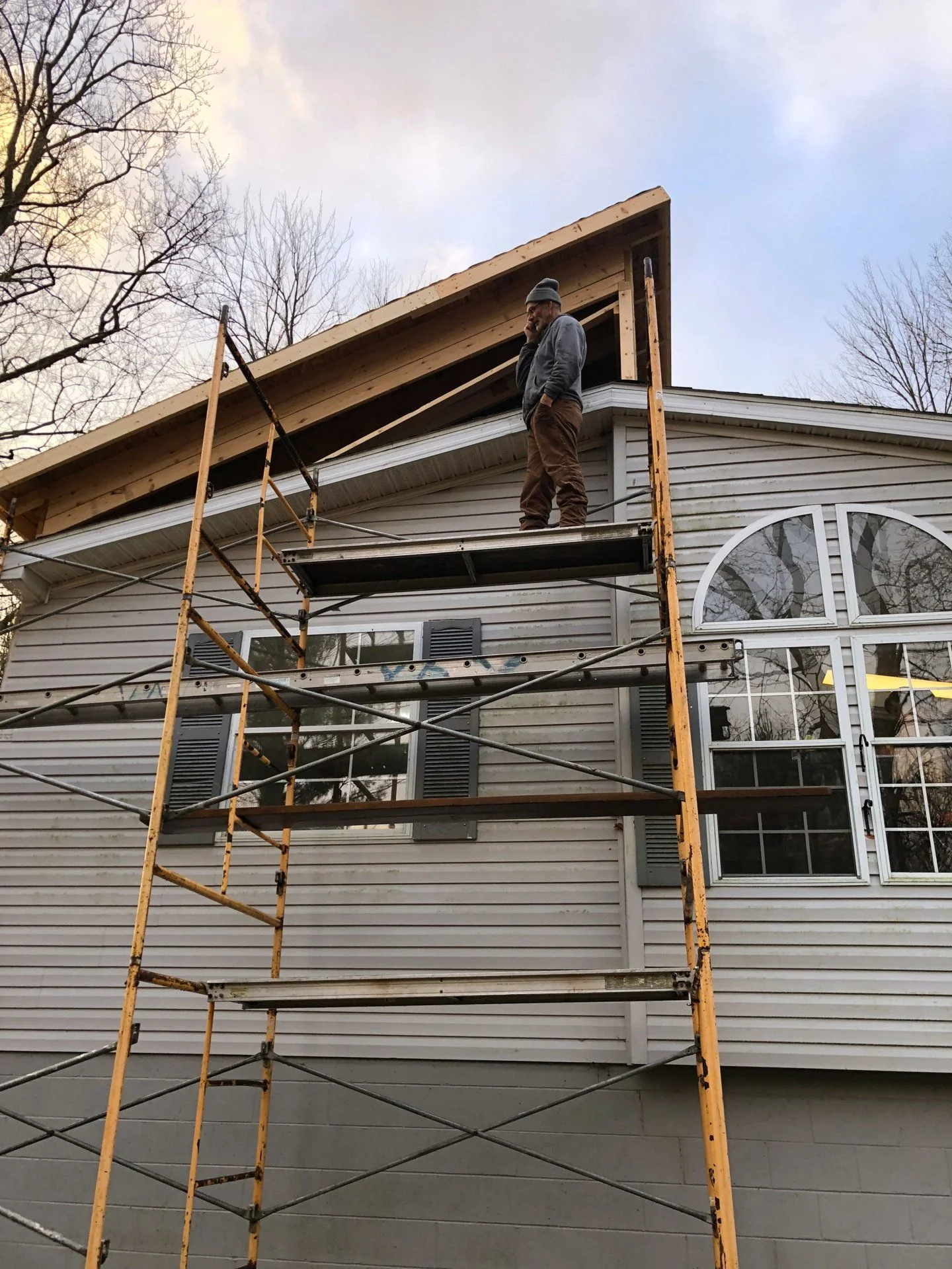

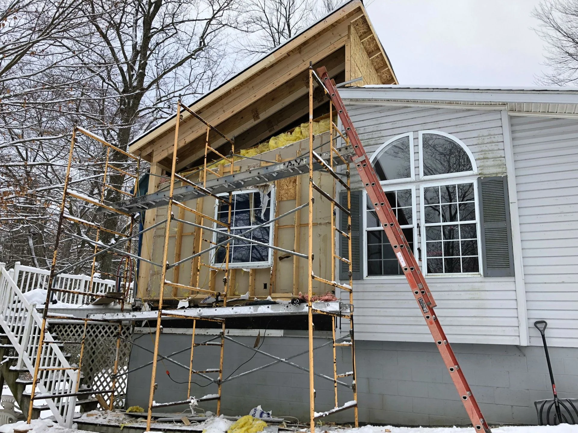

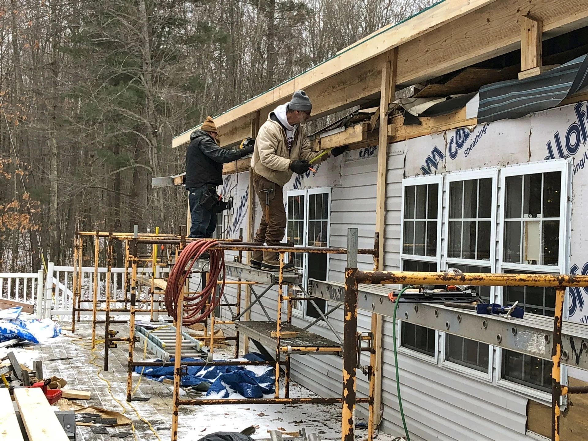

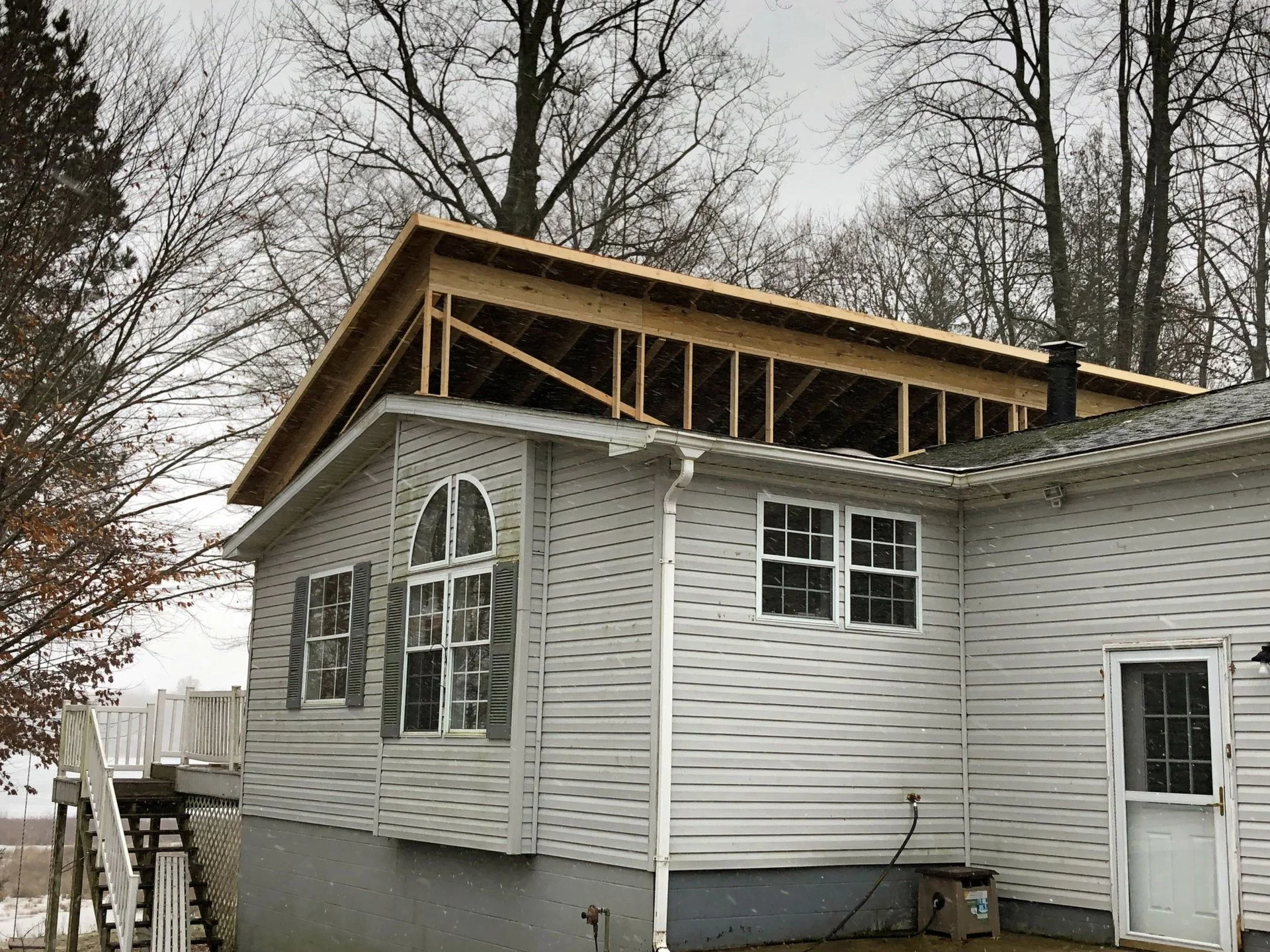

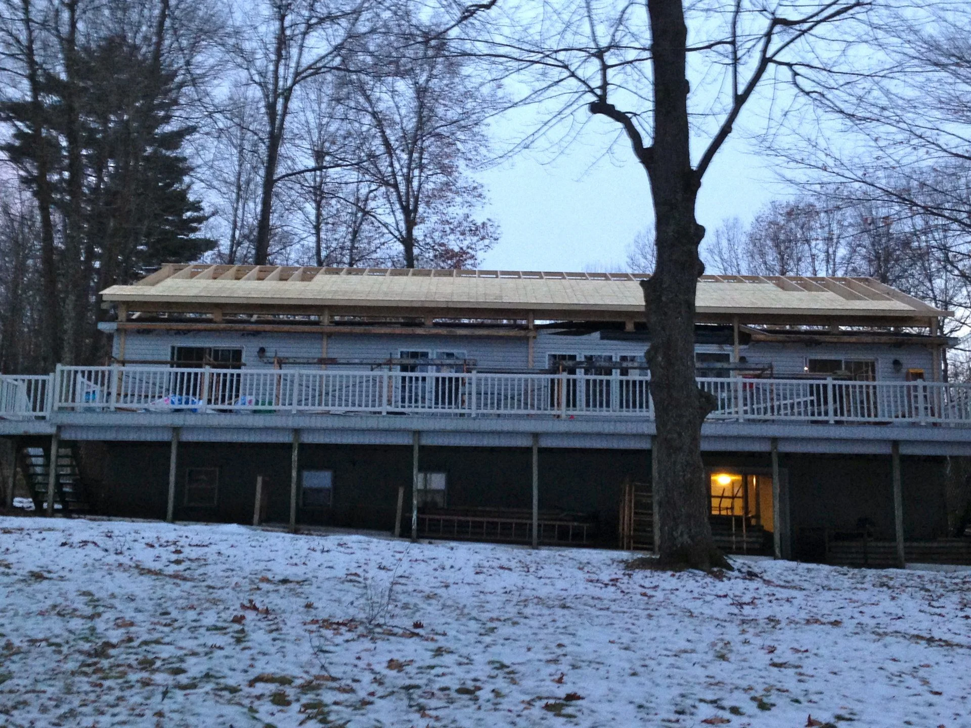

And, we started tearing off the old siding to make room to build the new roof. Our plan, due to it being winter in Michigan, was to build the new roof, enclose it, and tear the old roof out from the inside. Daunting, to say the least...

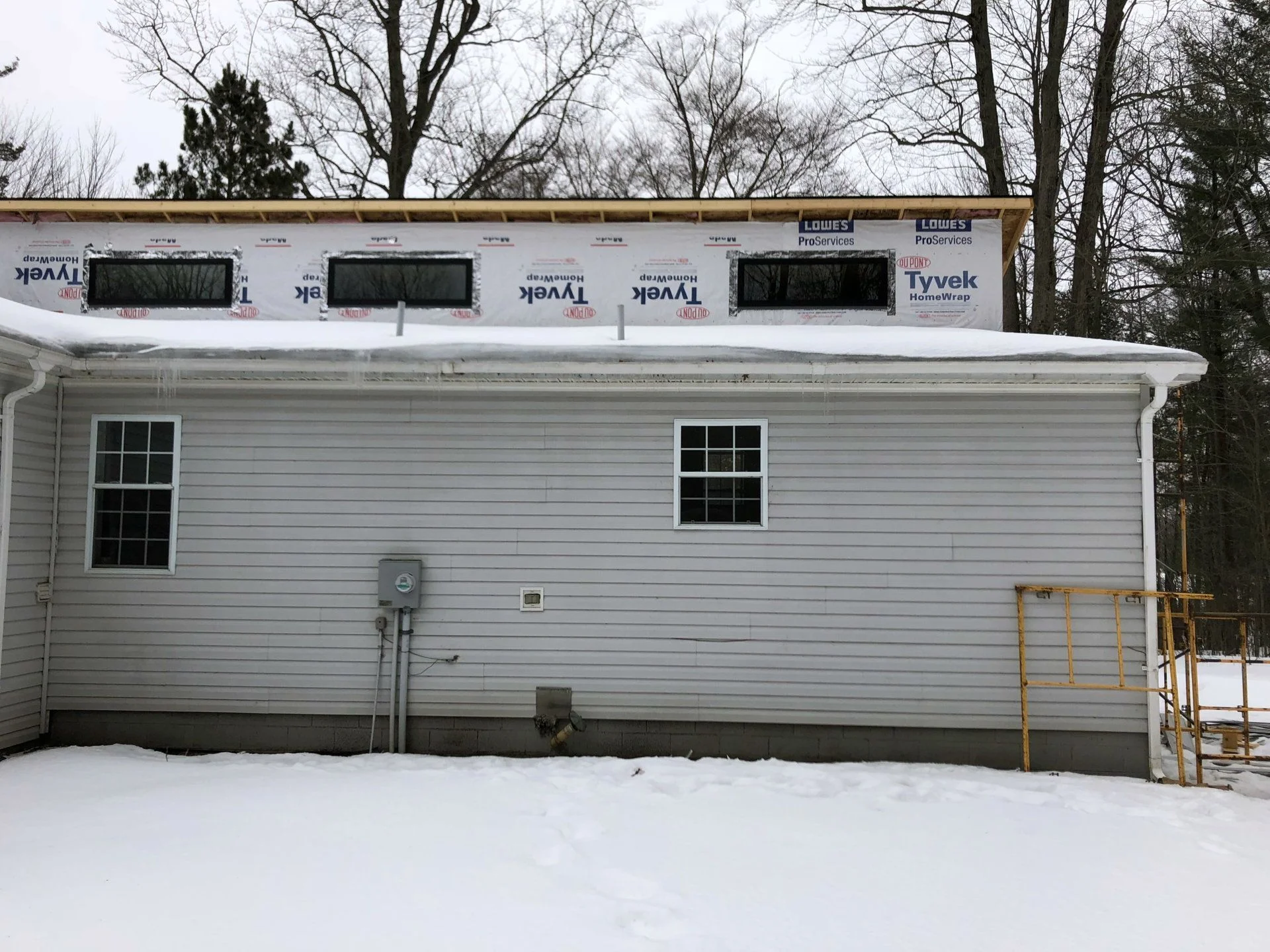

It didn't take too long to have the new roof constructed, and being closing in the sides. We wanted a modern looking roof line, with many windows...

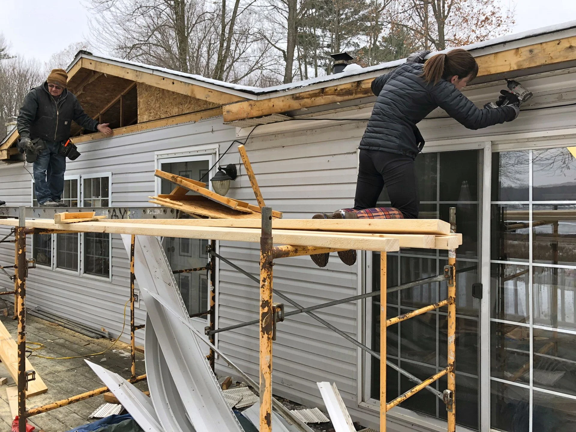

My father-in-law taking a phone call break :)

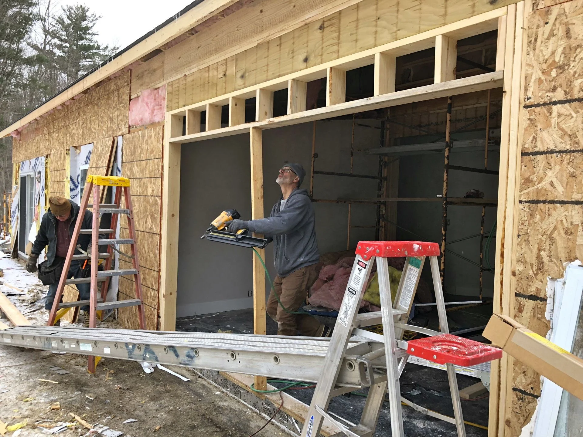

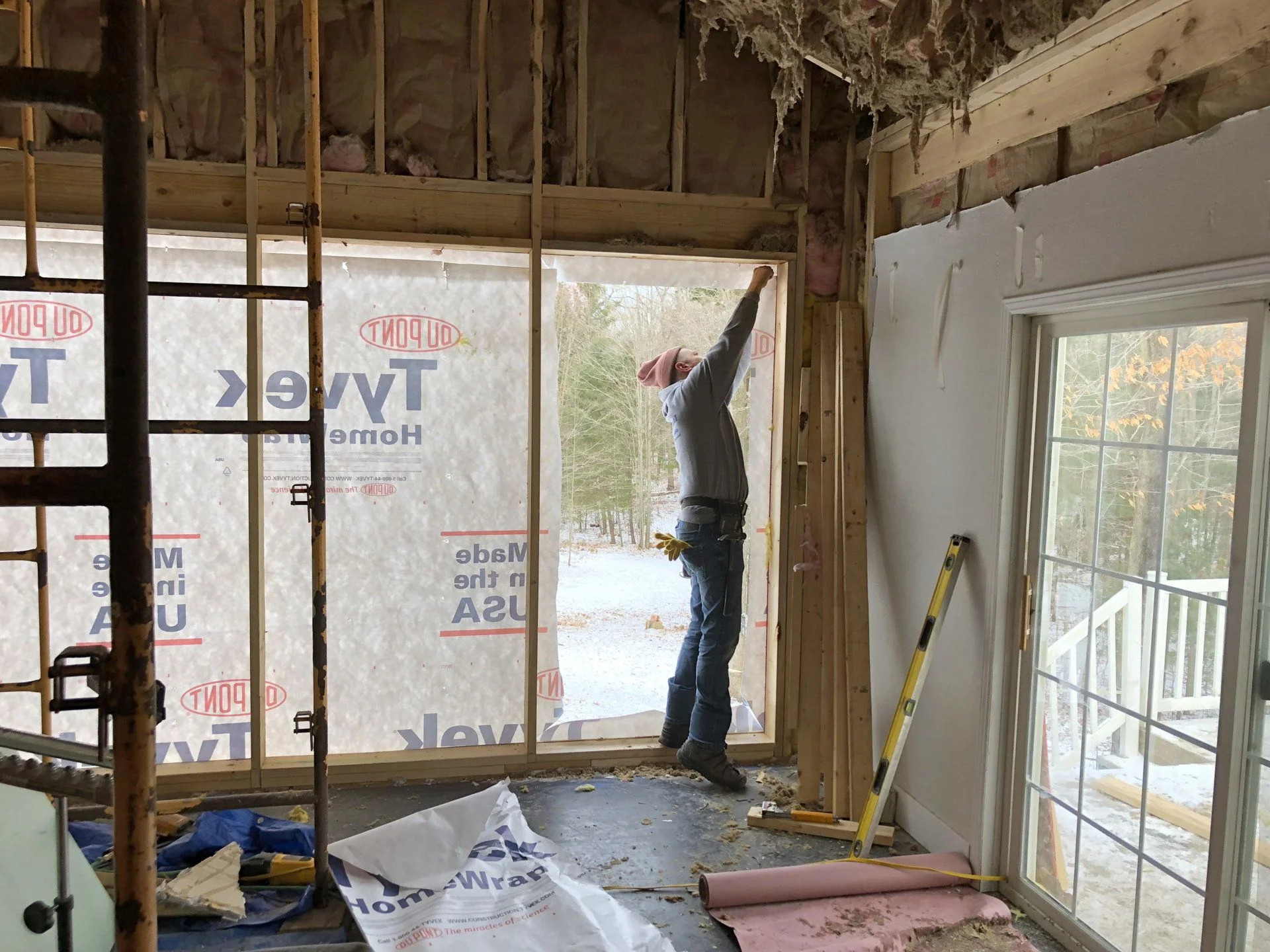

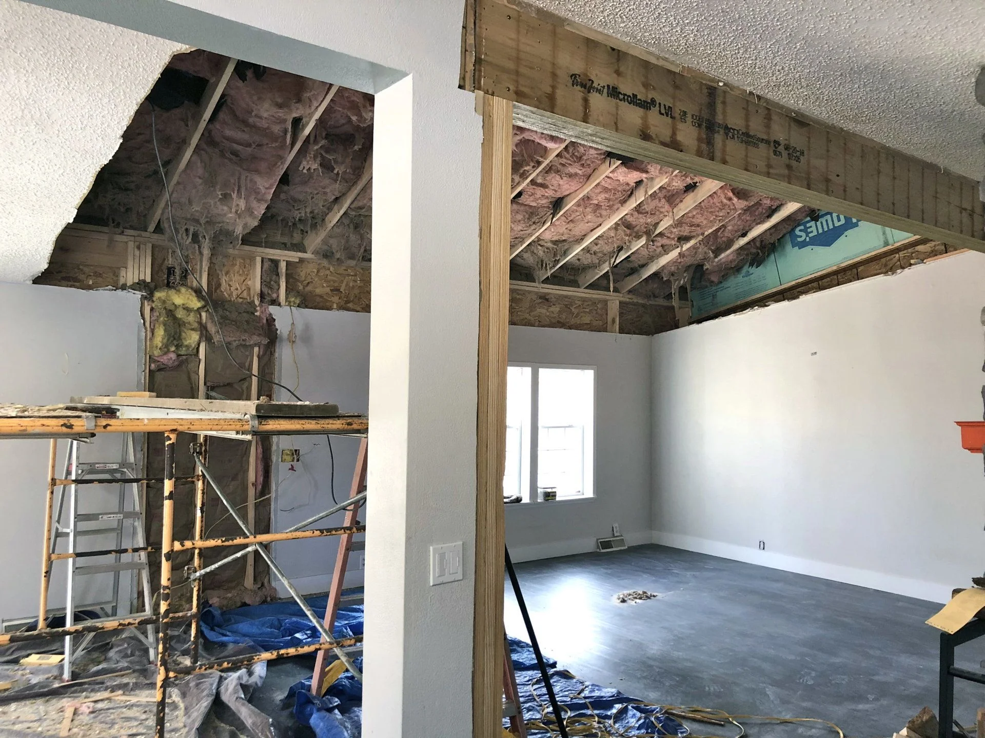

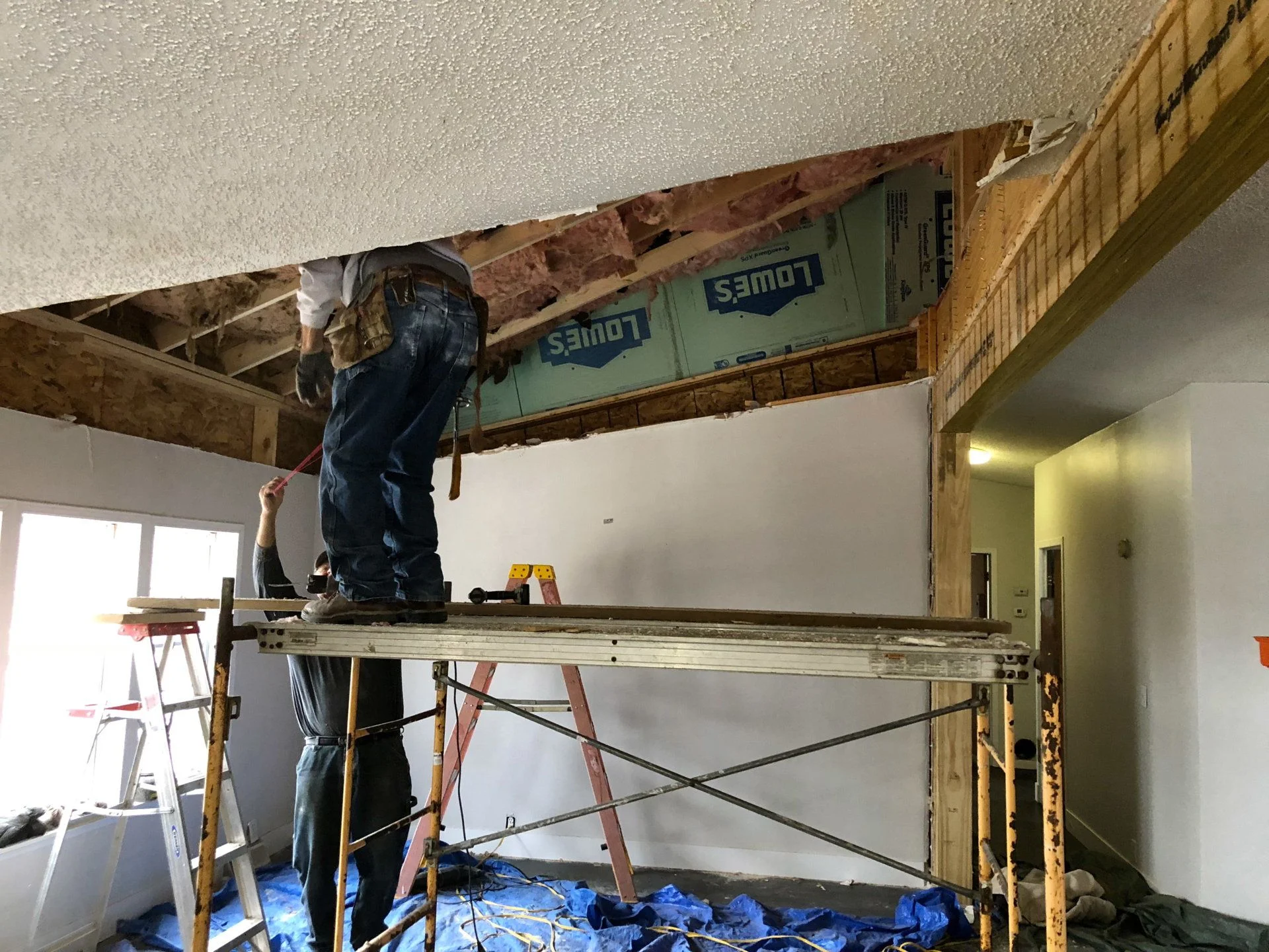

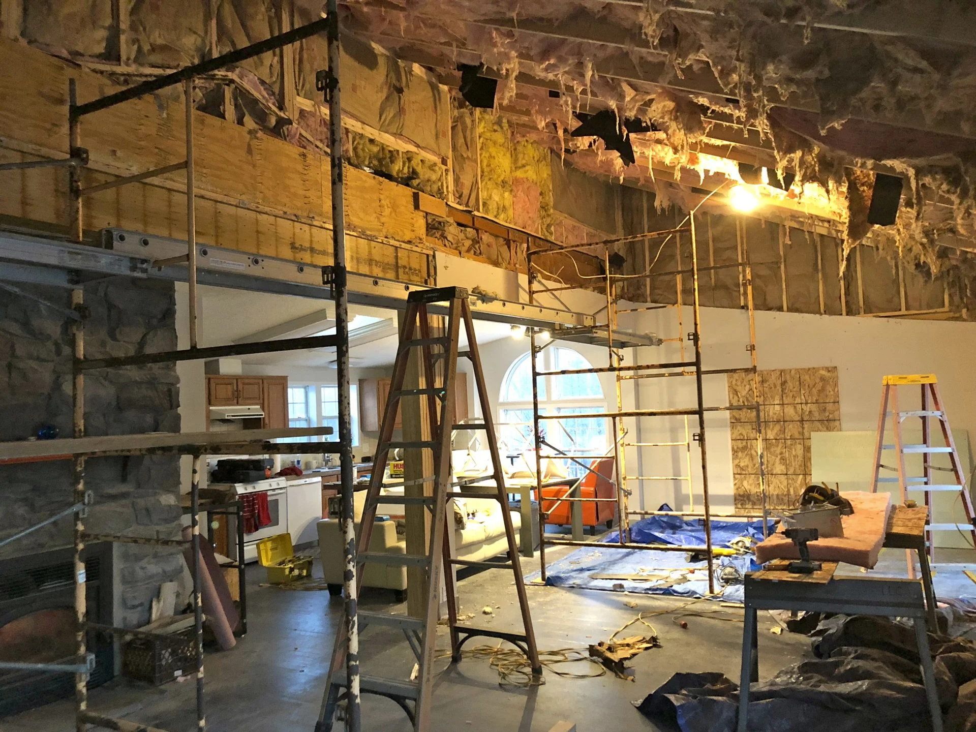

We framed in the windows that we could, while still supporting the old roof. Once that was complete, we started tearing the old roof out, from the inside. We removed all the shingles and sheathing from the outside, to save weight. Then, from the inside, we cut out the old trusses and drywall...little by little. The worst part was getting rid of all the blown in cellulose insulation. That was extremely time consuming, and messy...

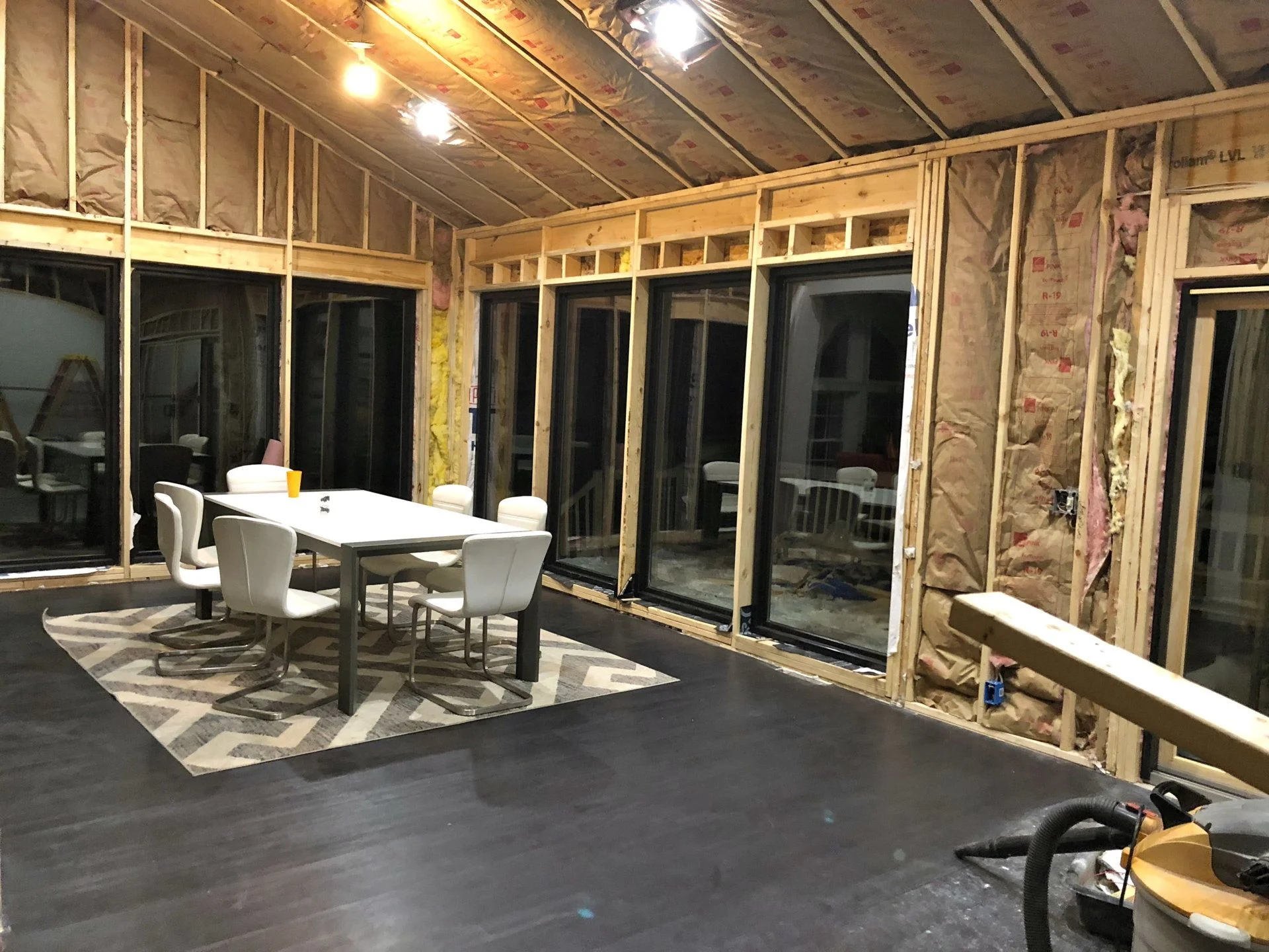

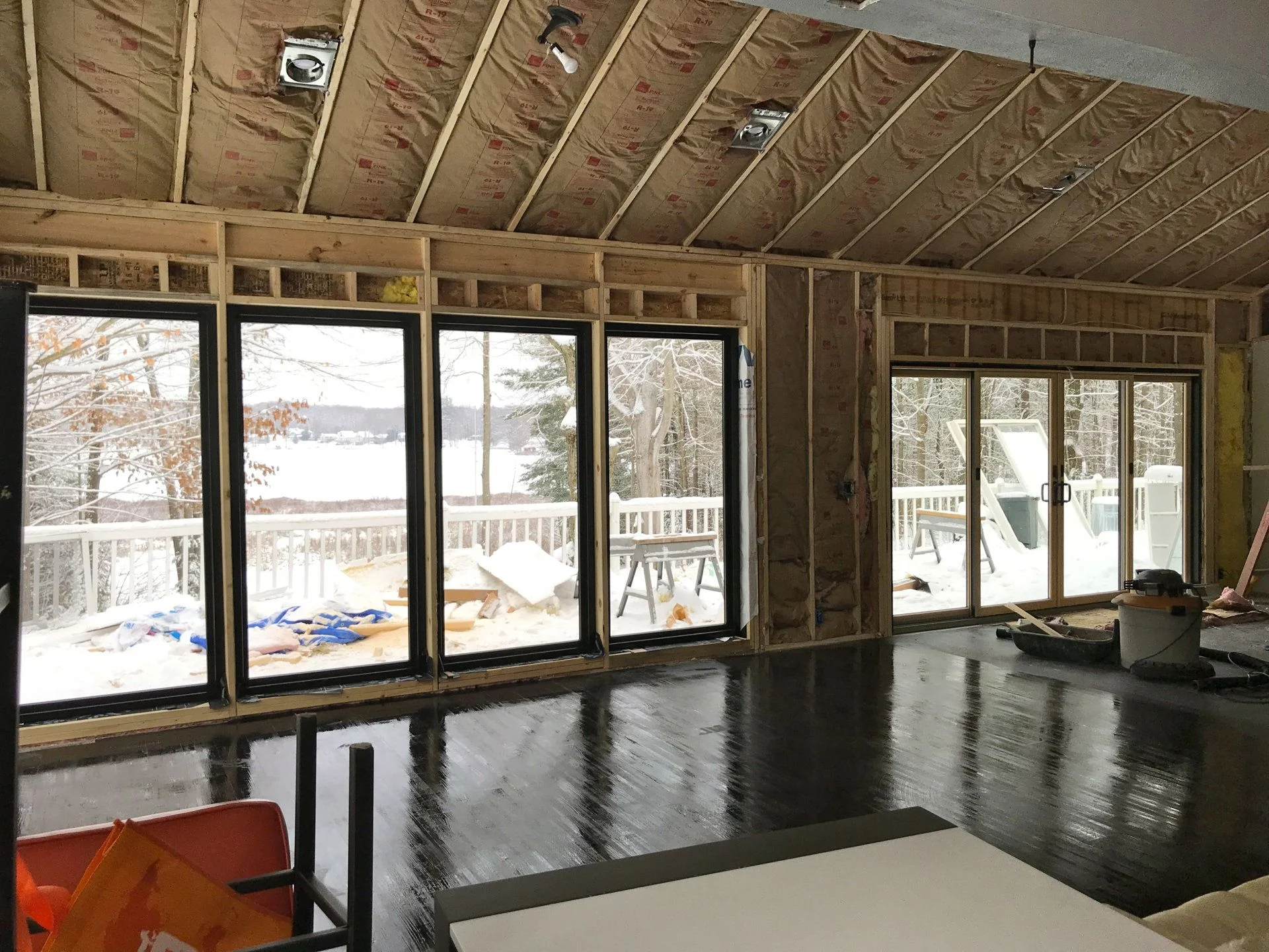

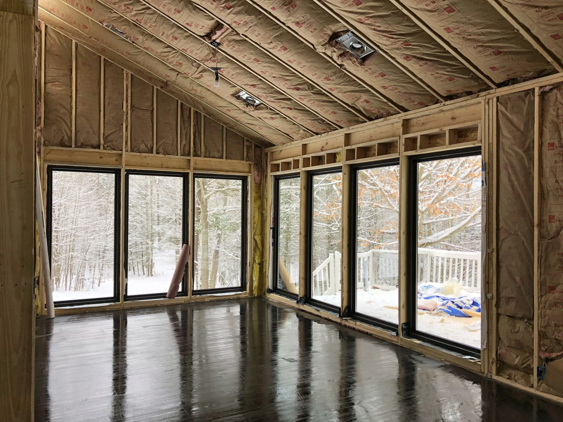

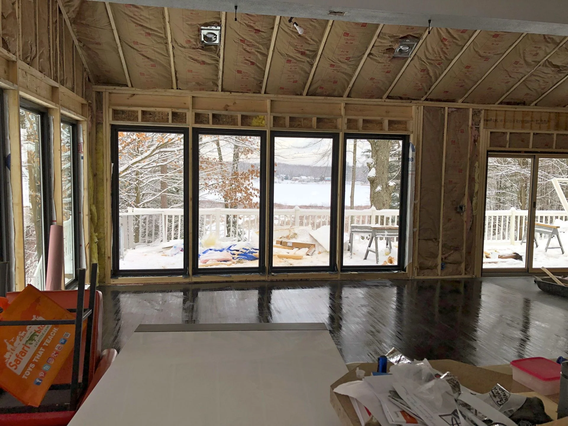

We decided to do this in stages, one room at a time. The first is the largest room, which consists of the living room and dining room, since it's all been opened up by removing interior walls. Once we had the old roof cut out, we were able to finish framing the windows and sliding door.

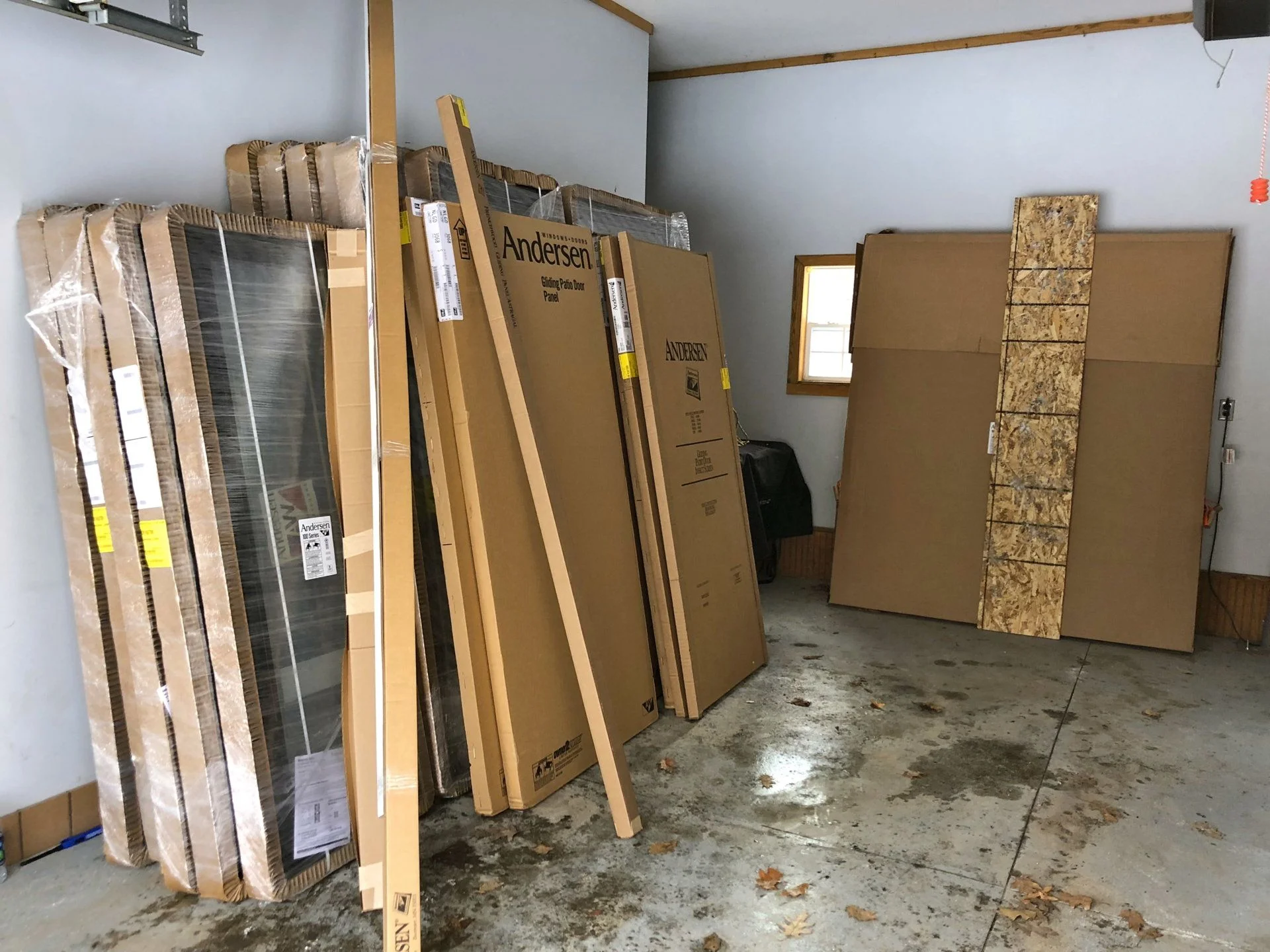

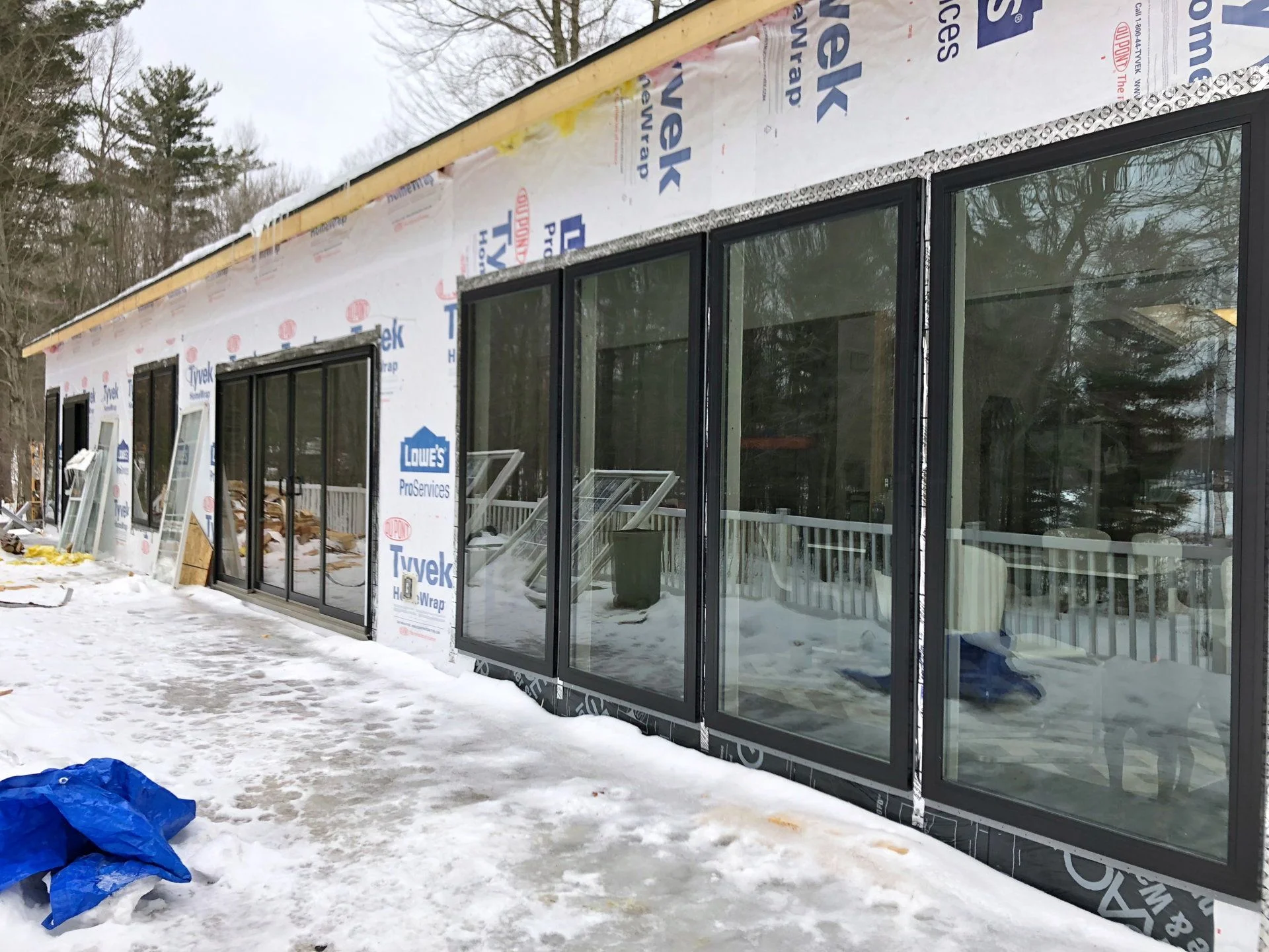

All the new windows and sliders delivered
Framing in the 12 foot slider
Framing in some of the windows
My father in law framing the large slider

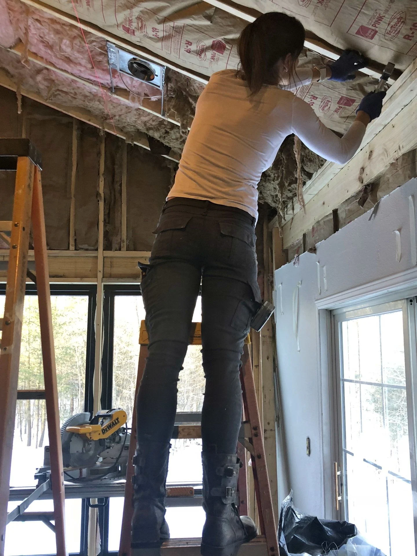

My wife and I have done a ton of work, and she's been a real trooper. The house has obviously been a construction mess, and our family (us and our 2 girls) have been living in the home during this entire process...
My wife helping install insulation

Well done. I don't think I have ever seen a roof on top of a roof and then take the old roof down, and I have a GC father.

She is pretty awesome. She has learned to love Land Cruisers as much as I, and puts up with me. Putting the new roof on first was definitely a new experience and had it's challenges, particularly supporting the old roof while trying to close everything in...but the problem solving was fun.

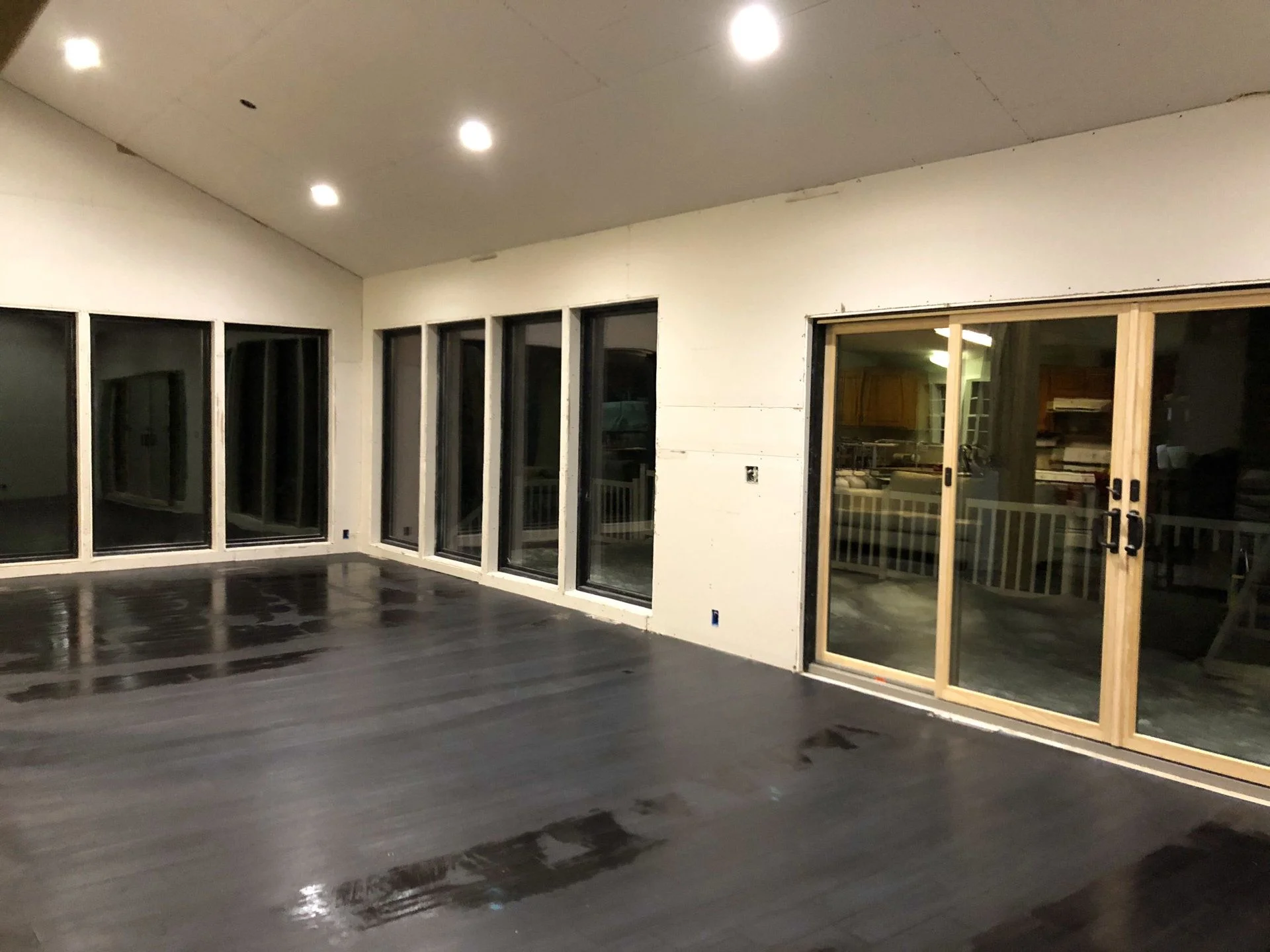

Things are progressing...finally able to get the drywall hung in the living/dining area. The front two bedrooms are completely wired and insulated, just have to tidy up a few things, then will be able to have them hang drywall. All of the windows are in, with the exception of one 6 foot slider. Waiting for a little bit better weather before opening the house up to the elements, again.
