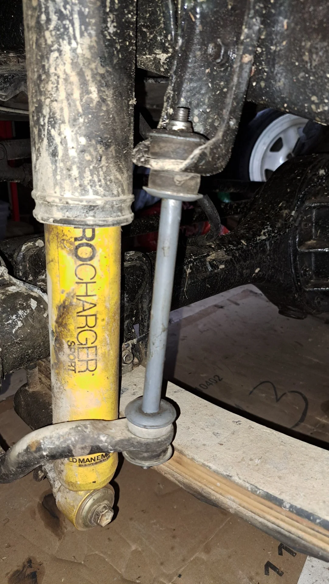

Do you maybe have some pictures?
Sure.
But the diy extended version looks pretty much the same as the factory version, except for the surface corrosion protection (painted, not gold-chromated) and a locking nut on each end (where the factory item has a hex bolt-head on one end).
The length depends on your lift.
Inner rod is 8mm. Outer tube is 10mm inner diameter (the rod must comfortably slide into it); 13mm outer diameter (1.5mm wall thickness), but that doesn't matter much: Any size that sits on the cone washers will do. Thread length 25mm each side. 2x M8 lock nuts.
I'm pretty sure you can also use 5/16" stuff.
Bushings and cone washers from the factory item. Cheers Ralf

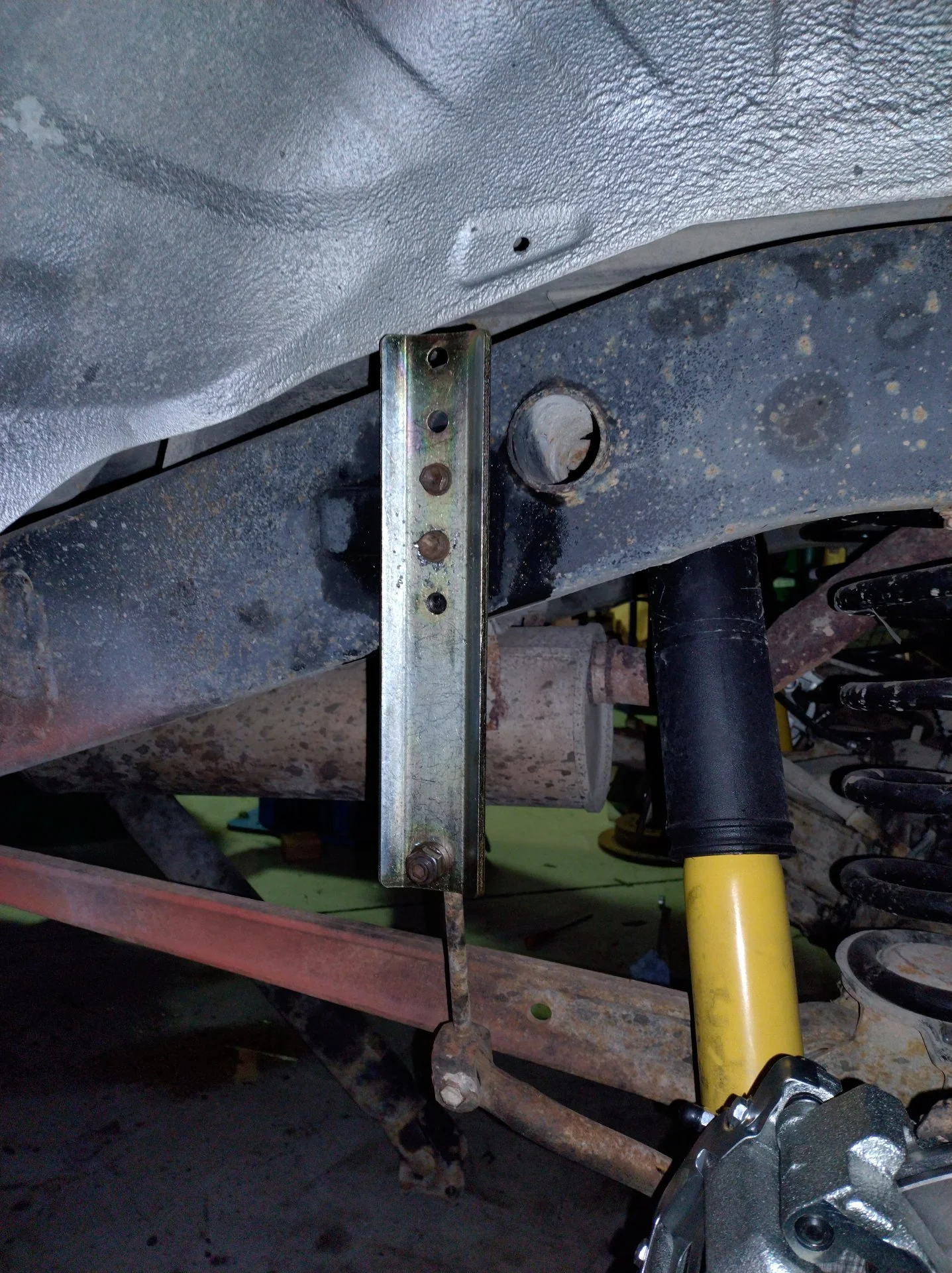

They also have for the rear as well if needed
I have a 2 inch lift on mine and ended up with Dobson extension for both front and rear.
My rear link was resting on the shock - similar to the picture shown in the post above.
Handling is really good with no issues to date.
Note - For the rear extension I needed to drill and tap a new hole.
