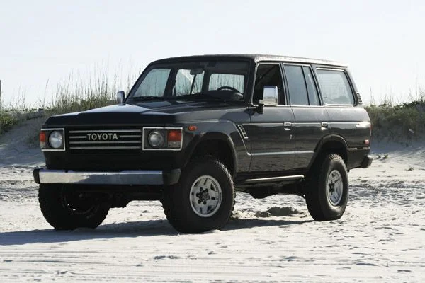

33 x 9.5s BFG A/T's good ride, last forever, proven, good in rocks and dirt, pizza cutters are cool. Got the same color fj62 with the same tires I just mentioned. Tires for 15 rims are cheaper and most larger tires are made for them, if you are planning in the 37" plus tires range then get a 17" rim. Look at prices and tires at all the online tire places and yu will see what I am talking about. Onllinetires.com (I think thats what its called as BFGs for 15s cheap)...If only going to 33's keep the stock rims.
Lowtideride, I love your 4runner rims. I used to have an 88 4runner so that brings back good memories. Your paint is in a lot better condition as well. My 88 62 is peeling.
