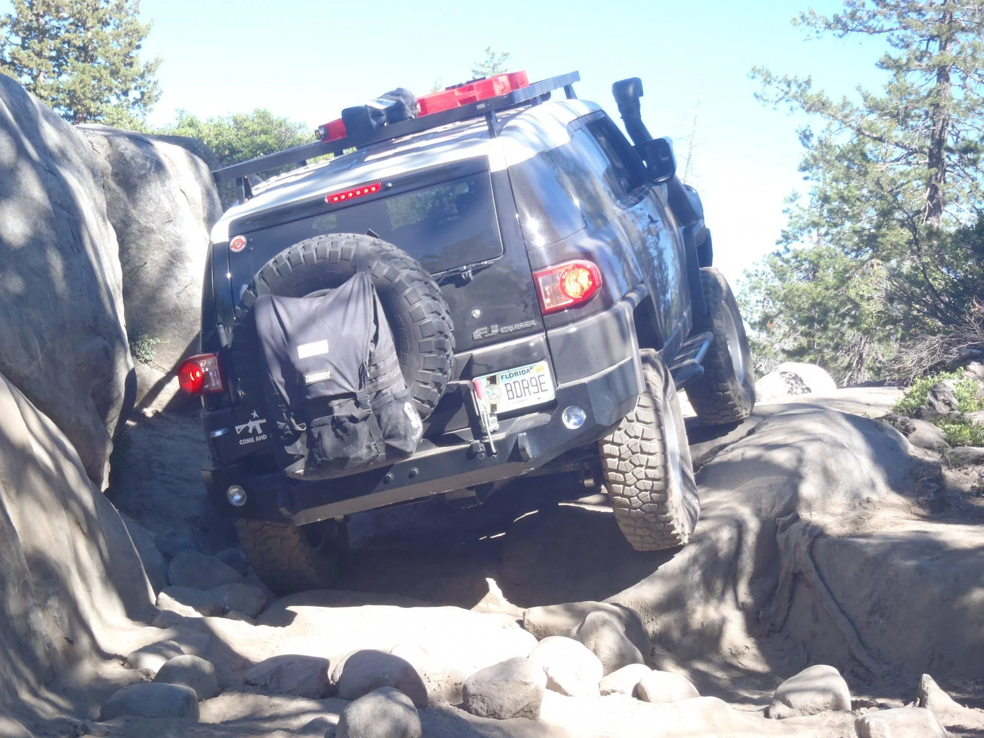

no , not u-bolts. image like a c-channel on the inside of the bumper. that c-channel that was welded to the shell of the bumper went around the rear crossmember, and then past it. Then you put in a metal block in the open part of the c-channel and bolt that block to the c-channel bracket. there were 4 bolts on the bottom, but without another angle to provide rigidity, you could grab onto the bumper wings and move it up and down a bit over and inch. That was with just me and my arms!
a u-bolt could of at least pull the frame in tight to the bumper, their design was like the bumper would just "hug" the crossmember. and since the bolt holes ever elongated to ensure fit, those blocks would just slide more open. It was just junk.
They left the center area open to use the stock hitch, but at the sacrifice of strength. And the tire carrier swing with the rear door was a joke.
This is about the best picture i have with the right lighting. that whole center portion of the bumper was open, i welded in the open area, then built a mounting surface to put those two bolts you see in the middle to the frame. Then built a 6 more mounts on the inside. Then when the tire carrier was open, 3 of us could hang on the carrier and it only moved 1mm.
