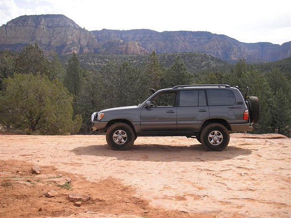

This puzzles me. Mine rakes only the normal amount....like every other "normal" lifted 80 or 100. ???
Words like scary and unbalanced...I don't feel this on mine. We have very similar trucks. ???

Got a side shot of yours?

Damn ! Its the return of the 863-864 confusion again !! :mad:
I am running friggin 864`s on mine ( I will correct my earlier post.. sorry guys ! )
The 864`s ride WAY high on the 100, thats why I have the excessive rake.
I will take a side-view pic to show what I am talking about.
I am sure that the "uneasy" feeling in mine is due to the height and rate of the 864`s...They just ride funky man ! ;p

Ahh! OK. Yer ass is way up I'd guess. :D
Ya, I'd luv to see a pic of that. :)
