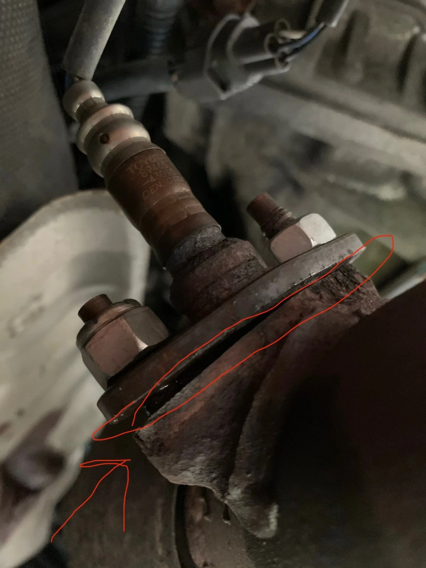

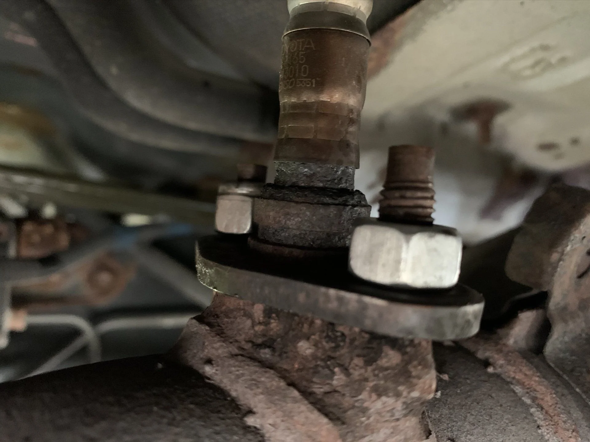

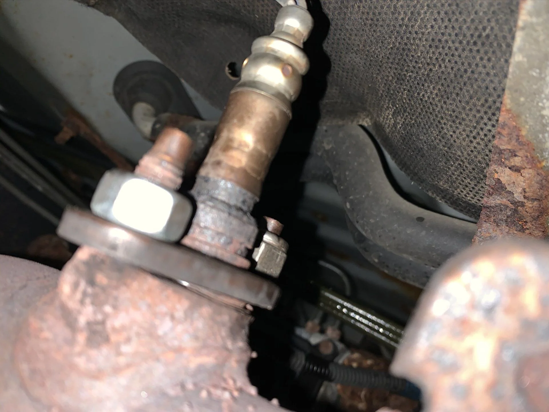

Gents,
Does anyone know the size bolt i need to keep the sensor in place. The bolts in the photo are not the correct ones.
Also, am i missing a gasket between the two pieces?
Thanks you in advance.
You have 'studs' on the exhaust flange which is typical of Toyota's O2 sensor mounting process. (stud with nut). M8x 1.25 usually, and yes, it looks as if you are missing the gasket.
Remove the two nuts. Pull out the o2 sensor, Place the gasket down on the two studs on the exhaust, then reinstall the sensor onto the exhaust on top of the gasket.
