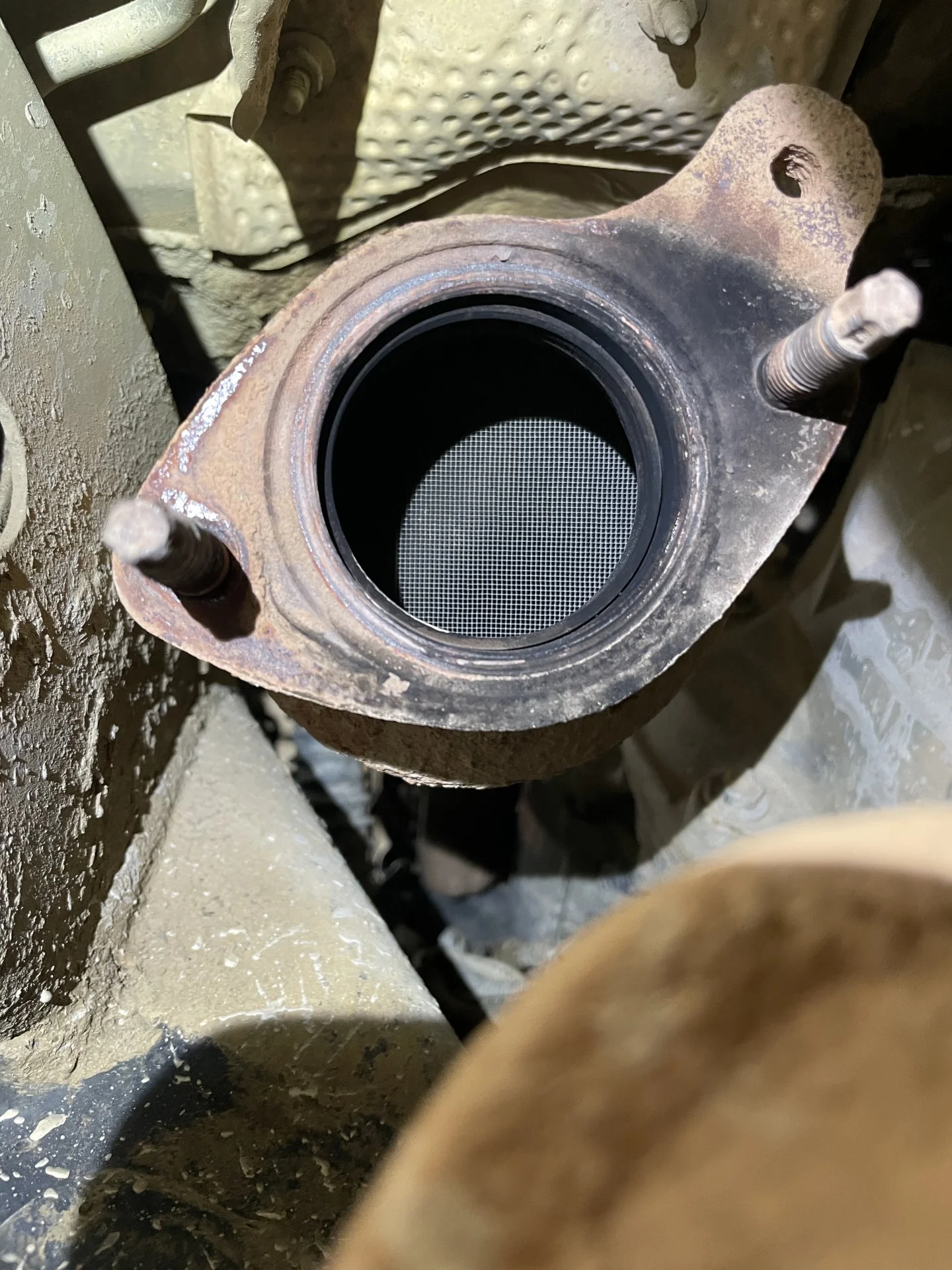

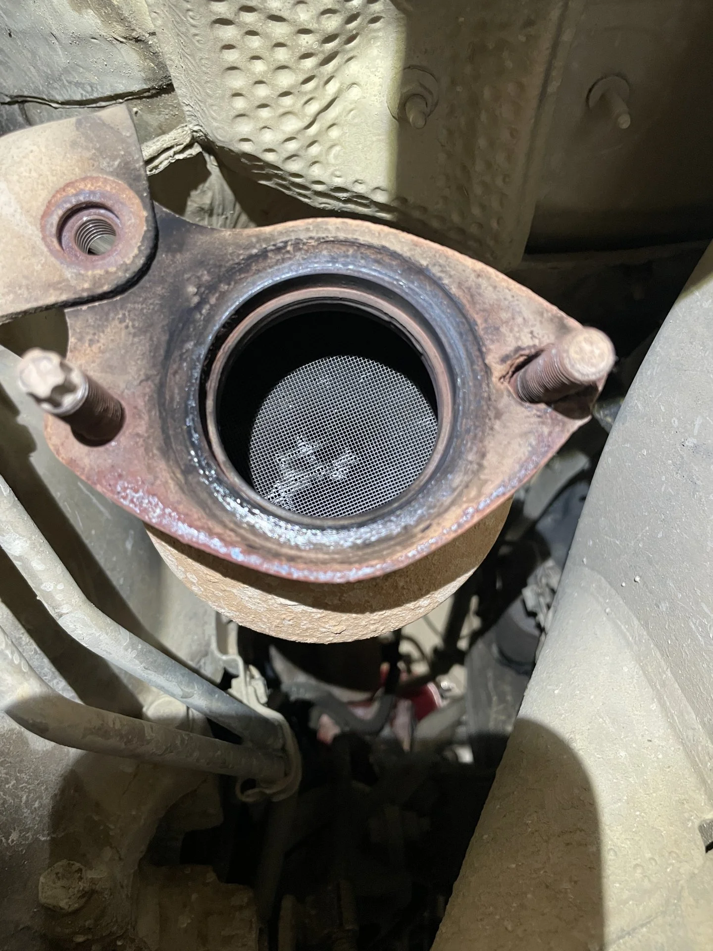

I was really expecting my primary cats to look a lot worse and a bunch of crap fall out of them. The passenger side did have a small blockage.
Driver side

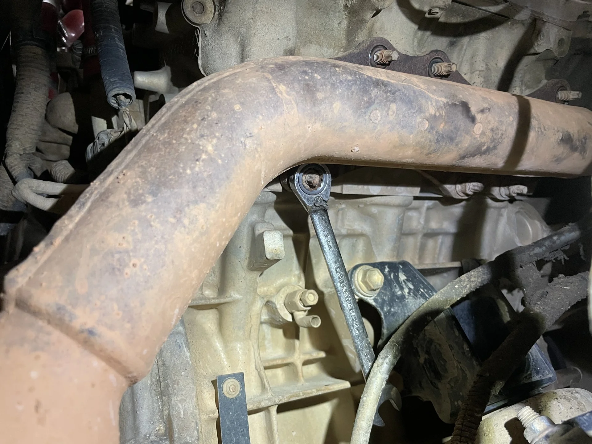

Once cracked with a 12mm deep socket and longer drive handle, I got in there with a ratchet-wrench. That upstream O2 sensor harness (upper left behind down pipe) gave me more headache than any of the bolts did. I ended up using a very small screwdriver to wedge the cantilevered lock open and then gave it a good tug.

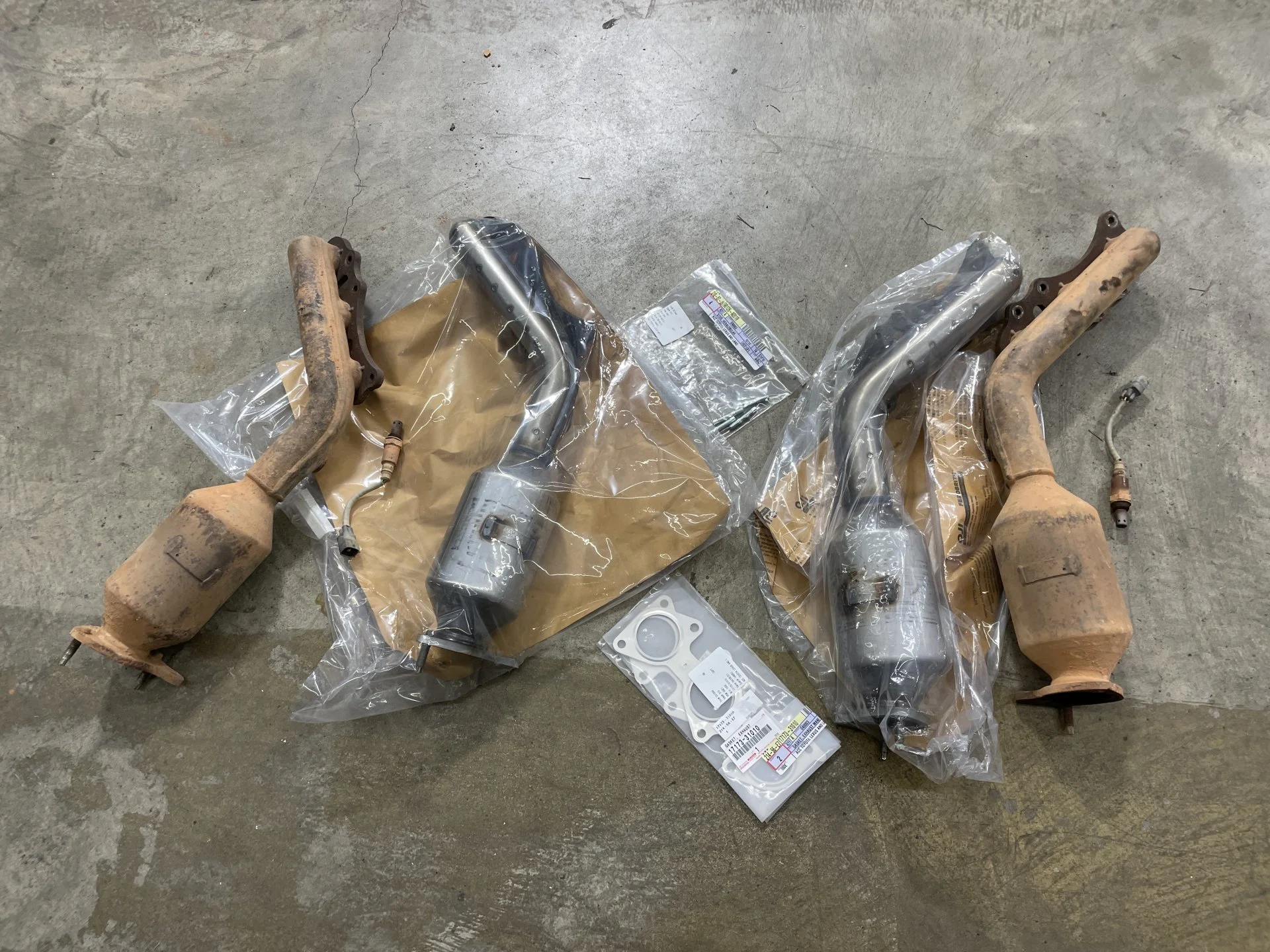

New manifolds, gaskets and a few replacement studs just in case.
Didn't need the studs. I also reused my primary O2 sensors. I wanted to see if in fact these really needed to be replaced.

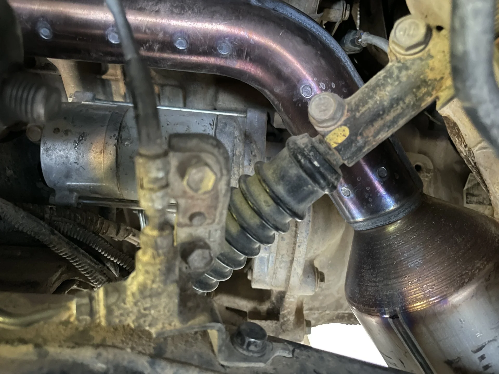

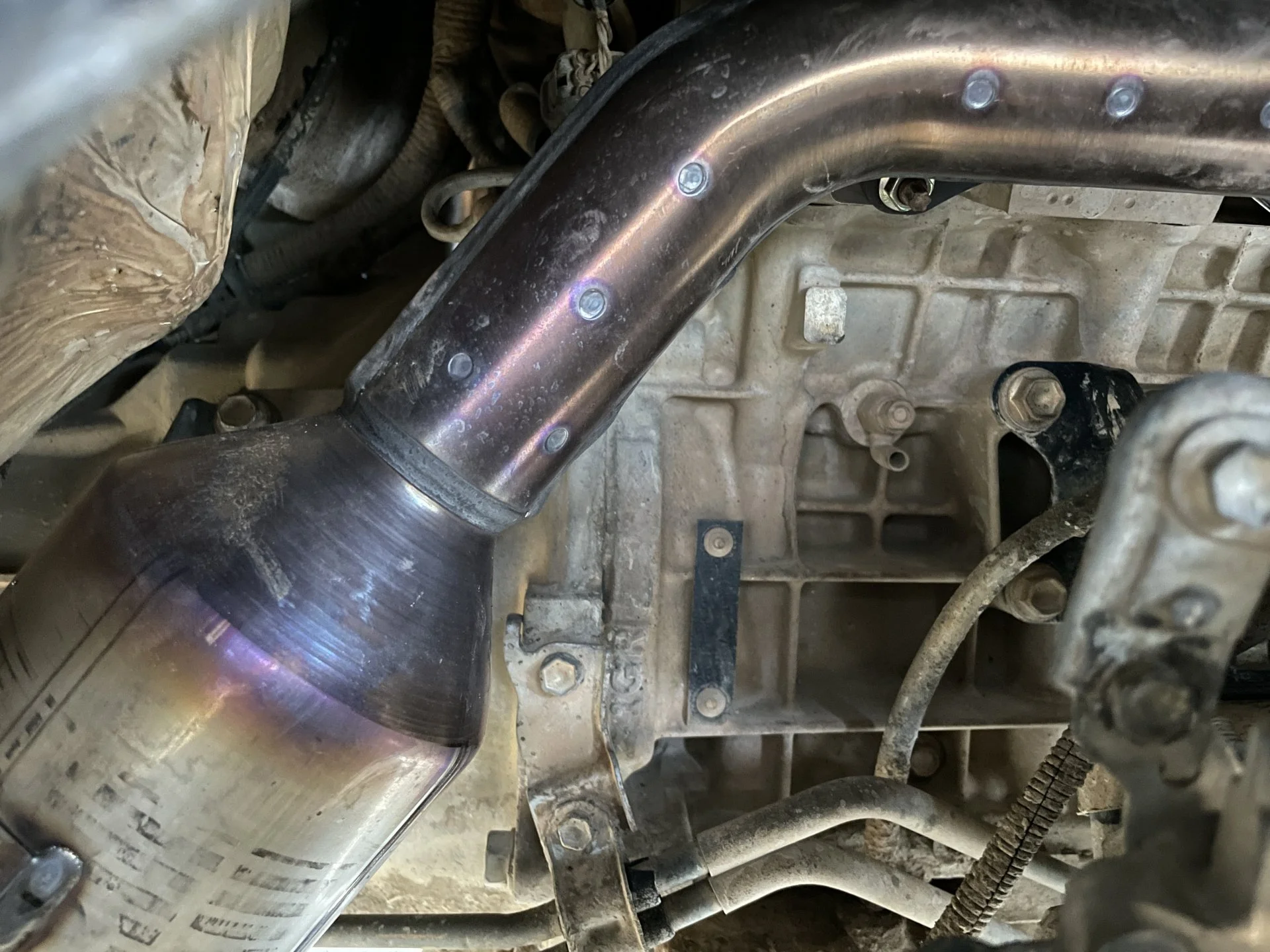

After the job completion and a few highway miles, they blued in real nicely ;)
I am way overdue for a cat-back replacement of most of the exhaust system. My muffler looks like a cheese grater and spins on axis. After I installed the driver side manifold and got everything torqued down, the secondary cat now rests on the trans crossmember and rattles. All to be addressed soon. . .
