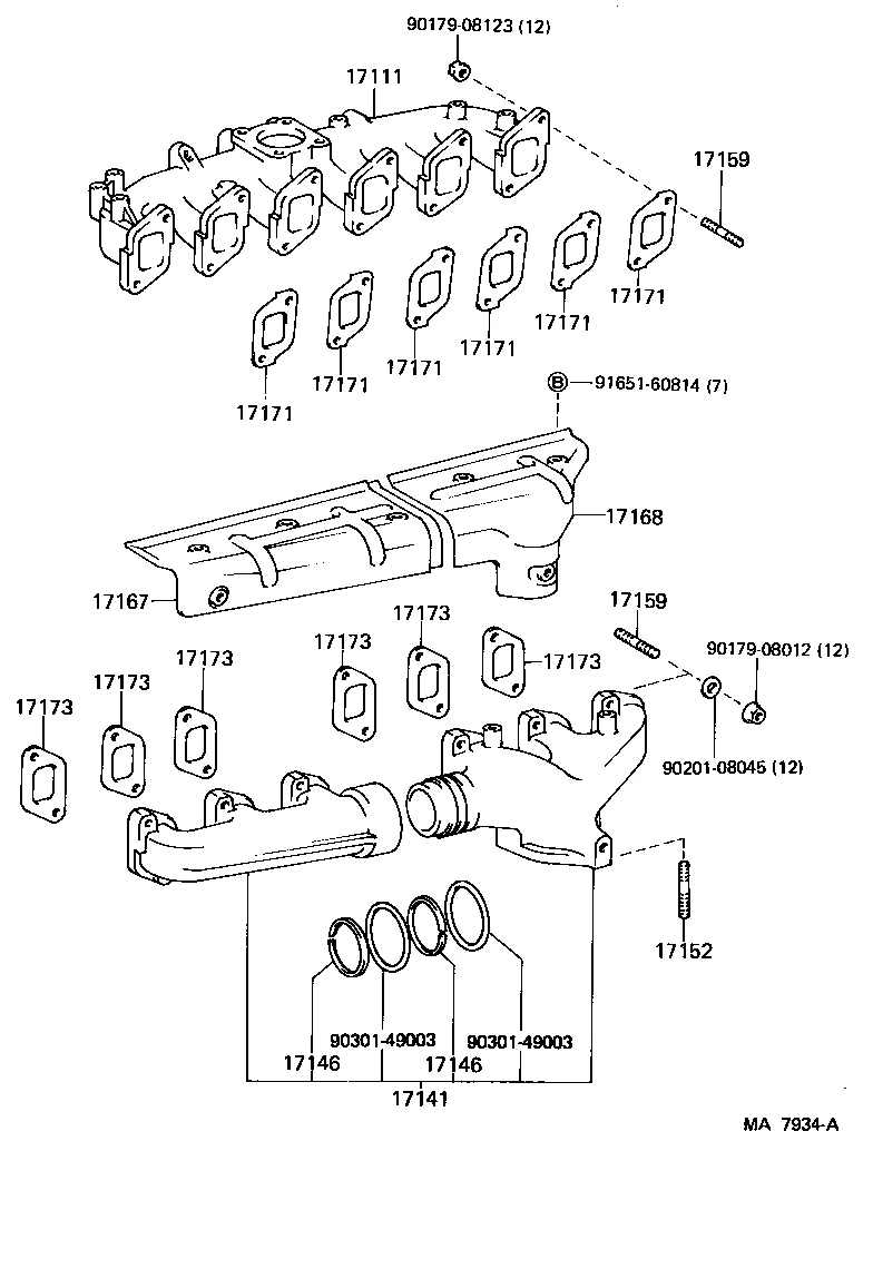

I am gearing up to change out my exhaust manifold gaskets because I have a leak at one or two of them, but before I jump into this job I want to make sure I have all of the parts I need. Do I need a flange gasket for the down pipe and o-rings and lock washers for the two halves of the manifold as well as the 6 manifold gaskets? It does not appear to be leaking in those two spots, but I am concerned I will need to take those apart to get the manifold off.
After taking a look at how it all comes apart, it would appear that I will also need to take it apart at the flange that connects to the down pipe, correct? Or maybe I can just remove the nuts where the manifold connects to the head and lean it out of the way (as long as I release the clamp where the down pipe is connected to the bell housing further down)?
Anyway, I could use some input from somebody that has done this ob before. I've done this on other vehicles, just not an HJ60. I have the all of the FSMs for my cruiser but there was not adequate info to guide me in whether I need more gaskets than just the 6 manifold gaskets.
Let me know what you guys think.
Each exhaust and intake port gasket should be replaced (17171 and 17173) and ideally the down pipe gasket assembly (exhaust manifold gasket 17141) should be too. If one gasket could be reused, it might be 17141 but don't count on it.

I think I found it:
17410B is the correct part number for the exhaust pipe to manifold flange.
17410B would be a drawing number (PNC) not the part number.
Toyota part numbers typically are ten digits with a dash after the first five digits.
Example: 90301-49003
