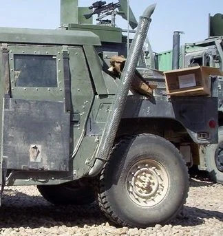

I like the idea, and if I was 'going all out' on my truck I would do it HMMWV style. I would wrap it in tough steel mesh like a HMMWV and secure it to the cab with a bracket at the top:
