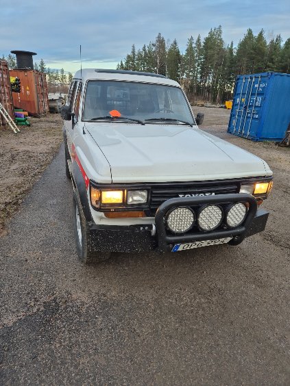

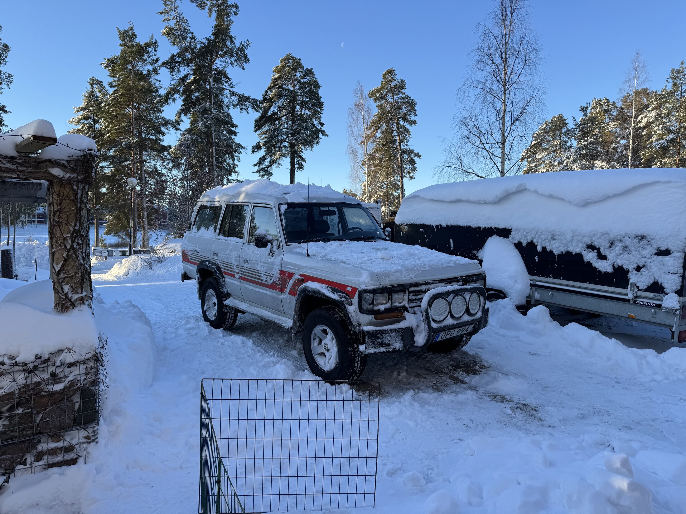

Brit here working in the Nordics, just picked up a HJ60 high roof five speed whilst browsing the local ads..she has 220,000 kilometres (160,000 miles approx) and was renovated in 2017, thought I’d share on here..
I know she looks like a HJ62 with the twin headlights, but apparently they never used that naming feature in Europe, and it’s VIN PLATE reads HJ60 LG-MNGZW
I need a turbo kit for a LHD, anybody got any links ?
