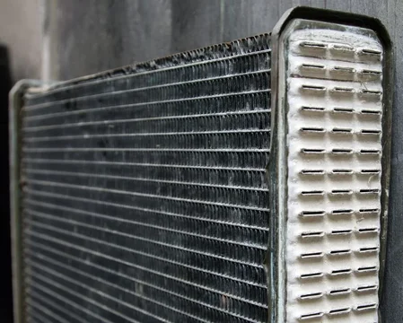

. I will call Ron Davis in the morning but another thing I have been thinking about is having the entire radiator anodized black to help with corrosion and with heat soak. I will let them tell me if that's a good idea or not. I guess I'll order a new radiator overflow tank and radiator cap while I'm at it. Bummer. Oh well.

Just got off the phone with Dennis from Ron Davis. They do not have the radiator in stock but with their current work load they are looking at 2-3 weeks. According to them, and the rest here on mud, the radiator is 100% bolt in with all the needed ports for the TB and the trans cooler lines. The stock radiator is a single row of 1.25" tubing. The Ron David radiator is two rows of 1" tubing. They did recommend having ONLY the outside of the radiator anodized to eliminate galvanization. He said most of their hot rodders do exactly that so I think I will be following suit. He also was interested in making up a replacement coolant overflow tank so I'm considering that now :grinpimp:
Total cost for the radiator is $950. I can get anodizing for free. The overflow tank will be a couple hundred I'm sure. We'll see.
Why go aluminum?
The stock radiator is a high efficiency 3-row w/<3/8" tube spacing and 14 fins/inch. Unless the physical size is changed cooling will not improve with AL. Bolt-in a copper Koyo and be done with it.
