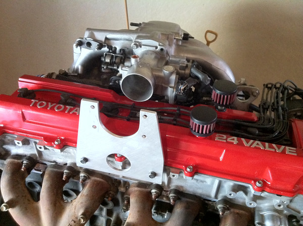

so true, but only toyota racing red... :grinpimp:
THAT is what I am talking about! :cheers::cheers::cheers:
