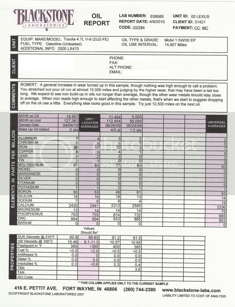

Toyota's engineers have a completely different motivation than Toyota vehicle owners. Just sayin'... We should be looking for that balance between no negative impact to reliability/longevity, and cost. Remember, Blackstone is in business to get you to keep sending your samples back and back and back and back and back for more analysis, too. They are the chiropractors of UOA. Recommended service intervals are clearly skewed to one end of that scale to protect the manufacturer against liability and you against premature failure, with minimal regard to cost (what the market will bear). Not advocating throwing the maintenance schedule out the window, but it bears an objective look anyway. I think people on this forum have a grossly misconstrued view of how typical people in the US and around the world maintain their vehicles, and very little sense of cost v failure/wear probabilities. But whatever, :meh:, it's your car, maintain it however you want.
The drivel in the "comments" section is useless, unsubstantiated, and in some cases flat out wrong. If there was "nothing high enough to call a problem" then why do they recommend lowering your interval? Are your Al, Fe, Cu, and Sn levels high because you're experiencing wear, or simply because your oil interval was longer than the average from which the "should be" numbers are based on? "tad too long" based on what? What's the correlation to when "iron starts affecting the other metals"? Do you really believe that each engine's design and component composition is similar enough to have these generic guidelines? Blackstone analysis is good for some things, but the commentary is strictly an up-sell opportunity, and not based on any engineering or science. <- MHO, anyway...

The only thing I'd add to ^^^ is that the elemental analysis in the UOA report gives a lot of people either a false sense of security and/or urgency, since it never answers the question of "so what?" about the levels. it's great for coolant, water, fuel and viscosity changes, but honestly, you can double your oil change cost with a UOA for little tangible information in terms of increasing engine life.
