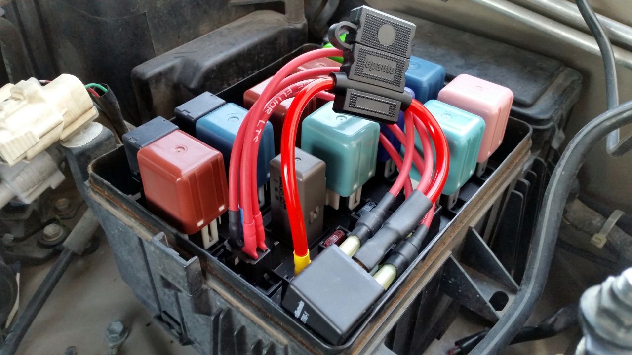

Here's what I did. followed the thread and it hasn't failed in a couple of years.
I’ve implemented the temporary direct wire fix and will do the relay/jumper fix when I have the parts. See post #340 here for pics of how I wired it, I used an inline ATM 20A fuse.
