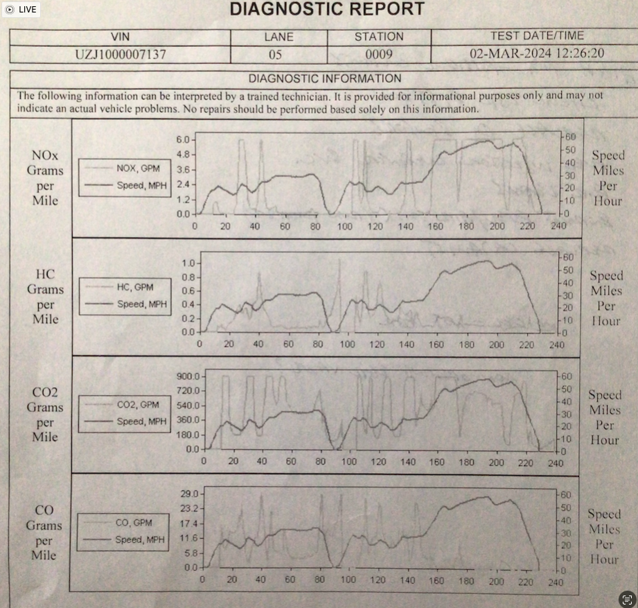

Thanks for these replies. This weekend I'll clean the MAF and replace the air filter; hadn't checked those yet. I'm also thinking EGR based on the wave values from the emissions report. I've included that image below.
From a video I watched last evening, the high NOx readings under acceleration at at "cruising speed" may indicate that the EGR is not opening. For you guys with more experience than me, does this data suggest anything further to you?
(Also note crazy low VIN!)
The EGR is designed to lower NOX readings. A bad vacuum modulator or EGR valve can cause high NOX. Urban Car Care on East Evans has gotten my NOX readings down low enough on our 80 series to pass the test. I've found no direct connection between octane levels or ethanol/non-ethanol fuels and lower NOX. When I looked at my graphs it looked to me as though NOX was highest just after upshifting. So, I've turned off overdrive and set the transmission on 'Power'. to raise the rpm's when shifting and theoretically lower NOX on the upshift. I'm also of the opinion that how the vehicle is driven on the dyne can have an effect on emission levels. I've taken two tests within 20 miniutes of each other (gas cap was bad) and the results were way different even though nothing had been done to the vehicle in the meantime.

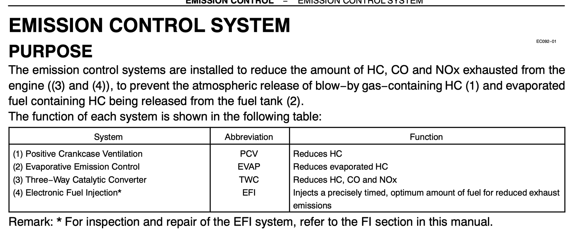

Following up with what feels like a dumb question, but Google searches and review of the FSM and I don't see the EGR referenced for the 100 series. Surely there IS one, and I suspect I can find it lurking near the throttle body. But if anyone has a step-by-step on the 100 series EGR, I'd be grateful for the link. All the links I'm finding reference the 80 series, even when I add "100 series", "1998," and "2UZ-FE" in my search string.
I was gonna say, I don't think there is an EGR. At least I know there is not EGR on the VVTI engine but unsure on the earlier engines.
This would explain my lack of any hits. Thanks

I don't have CEL neither. My graph is very similar compared to the one @imhighlander shared:
It shows spikes around 30, 45, 140 and 160 in the X axis (guessing seconds?), and after doing google research it seems to relate to the EGR system.... But I mostly find people with 80 series talking about this issue.
