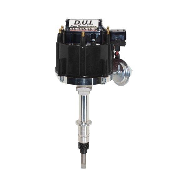

I had never heard of Max HEI, but I installed a DUI, from performancedistributors.com.
I’d like to mention a few thoughts:
1. $129 for Max HEI and $349 for DUI is a significant difference and is concerning, from a quality/quality control perspective.
2. When DUI first became available for FJ40s, Davis Unified Ignition used a gear for the Chevy straight six. They overlooked the fact that the Toyota I6 requires a slightly different gear. They learned of their oversight when customers started telling them that their DUI had destroyed their engine... and demanding Davis pay for repairs. I don’t know the outcome of recovering damages, only that Davis corrected their error... I learned this thru MUD research and made sure what I bought was the correct gear. Here’s DUI’s black cap:
3. I looked at Maxx HEI and see four 88641 part numbers... the only difference I can see is cap color: B(lue), C(Lear), (blac)K and R(ed).
4. I agree that you appear to have an installation error and that the installer should make you whole. But, it might behoove you to compare the HEI gear to the old OEM dissy gear... just so you are certain it’s not a Maxx HEI error instead... e.g. perhaps they mislabeled your HEI... or, mounted the wrong gear.
Good luck regardless!!
BTW My DUI install did not require use of a spacer.
