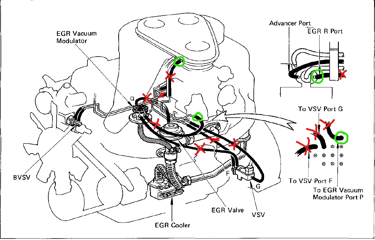

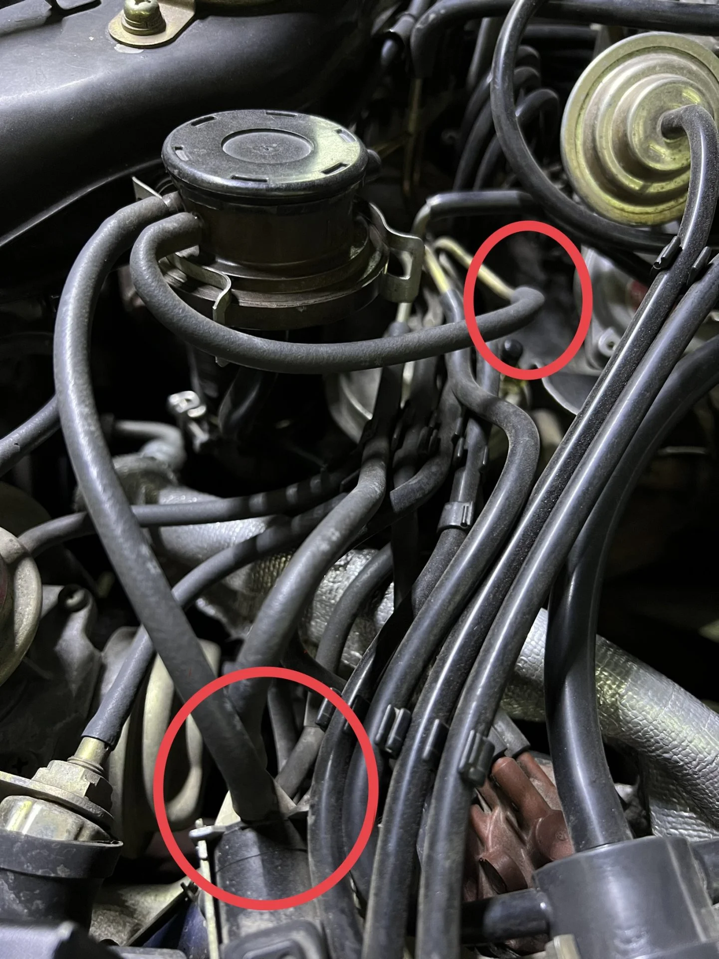

I have a 1987 fj60. I am replacing the intake/exhaust gaskets. While there I want to remove the all ready not functioning EGR. I HAVE THE “J” pipe block off and the large block off for the pipe directly under the carb. All new gaskets for all those pieces. When removing the EGR cooler do I need to plug anything there? When removing the EGR modulator the vacuum hoses from it do I just cap? (See picture). Will I have any different drivability issues after removing a non working EGR other then I am now?

As far as I know, the only vacuum line that needs to be capped is the EGR port on the passenger-side of the carburetor, as that should be the supply vacuum for the EGR. All the others are blocked off with plates and gaskets. I don't remember if the modulator or EGR uses the 3-prong "Gas Filter" that threads into the intake or not. If it does, I would cap that as well. The lines that were then removed from the mess of vacuum spaghetti can then remain open, as it shouldn't have any vacuum supplied to it from the above.

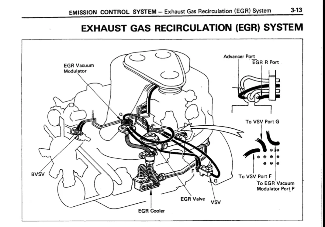

Here’s sn overview drawing of both systems. You should have a copy of the emissions manual

@OSS is giving you the 60 Series bible. Read it cover to cover several times and everything will make more sense. The engine ancillaries are much easier to think about when you can break them apart into their individual systems: EGR, AI, HAI, HIC, HAC, PCV, SC, etc, etc.
