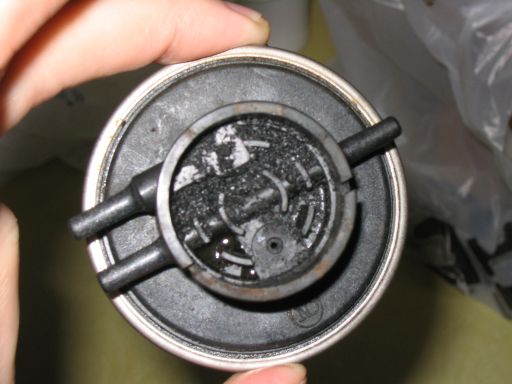

My LX started throwing the 401 code a couple weeks back every 20-25 miles or so. Clearing the code was starting to irritate me so I took the plunge today and started checking all the EGR components. The EGR valve, modulator, temp sensor and all hoses were fine. The port behind the throttle body where the exhaust gases flow was completely plugged w/ black soot. Cleaned it up, slapped everything back together including a new gas pedal cable and went on a 30 mile test drive. Woo hoo, no more check engine light.:bounce::D

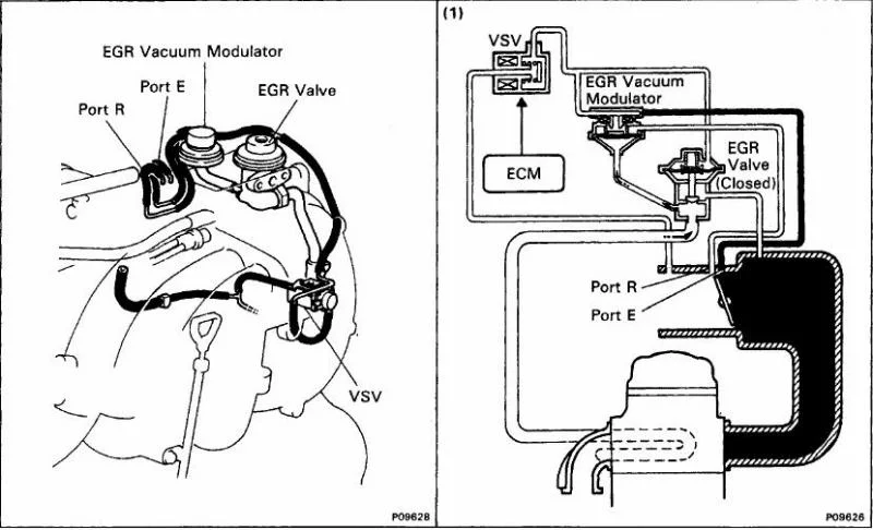

I have updated added some pics to the first post is this thread and here too of the EGR system.
Top left VSV. Top Right carbon in the Modulator. My thought is when carbon get in the Modulator it also passes into the rest of the EGR system and plugs up the VSV and or hoses. When a chunk of carbon plugs up the VSV it causes a problem but the carbon might pass (like a kidney stone) making it hard to diagnose the problem.
Bottom is carbon buildup.
