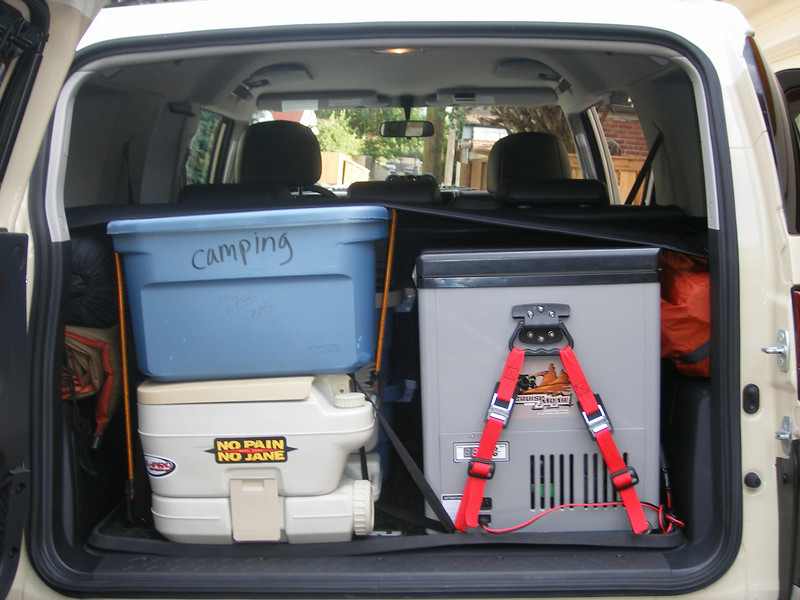

Here is what I have done prior to designing a platform. I just strapped it to the oem hooks on the bumper side and uses the seat belt mounts on the forward side with straps. I have it the same in the 100 right now
Hope this helps.
This is great. I am in the process of installing a second battery. Got the T-Max controller (IBS China Rip off for 1/3 the price!) The fridge will arrive tomorrow. For now, I plan on not installing any slides and will just tie it down similar to what you have done.
I"ll post some photos when I get around to installing it next weekend. Thanks for the ideas!
