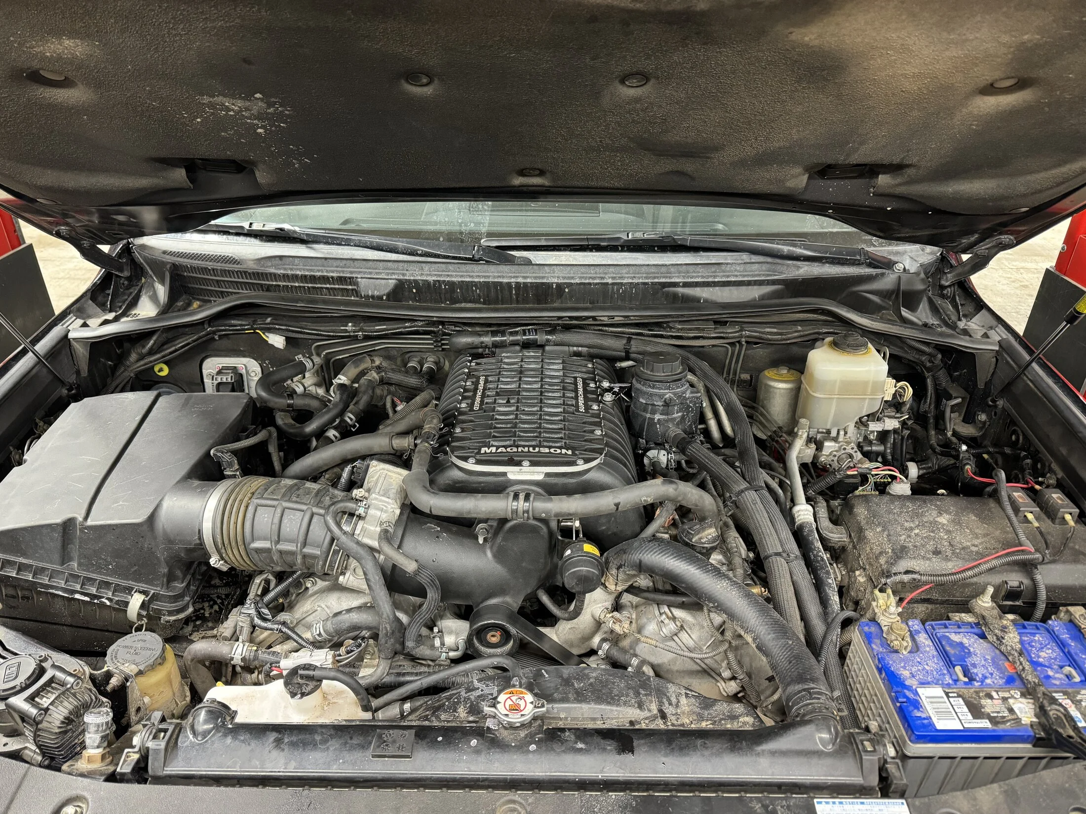

I have a Magnuson Supercharger kit for my 2013 Land Cruiser and need an ECU calibration. I contacted Magnuson and they won't do anything as it is a used unit. Does anyone have a calibration or a recommendation? I already have an HP Tuner

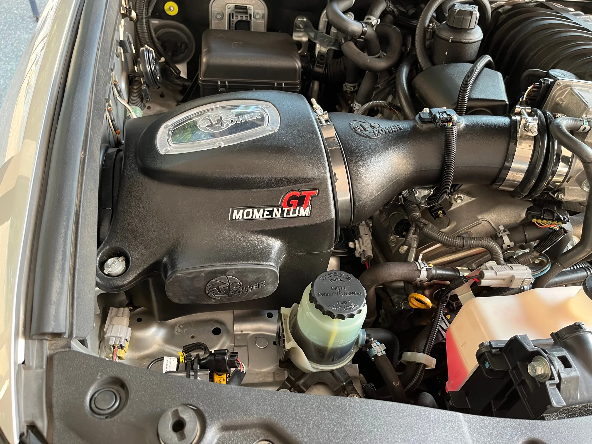

That's exactly what i did collecting files and comparing them. Are you using the stock air box? Also the AIT that is located on the Harrop charger manifold is susceptive to heat soak (can cause Check Engine) specially when highway run then park. Try using the stock factory MAF/AIT and see if that clears it. I also used the AFE intake system.
That's exactly what i did collecting files and comparing them. Are you using the stock air box? Also the AIT that is located on the Harrop charger manifold is susceptive to heat soak (can cause Check Engine) specially when highway run then park. Try using the stock factory MAF/AIT and see if that clears it. I also used the AFE intake system.View attachment 3772442
