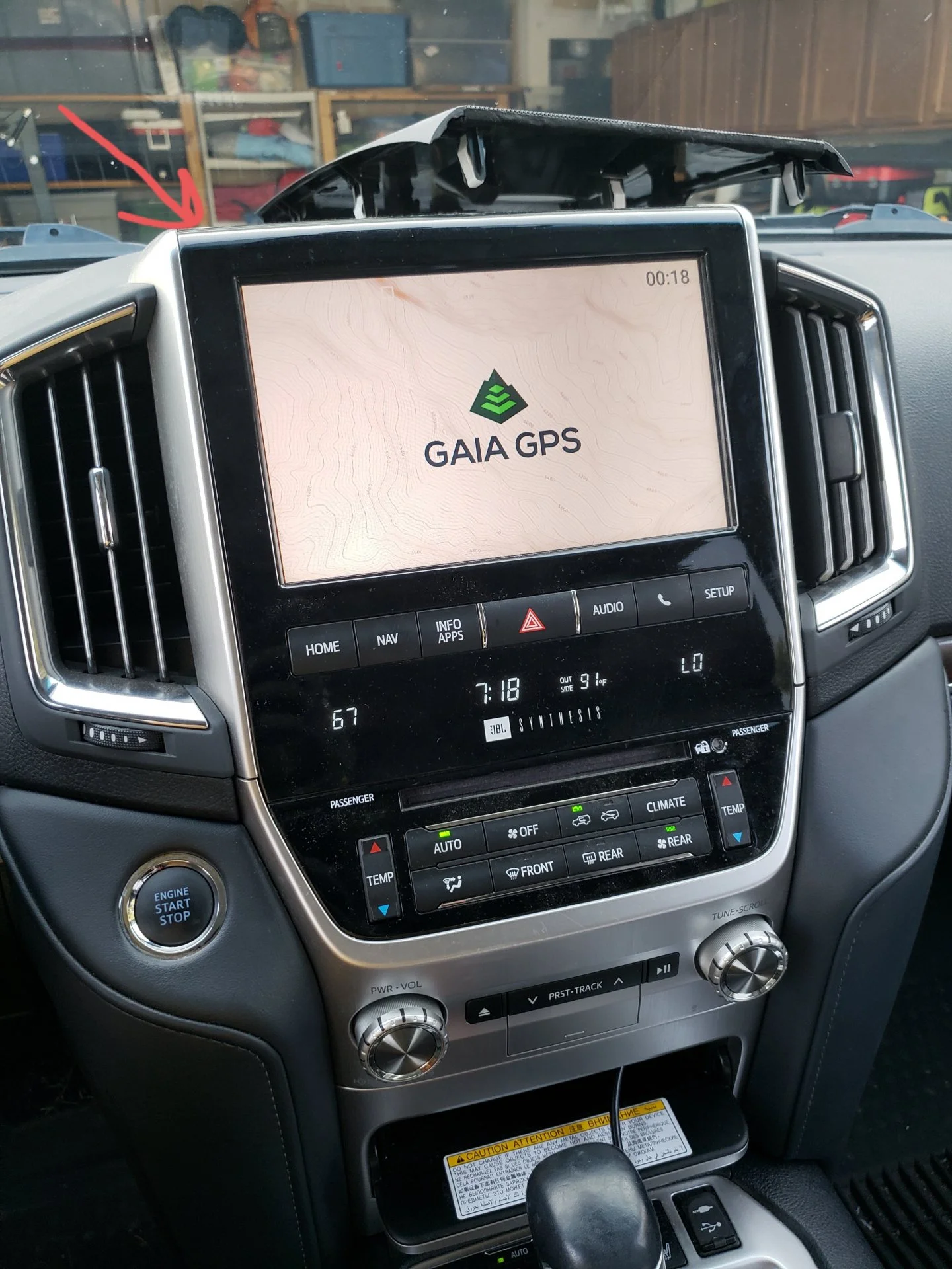

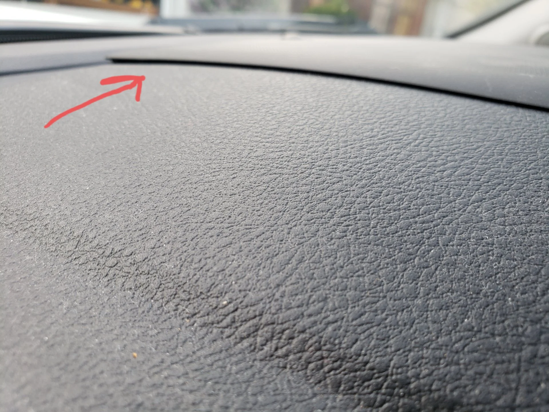

Has anyone found any other options for placing the GPS antenna? I really don't want it sitting on the dash.
I put mine in the back-left corner under the center speaker's cover. It fits there perfectly if you don't use the adhesive padding. If you do use the adhesive padding, then there's an unnoticeable gap when you put the speaker cover back on.
Thank you! Looks like you also have your USB cable coming out of the wireless charger tray.
I ran it straight out of the speaker mesh panel Ferris pointed out above.
I ran it straight toward the windshield. I did leave mine on the dash without sticking the adhesive
I can barely see it. Any gap in the panel is at the forward facing edge so I can't see it
I wanted to make sure I have the best GPS signal possible and was worried about the metal in the mesh causing issues
Didn't stick it down because I didn't want any chance to discolor the dash with prolonged use.
And if multiple people can confirm the mesh screen doesn't affect the signal (or I can experiment when I'm out in the boonies)
Then I'd stick it where Ferris did
I have mine sitting on top of the metal mesh (it has a magnet, so it doesn't slide around), but I'm probably going to put it underneath at some point.
I also want to find a better spot for the microphone as I've got mine clipped to the back of the metal mesh which results in a minor gap at the back edge of the mesh. I know one of you guys mounted your mic in one of the unused switch blanks; that's probably the best all around option for it.
