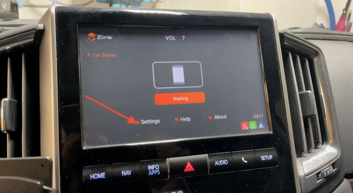

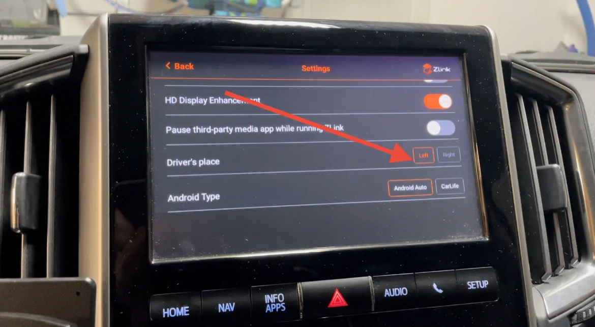

Installed! I have searched mud and gone through the CarPlay settings but cannot figure out how to move the Siri/Menu bar of the CarPlay Home Screen from the right side (for Oz I assume) to the left/drivers side of the screen.
Anyone remember? I also did not see it in the EC off-road settings menu. It’s been a long day, so apologize if I’ve missed it somewhere obvious.
There was a setting somewhere to change it from RHD to LHD. I cannot remember where.
Here you go!

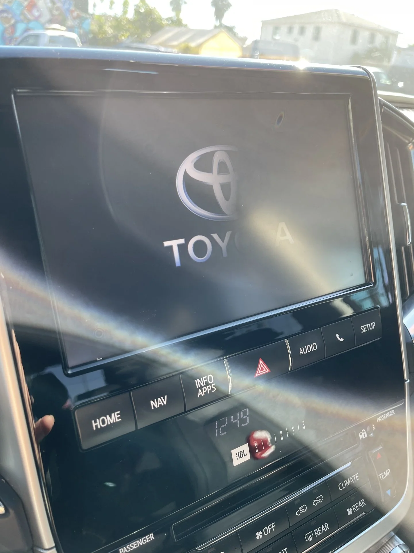

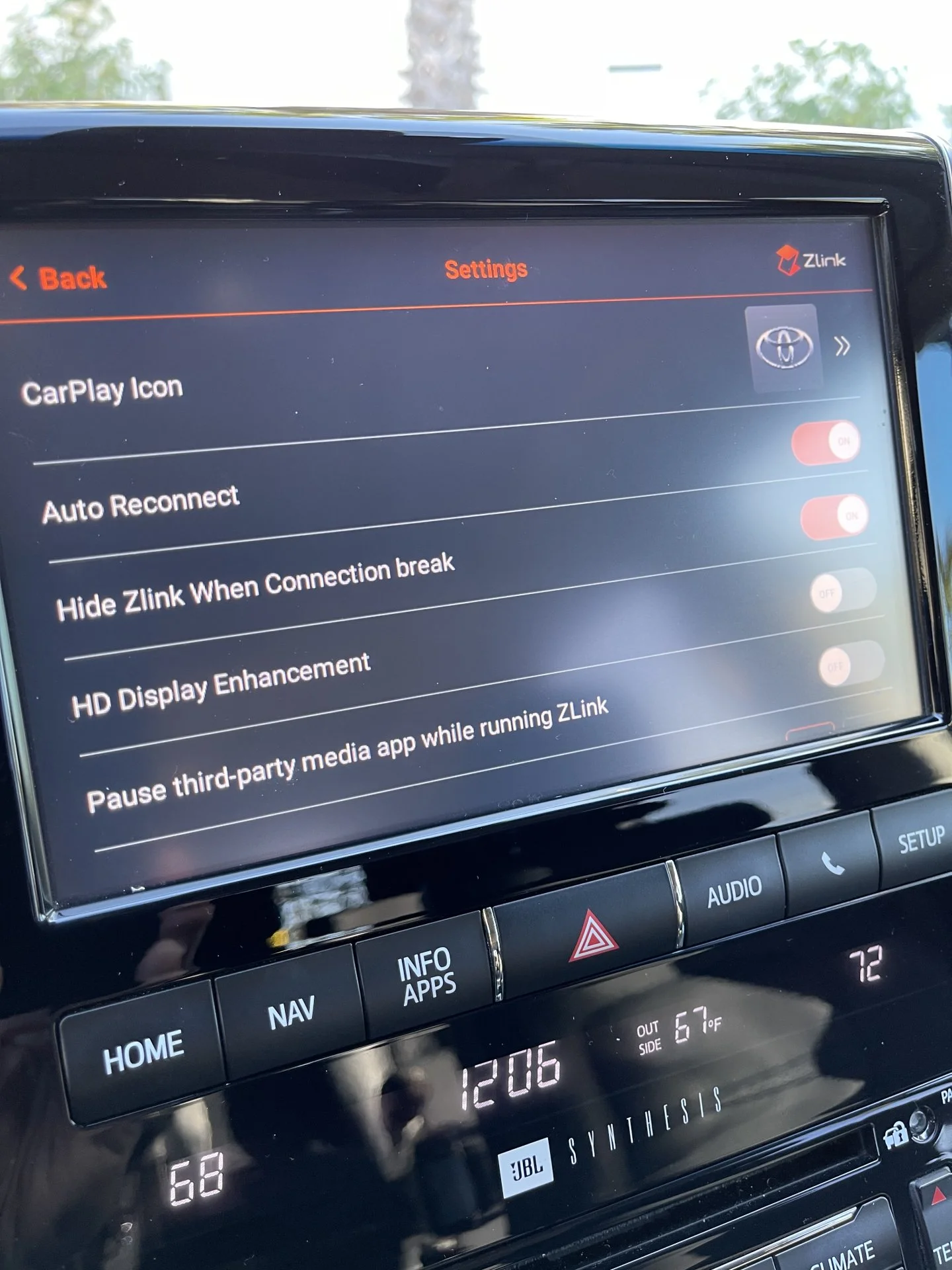

Anyone know how to change the default start up image?
As far as I know, it can't be customized by the user. On mine, it randomly boots up with a Toyota OR Lexus logo - no idea if it's truly just random or if it sometimes thinks it's installed in a Lexus. I asked EC Offroad about this a while back when I first got the unit after I noticed the Lexus logo coming up and it clearly wasn't a high priority.

My zlink setting is the same, but that setting controls what shows up for the "exit to car" (in our case, exit back to the Android interface) app within CarPlay, it's not what the EC unit itself displays when it boots. I see the Lexus logo during the system boot something like 40% of the time.
