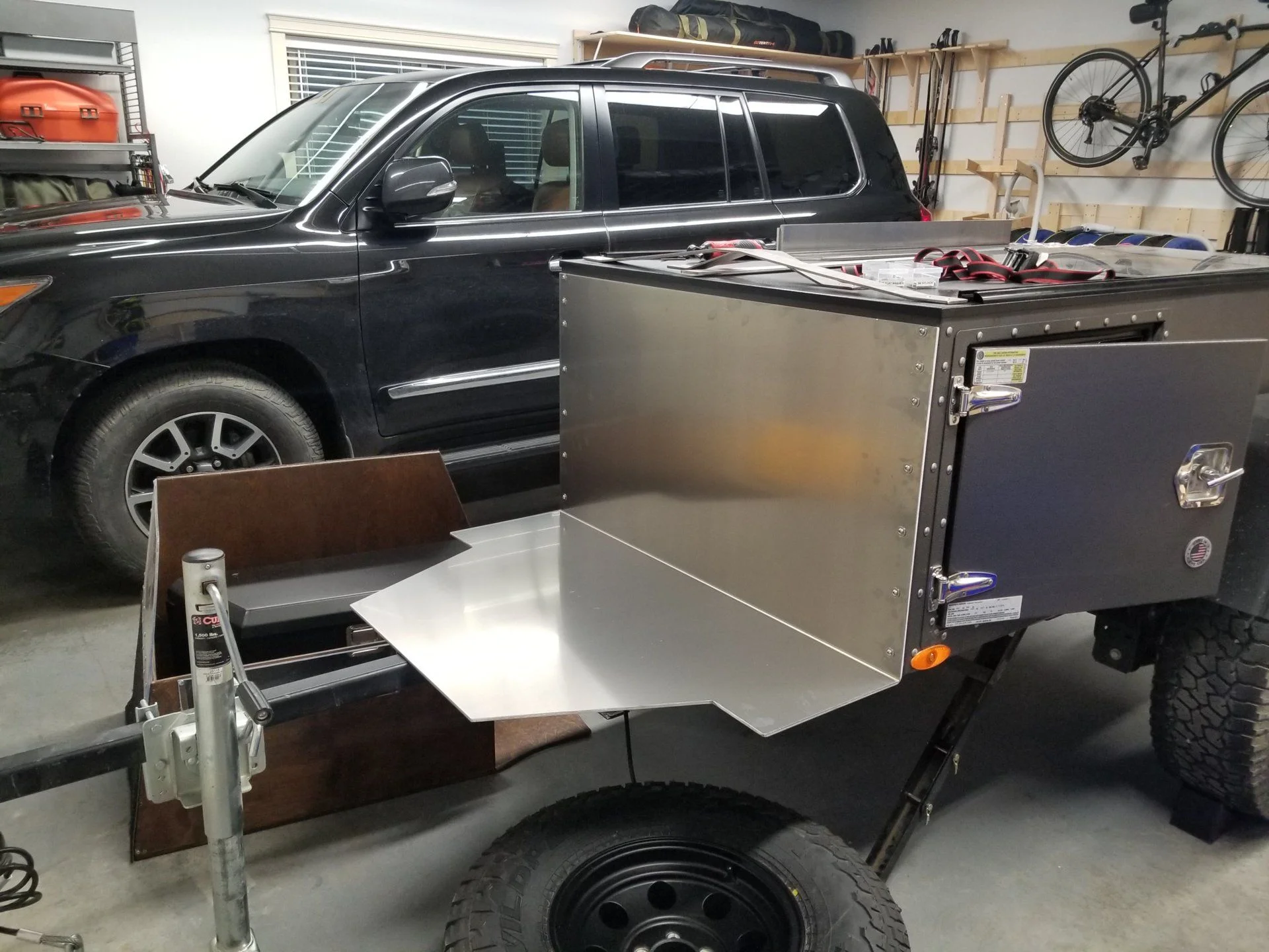

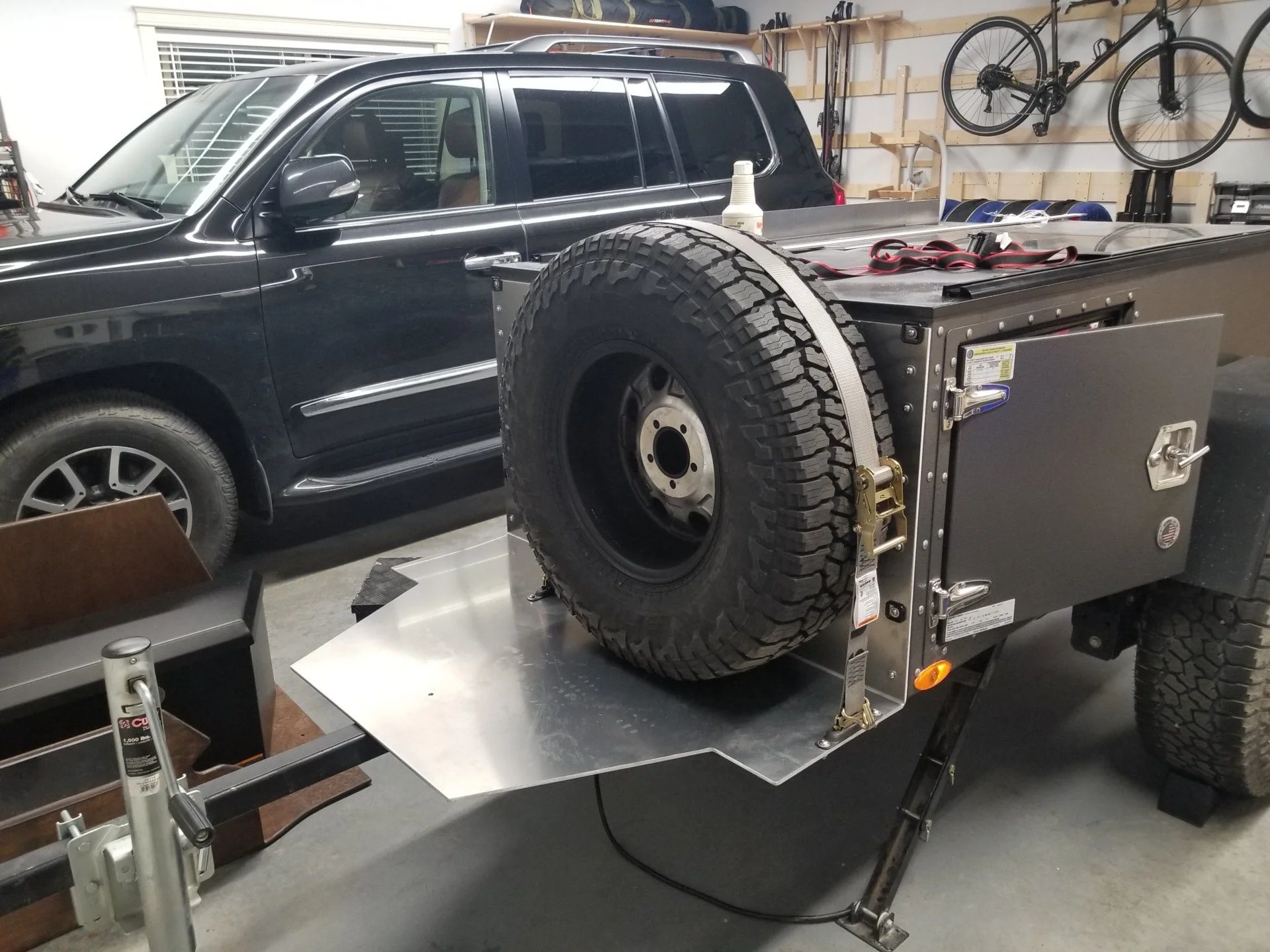

Got a platform built to my spec. Made from 1/4" aluminium. I lined it up, drilled mounting holes and bolted it in through the original holes in the front wall. Since taking the photo I've also drilled a hole through the tongue, and will bolt that together tomorrow (don't have a bolt long enough).
1997411

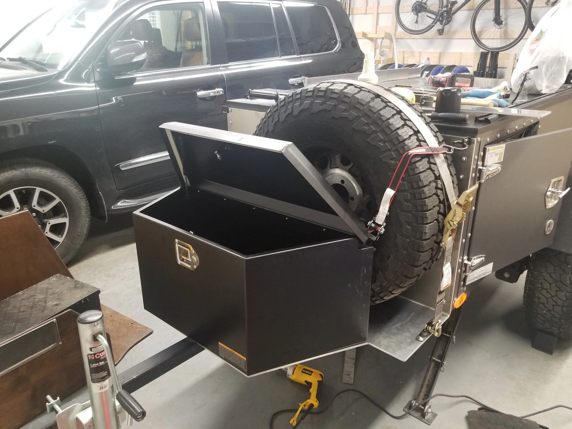

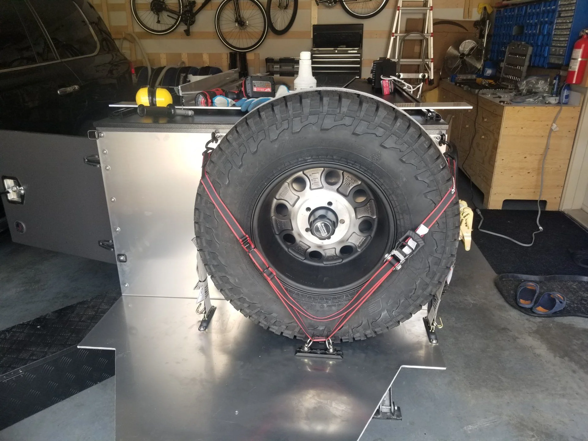

I then secured a spare tire, leaving enough room on the passenger side for other storage. I think it'll be a good spot for a propane water heater in some kind of enclosure.
1997413

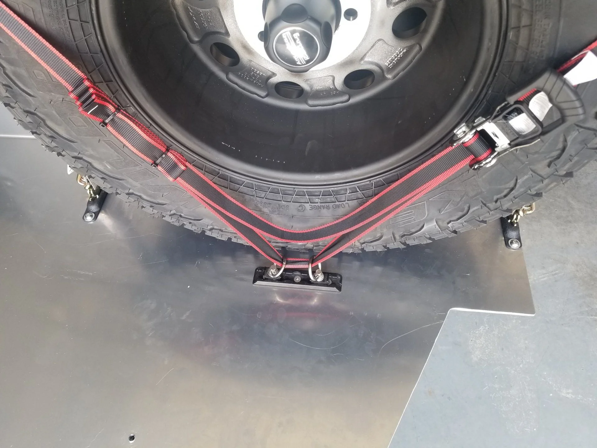

The tongue box will be secured tomorrow, too. And I plan to run another ratchet strap across the wheel, although I haven't decided how just yet. Mulling over options.
1997414
I learned the hard way that when the tire's contact point(s) and the strap anchor points are at the same level that you just about can't stop it from rocking. I'd suggest a small cradle for the tire to sit in that moves the contact points up 4"-5" inches. Even with the cradle this tire rocked because the anchor points and the tire contact points all aligned.
Thanks for the tip! Wouldn't have thought of that.
I'm going to look into ways of raising the tire. Or perhaps I can find a motorcycle wheel chock that would add some more stability.
Tried raising the tire on a pair of wheel chocks and it didn't make any difference for stability. Went with the original idea of an additional ratchet strap. Solid as a rock now.

Also mounted tongue box and one bottom support.
1998157
1998158
Both bottom supports are in (these are stainless). These added a bit of rigidity to the platform. Not a ton - c-channel or boxed would have been beefier - but it's better than nothing.
You would pick-up a lot of stiffness if you made a web that filled in the gap between the strap and the plate, and those were attached to both. As it is now the flat strap has no resistance to buckling. With a web attached to both it can't buckle, which turns it into a varying height C or I "beam".
Can you share any photos/examples of what a "web" would be? My imagination is failing me.
I could potentially run a long bolt through the platform and support, (in a few spots) where the two are not in direct contact, and secure each piece to the bolt with a pair of nuts. But that wouldn't be interconnected between the two supports, unless I also found a way to get a c-channel in there.
//edit: forgot that I'm talking about stainless here. I hate working with this stuff - really not equipped for it - so drilling holes through this material is pretty much "out" unless there's a very strong need for it. //
At this point I'm really not concerned about the stiffness of this platform, but fairly-easy improvements can't hurt, so I'm definitely open to getting them on the list of things to do!
Imagine creating either of these using your top plate for the top flange and your bottom strap for the bottom flange. They taper in height so the value for W or D gets smaller the further out from the tongue tube.
Said differently; you're simply filling in the triangular gap between the plate and the strap with a piece of sheet metal. They don't need to be seam-welded, can be skip welded, but it should be in the form of weld an inch, skip an inch, repeat. If they are to be bolted then the sheet metal needs to have full length flanges to bolt thru.

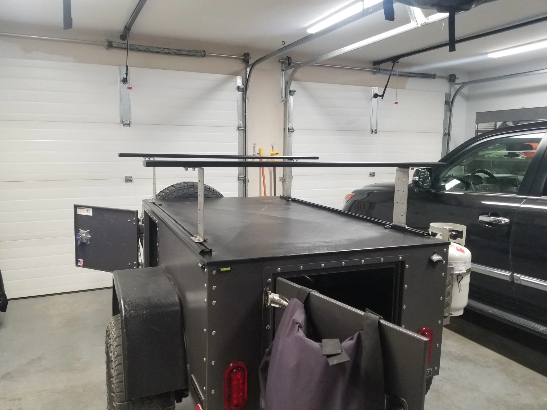

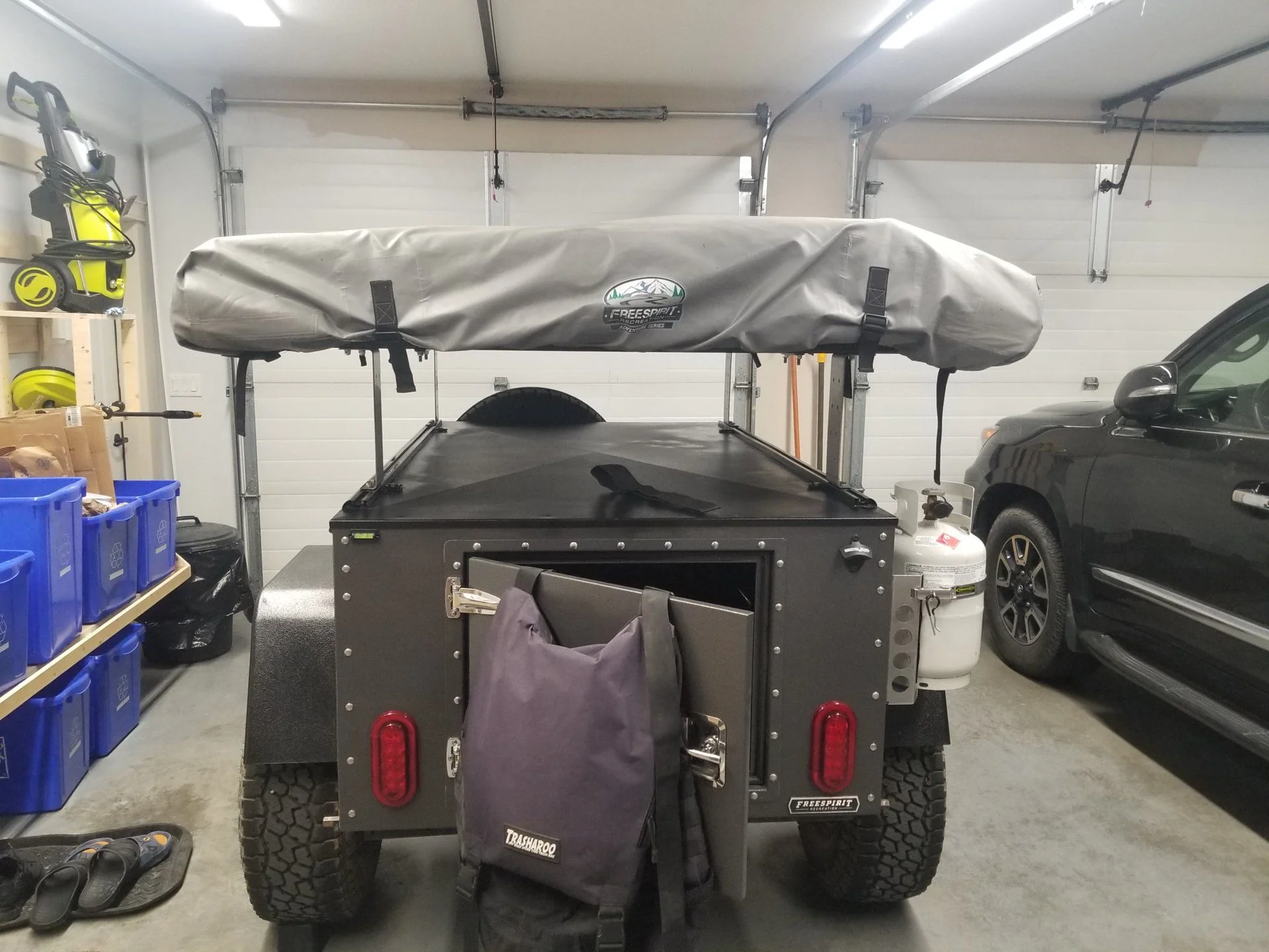

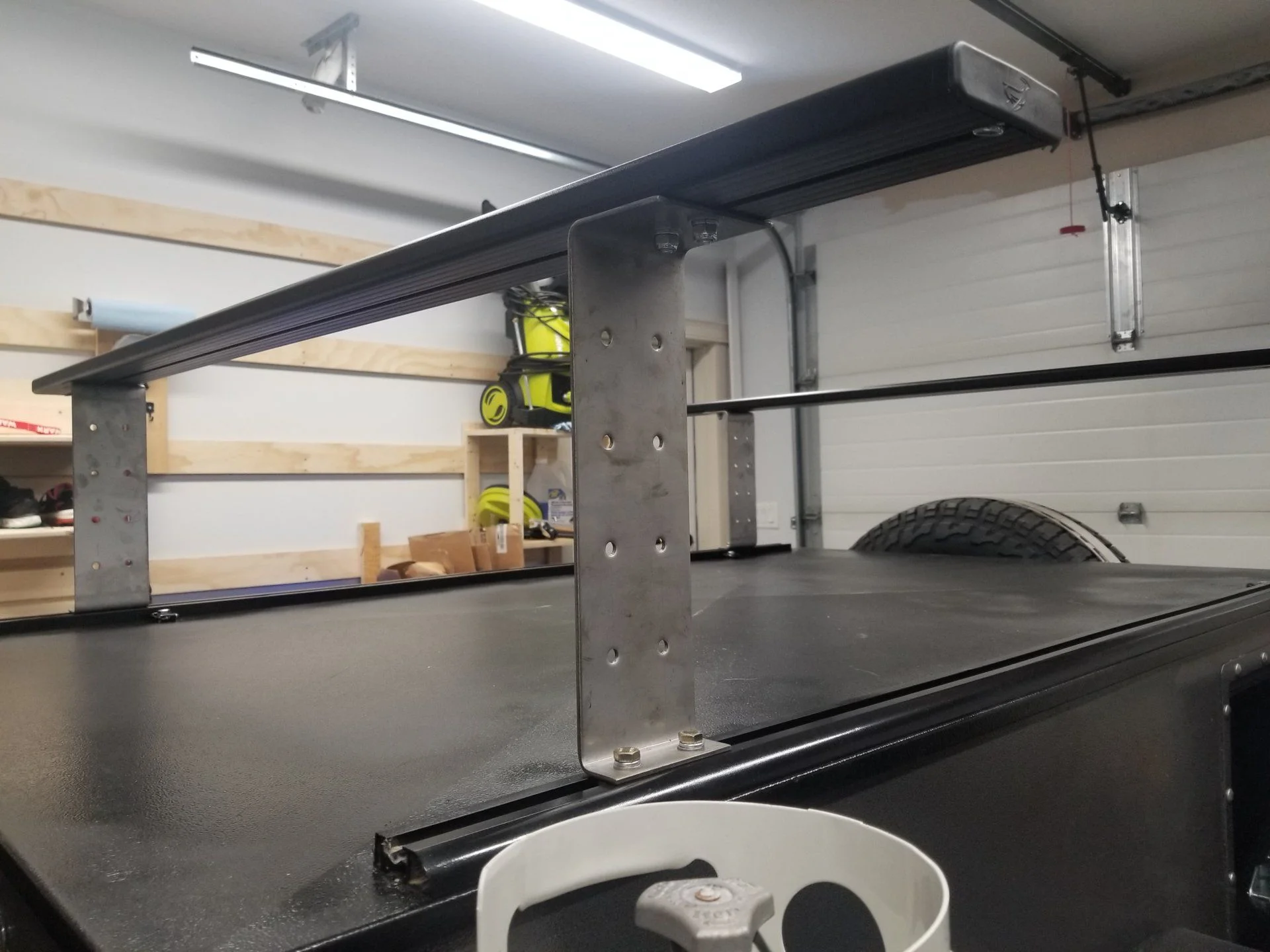

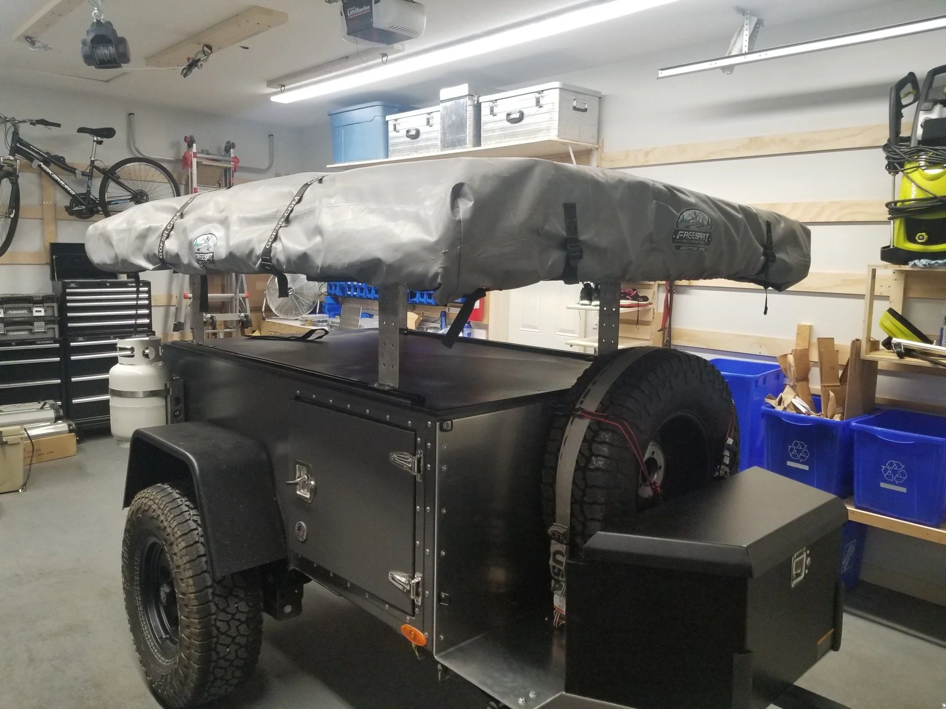

Received FrontRunner cross bars and had custom brackets made to lift and secure them. Made from 10 gauge stainless.
2001855
2001856
2001857
2001858
The tent sits great, but there's a bit of sway from side to side. I'm wondering if I should have had these brackets gusseted.
I may still get a shop to weld a piece of flat stock, running entire vertical height, to essentially turn it into C channel.
I'm a bit concerned that without gussets, with time and washboard, the brackets will weaken and break. Any thoughts on this?
My first thot on seeing them is that it would likely do that. Not sure what you have planned for above the top of the trailer and under the tent, but a diagonal running top of one side to the bottom of the other will be the most robust solution. If you have a way to tension it this could be a cable or wire. A turnbuckle would work too. Some strap might work, but the fit would need to be tight, no slop allowed.
Boxing in the sides of the very shallow 'C' of the brackets will help, but by itself probably won't be enough.
Diagonals that bolt to the holes in the brackets and clamp to the underside slot in the Frontrunner bars are another way to tackle this. The lower the set of holes used, for a 45° angled gusset, the more effective they'll be. These should be tubular of some type, not flat strap.

Yeah, the sway would concern me too - especially if you can get movement pushing on it, just sitting in your garage. Looking at your pics, I think your instincts are valid.
I agree with this.
Thanks, guys. Will start playing around with possible solutions.
Back when I had the Tacoma I had a nearly identical set of 10 gauge stainless brackets made for the hardshell RTT I had over my tonneau. I had six brackets, they were about half the height, and the were slightly angled inwards (towards each other), instead of straight up like this set. There was zero flex/sway with that setup. I should have had these angled, too - might have made all the difference.
I was/am hoping to use the space under the tent for something like a cargo basket, for carrying things like firewood, maxtrax, etc. The holes in the brackets are intended to be used for small items like quick fists (shovel), possible light pods, etc. I'd like to retain the most possible room there.
Diagonal steel cable and turnbuckle to tension it is probably the simplest (and cheapest) solution.
I also do have a fair bit of remaining 80/20 (1" square extrusions) that I could use to bolt the bottom of the FrontRunner track to the lower set of holes. Will see how feasible this is.
Something like these?
Yes, exactly that.
It's a bit tough for me to cut the mitred angles. I did a lot of that recently, and find that my mitresaw's blade tends to leave a cut that's not perfectly straight (using a roughly 90-tooth wood blade). So the angles tend to be a little bit "off," and it's not a perfectly flat match between the surfaces of the materials being joined.
I can drill a 45-degree M6 hole and bolt one end to the vertical just fine, but bolting the other end to the bottom of the FrontRunner track will be more of a challenge. The FR track takes an M8 bolt, and if I drill an M8 hole through the centre of this piece, it'll take away too much material. I think I'd have to make an aluminum plate which will bolt to the 80/20 material, and then bolt that plate to the FR track.
