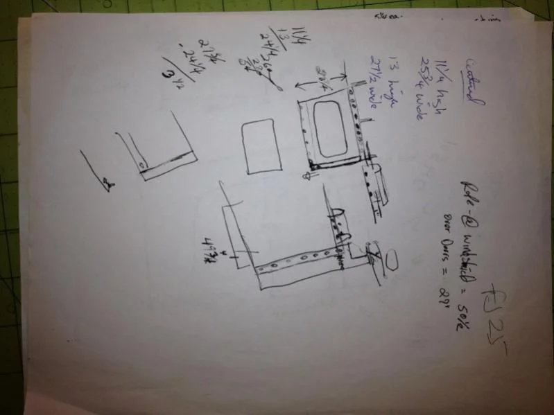

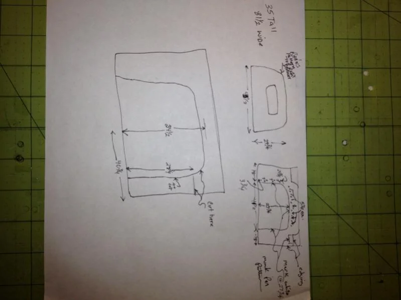

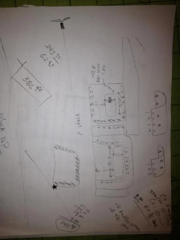

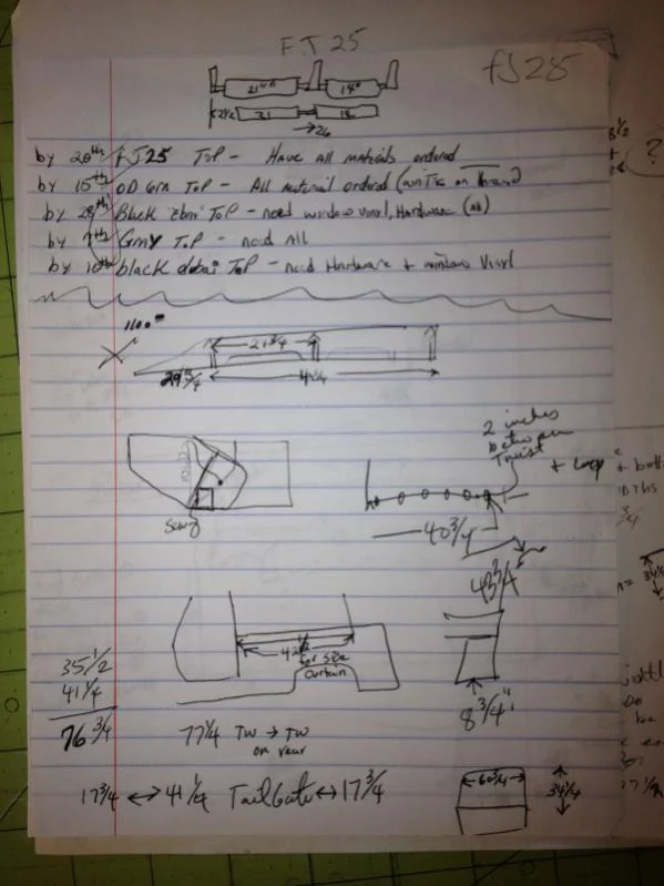

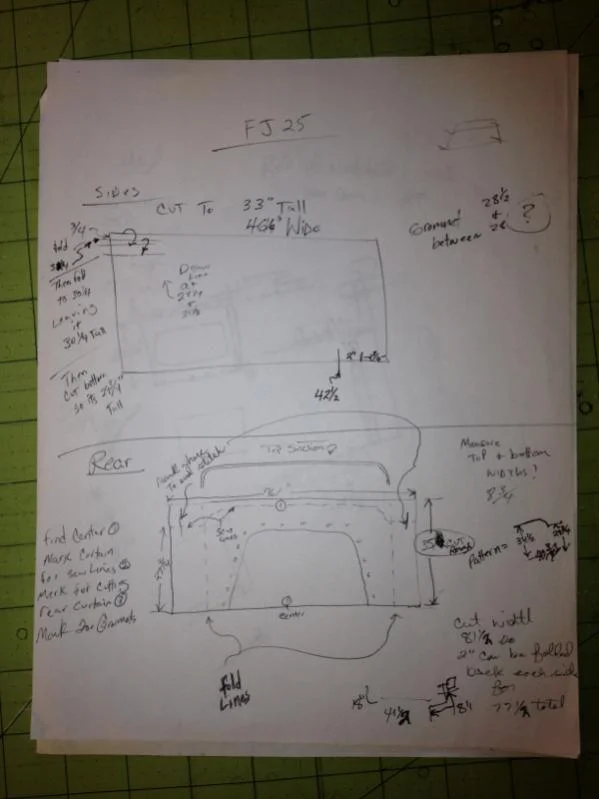

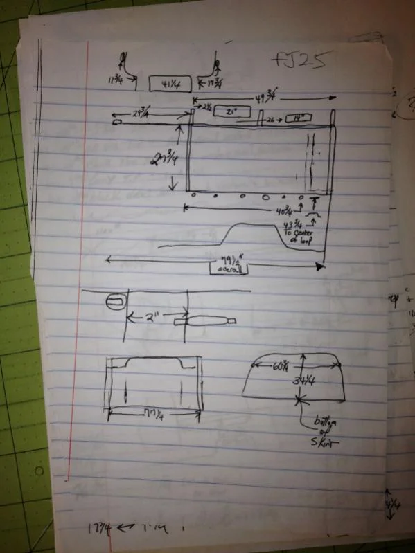

if youre making an early top these may help.....otherwise itll just resemble my past lack of organization and cohesiveness of thought...
if i get time i'll try to sort it a bit. any questions and i'll try to answer.
if you buy an inexpensive tarp to rough your patterns it will save much grief and waste....
make the first top from a thirty dollar canvas drop cloth.....put it on.....see how it fits/shrinks....and use it in addition.....
the top i made for jim from those notes was tight so keep that in mind and adjust as needed.....had i not used canvas/a material that shrinks...those measurements would probably have been perfect...
maybe adjust your bows between min and max to allow for adjustment since your material is dimensionally stable...
look at the thread jim casagrande started for additional bow measurements.....
find the horizontal line and measure across the top for top.....below for sides....dont forget to add to sides that are under the top....
the windshield corners need a dart (google) sewn in but its much different than that of a std 40 top....this is where sacrificial material will shine....trial and error it.....
