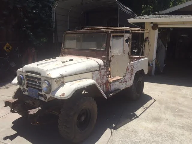

Haven't been following this thread very closely over the years as I didn't think I'd ever have the pleasure of owning one of these rare beauties :D As luck would have it though I was able to persuade my good buddy Daniel Watters to part with his early FST gem. Trollhole is a good friend and located just a few hours away from me so I am going to have the 40 shipped to him in hopes we can bring these the FST reproductions to fruition! If you've got interest in having Trollhole make a top please post up.

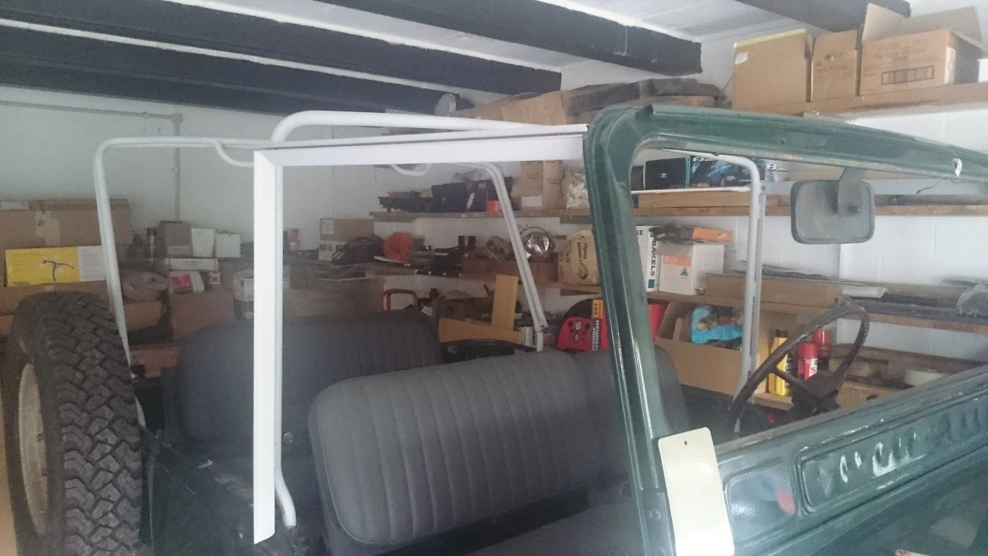

The windows are going to be the hard part. We simply cant make the rings. All we can do is make the opening or maybe do a high end thicker plastic window that looks the part?
Next up is I need a pic of the windshield channel and how it went on the truck. Need to know how wide it it and the dimensions. Jp's truck doesn't have one. You could see where it was welded in but it's gone now.
Couple of questions. If we do it in OD green is everyone okay with that. It fades quickly probably just like the original. And after a few months would be a perfect match.
I need to know what you want to do on the common sense fasteners? Riveted or prong?
Buckles. will black or chrome do or do they need to be painted? I can probably get it painted but you guys will need to come to a consensus on color.
Or should I just have all the hardware painted to match the current Toyota common sense fasteners?
Truck is at my soft top company. Need to get this knocked out before the boat season cranks up.

if no one gets you measurements on the windshield channel before next week, i can get them along with pics when i get back from moab.
I can send you guys either the channel or lop off the top of a frame and send it. I have two in the scrap pile. PM me if you want it.
