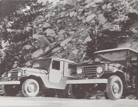

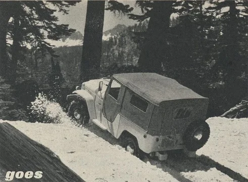

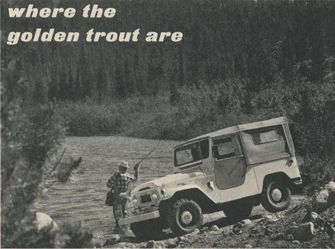

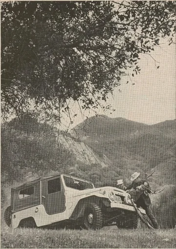

Since we have possiblities for tops made for the early curve door fj40's and fj25's ....
I thought it would be a good idea to put photos and images of factory shots and photos of FST that pertain to the Early FST's
Any images that may be useful for somebody or links to specific information (threads or otherwise) could go here for an easy reference to somebody who was going to attemp to make an Early FST
disclamer.... i do not take credit for alot of this stuff... i have collected alot for years... if its yours .. let me know and i'll credit the pics
THREADS of usefulness (thanks nuclearlemon)
Soft top bow dimensions: https://forum.ih8mud.com/fj25-owners-group/336284-early-bows-dimension-fit-check-help.html
Early Soft Top Canvas notes: https://forum.ih8mud.com/fj25-owners-group/578326-early-top-construction-notes.html
Last go around: https://forum.ih8mud.com/fj25-owners-group/45428-fj25-early-fj40-soft-top-project.html

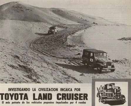

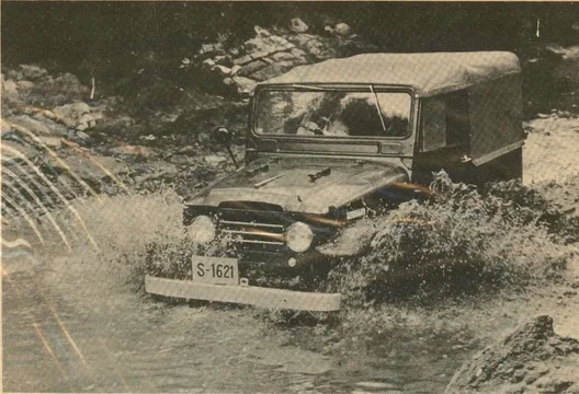

1st pic 1955

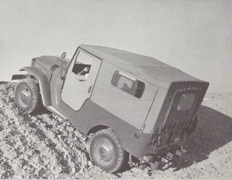

2) from 1960
second to last from wes?

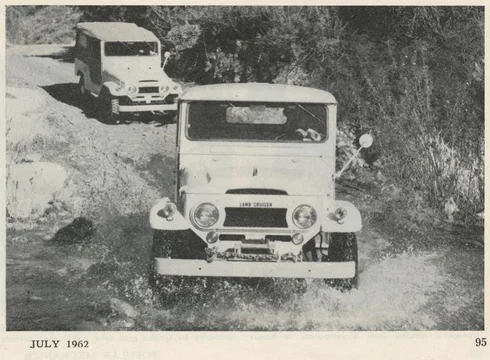

last pic from landpimp

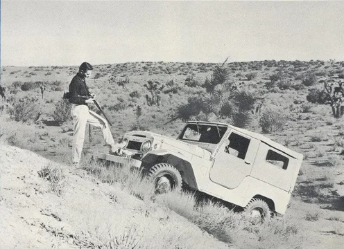

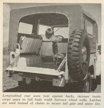

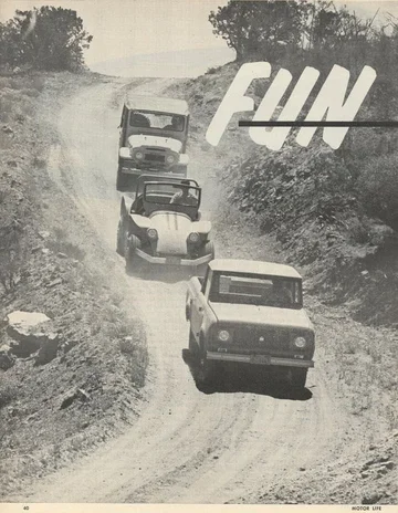

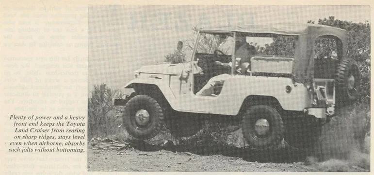

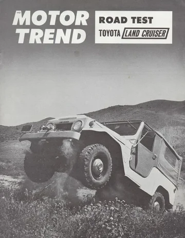

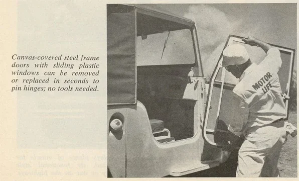

and two more... I realize the last one isn't an early 40 but check out the early negative splicing MotorTrend did ;)

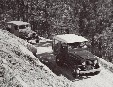

i am begining to think that white was offered earlyer... unless these were replacements later... but they are the screw in windows
I remembered this top, I should have figured you have a pictures saved. Someone can probably date the Dodge pickup better than I can but it's a 93 at the oldest. That would make that top at least thirty years old if it's original. Is it possible the top has faded from the sun in the southwest? With the worst rot on the top makes me think it sat outside for a good part of the that time. I'll compare part numbers from the FJ25 to the 63 FJ40. If there was a color change the part number should have changed.
Did a little digging to day. The canvas part numbers were different 62 than the FJ25. The manual I'm using to cross reference old part number to new work well if you have the new and want the old. Using the 25 new number I was cable to find five different side curtain and four different tops. Some of that could be because of the different type of bows but my July 62 shows no canvas numbers that start FJ25. So it may be design change or color changes. No color is mention in the description. The part number for the C style FJ25 and Std early FJ40 are the same and start with FJ25. That is the most common style imported to the US. The header piece that goes over the door has a different part number between the FJ25 and July 62 FJ40. My FJ40 bows are from a 61 and I believe the same as the FJ25. Maybe TreerootCO can let us know what the part number was in 61. I think the little L shaped bracket used at the windshield came a little later than 62. Don't remember seeing it on the 62 micro-fiche.
