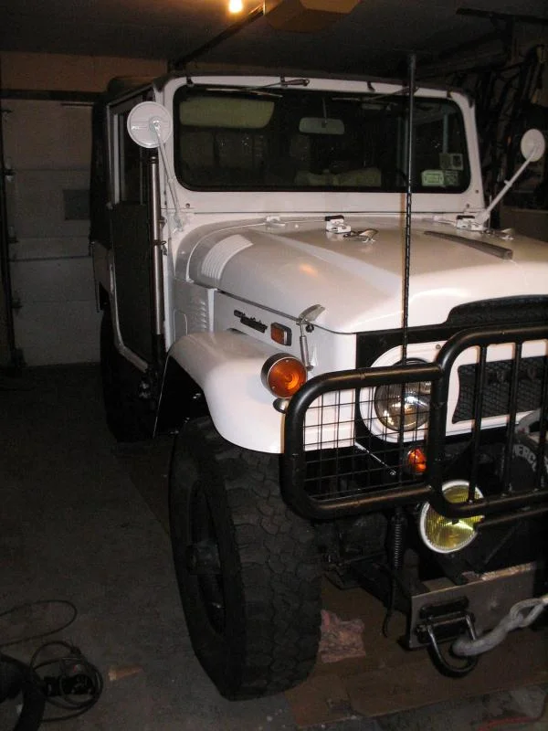

pete i converted my 74 to an earlyer style
all i did was split the wire going to the directional...ran the running light wire to the bib lights and kept the directional to the tin cans.
the early tin cans are only wired for directional...so thats the way i went.
attachment.php
The front bib lights are set up for dual element bulbs. Lucky for us since the FJ25 used the bib light as turn signal and parking light. Plus the pre 64 used the same dual element housing for tail lights. Toyota never bothered to change that to single bulb just didn't install the second wire. I converted a few sets back to dual element. As for the front turn signals those are set up for single element bulbs. The main difference I see is the posts that hold the bulb in are across from each other on the single element bulb and off-set on the dual element bulbs. Probably find a dual element bulb with the posts across from each other but going to be more of a special bulb. The earlier bib with bib lights are not hard to find in the US but in Japan it would probably be cheaper to just mount some in a later bib. Of course your later bib has the square bezel whch wouldn't have the early look.
