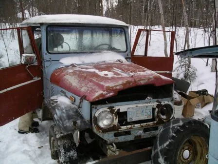

The best pic I have at the moment is attached. The bug catcher window on the older door has one hinge on the front of the glass that allows the window to tip outward rather than rotating on a center point like the '73 wing window. I can get better pics later in the week if someone is interested. The roll up glass on the older style door is about 1" longer than the '73.
