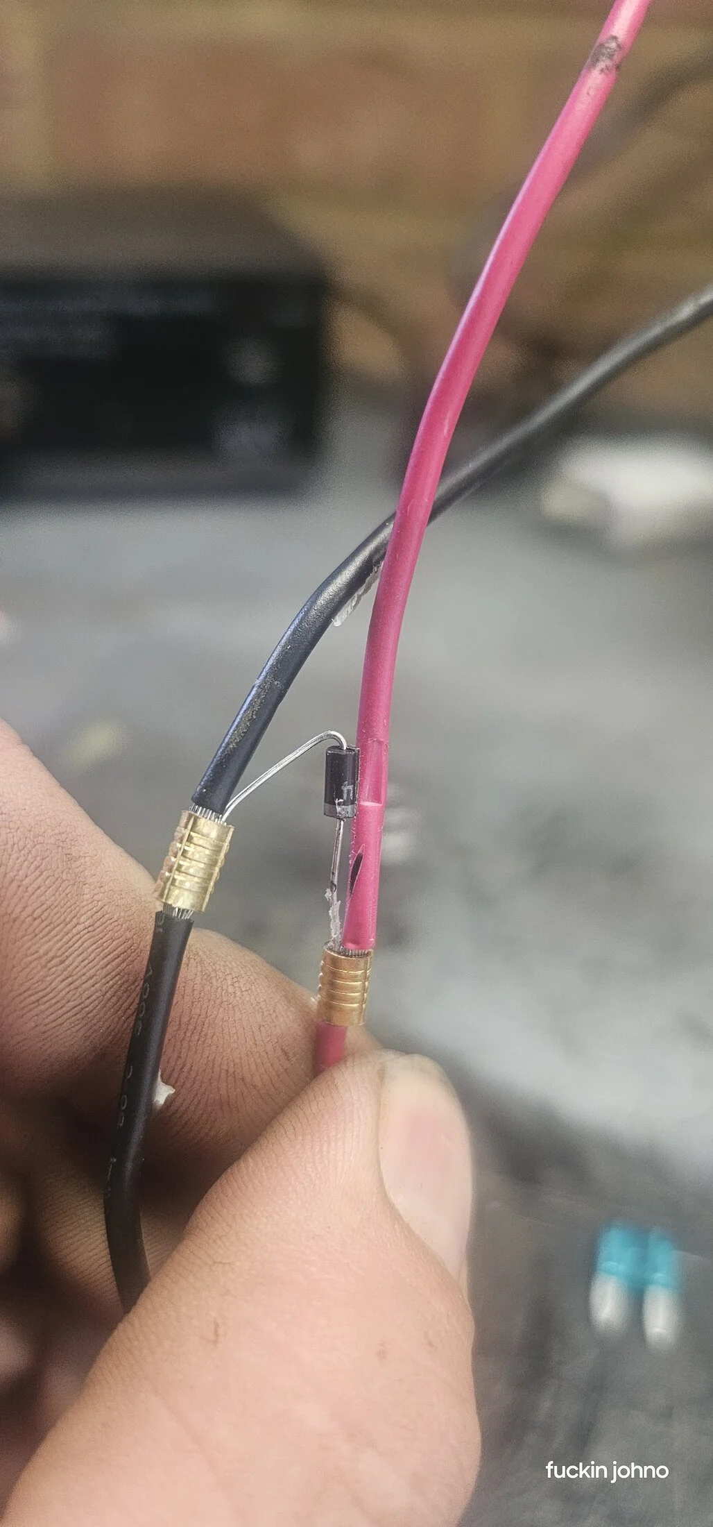

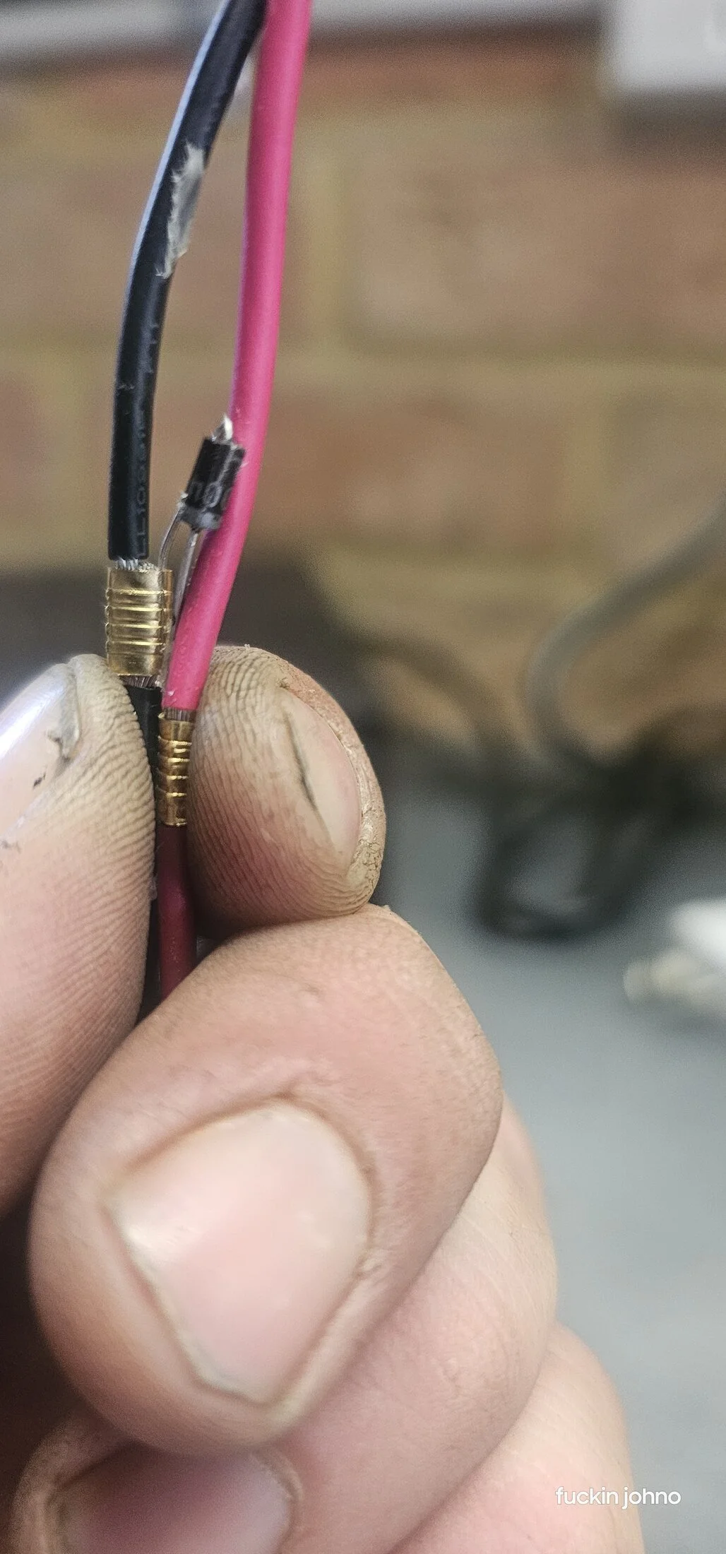

Rightio...so pulled the whole harness to bench test, de-pinned the relay base and played around with the 30/87 and 86/85 pins still no luck..next thought I decided to remove the load wire from 87 pin, as its the only wire heatshunk with the neg and diode between the two, fuse didn't pop! Cut off the heat Shrink and found when the harness was built the diode ends between the pos and neg where giving me a dead short by touching the wire joins....fkn pre setup fir failure 🙄
You can see the burn mark on the pos side from the deadshort
