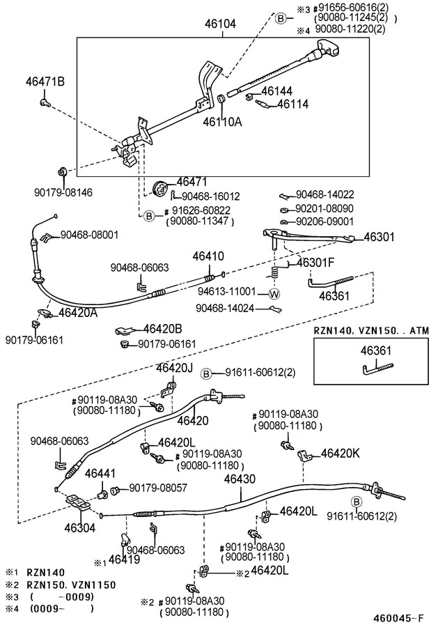

I've been looking at the Tuffy security consoles and would really like to have the extra 2" width. I saw an old thread (maybe from 2011) a couple months back where someone discussed relocating the emergency brake handle to the dash like the Tacoma has, but they never posted any details about whether they attempted it or looked into it further. The approach they mentioned was using the hand throttle location in the 80.
Anybody tried this? Any thoughts or suggestions on the complexity of doing this?
Tacoma Handle:
Hand throttle location on an 80:

I wonder if this could be as simple as mounting the Tacoma dash handle, buying some braided stainless steel cable and swaging the new longer cable from the handle to the brake?
something like the 7x19 3/32" SS or galvanized cable here:
http://www.webriggingsupply.com/pages/catalog/wirerope_cable/wirerope-galvanized.html
Connected to a handle assembly like this:

Yes - I've done it on my 80 and it was more for a custom console (some pics here - will do a desperate write-up at some stage when get a change from my little trip right now - see sig) - currently in Panama on way to South America etc. The unit was from a Tacoma and fits fine (same location as picture above).
Two downsides:
1 - if you have large boots on sometimes your R foot will 'catch' on the braking level going down (as it drops a little in-line)
2 - my cable coming out goes thru the floor and although ha strainer/rubber plug its still "strained" so its hard to pull and activate. Christo (@slee) indicates it would have been better to move the in-floor plate mechanism to the "hole" where the parking cable will go thru and use that. That is far stronger and will allow the force (pulling) to be better spread out So thats on ny 'upgrade list' for the future.
Right now it works but really have to pull hard to get it to really hold.
