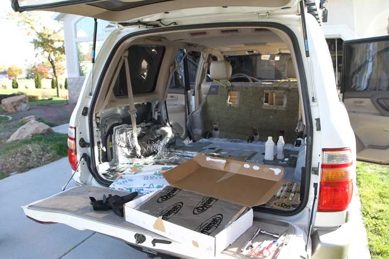

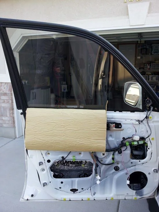

I'm only half-way through the sound insulation install on my 100. So far the front doors, the rear cargo area, rear lift gate, and half the second row are complete.
Still need to do the rear doors, the rest of the second row, and the front.
Used Dynamat Extreme, Dynaliner, and Focal BAM purchased from a local audio shop for sale.
May try something different up front though - haven't decided yet.
The big difference - at least for my ears - was getting rid of the "unwanted" noises. Covering the rear wheel wells, doors and floor have all made a noticeable difference.
