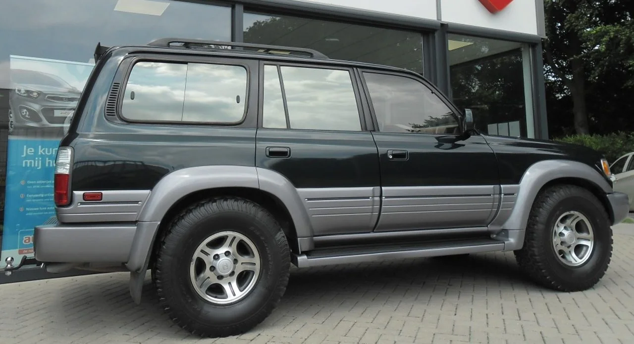

It wasn't the ideal car, first of all it had a wrong badge, I won't lie I'm a bit of a toyota fan. Besides that it was an automatic, has way to much luxury items (eg. things which can break) does not have f/r diff locks, in need of quit a bit of maintenance, has the nasty roof rack and did I mention the wrong badge on it?
It was however a competely rust free car (imported from US since they where never sold new here) and rust free is by far the hardest thing to find here, so I became the proud new owner of this 80 series (with the wrong badge). Still quit the improvement over the daily driver it was replacing:

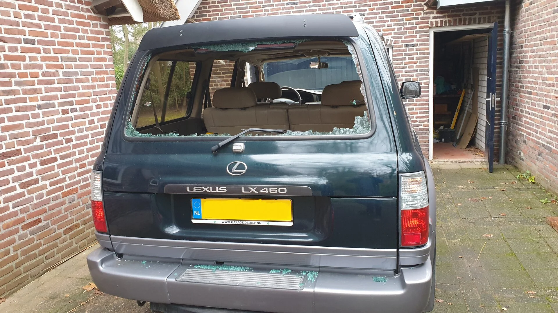

Then unfortunately at some point when minding my own business driving around the rear windscreen shattered, up until this day I have no clue what caused this but gladly I managed to find a second hand one:

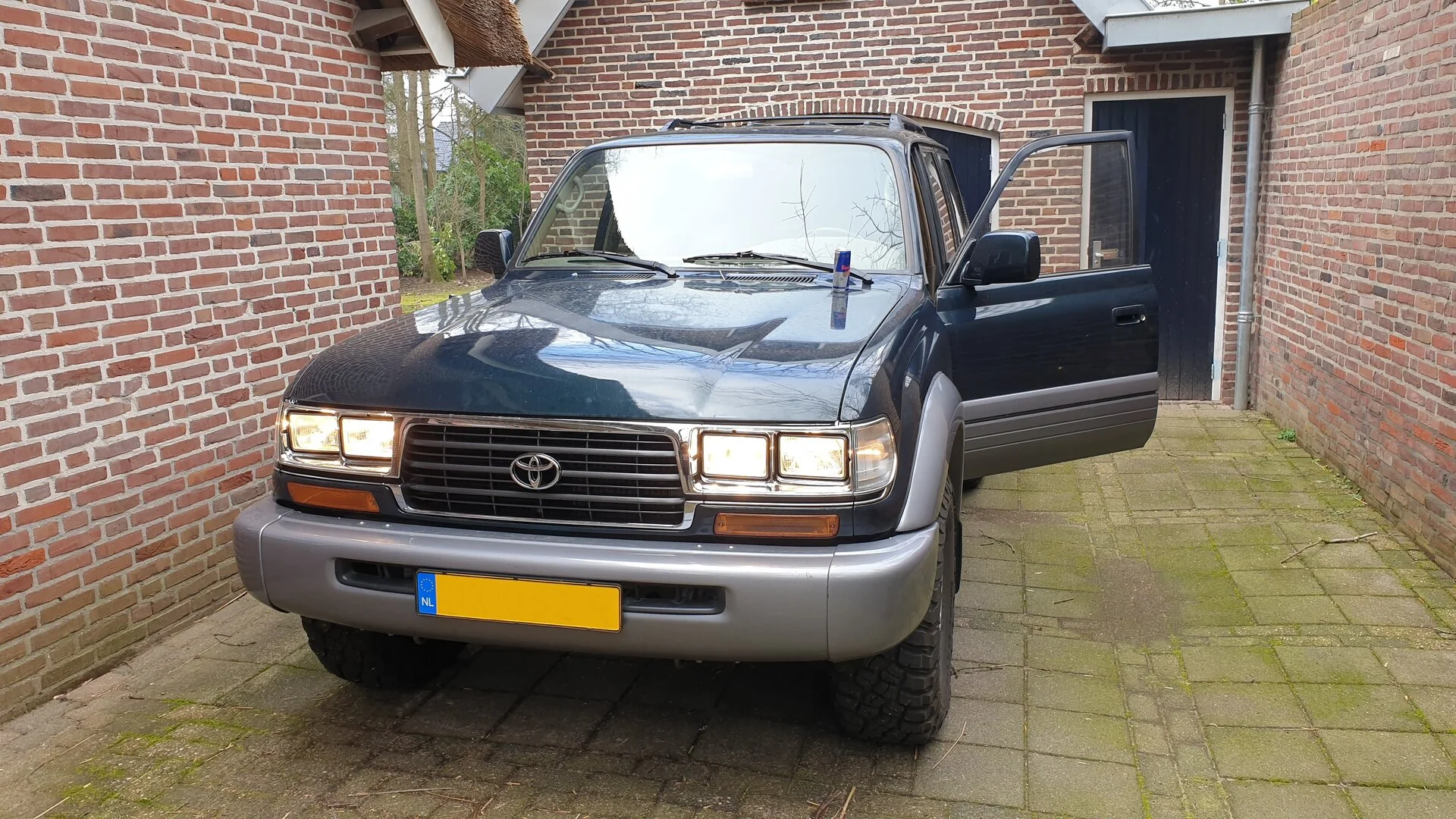

In the next unfortunate event the car failed inspection on the headlights (apparently the reflectors inside where not good enough anymore and therefore the beam pattern was completly out of wack). So I did the only sensible thing, and changed the entire front to a NOS set of the down under style quad headlights 🤭
It was not supposed to be a high prio items but since the headlights had to be changed it made sense to do it now. And they dont fit with the lexus grill so I even had a good excuse to replace one of the "wrong" badges 😬

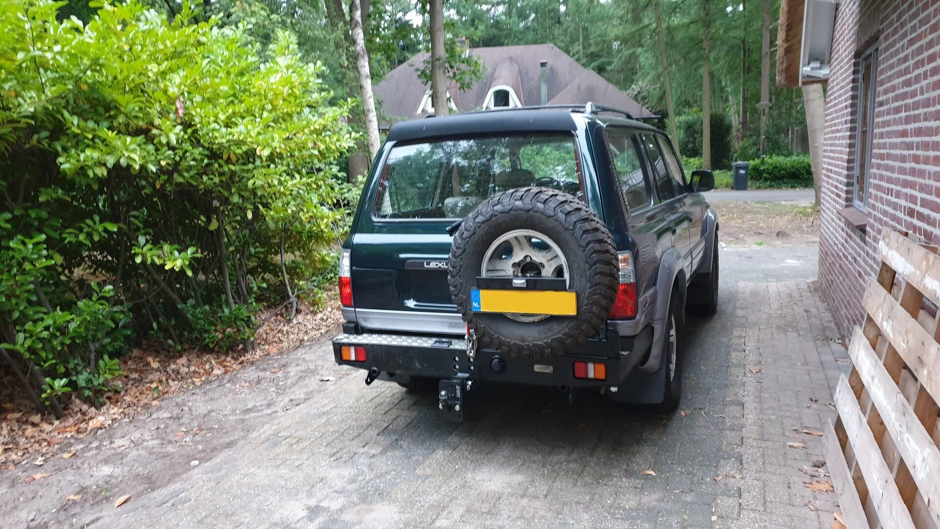

Now I was getting quit keen to get the poor little thing sitting a bit higher. The old springs was sagging a bit and not very comfy on speedbumps. Of course, me wanting to do everything the right way once I decided to do the bumpers first so that the new springs have more or less the right weight sitting on them.
I started with the rear bumper mainly because the spare wheel didnt fit underneath the rear if the tow hitch was installed so I was getting quit sick of lugging the spare wheel around in the boot taking up space 🤬
Unfortunately due to the lack of these kind of cars in Holland the aftermarket support is not great, and a lot of US companies just won't ship their products to europe. Unfortunately this is also the case with SLee, as I would have loved a slee rear bumper. The best option I eventually found was gobi-x, a south african brand. The bumper design is pretty decent and its quit a bit lighter and cheaper than the ARB bumper but I still regret this decision, The departure angle isn't that great and the powder coating quality is pretty average, already showing rust spots a year after installing without any serious offroading).
So maybe I'll find something different in the future or custom make one.

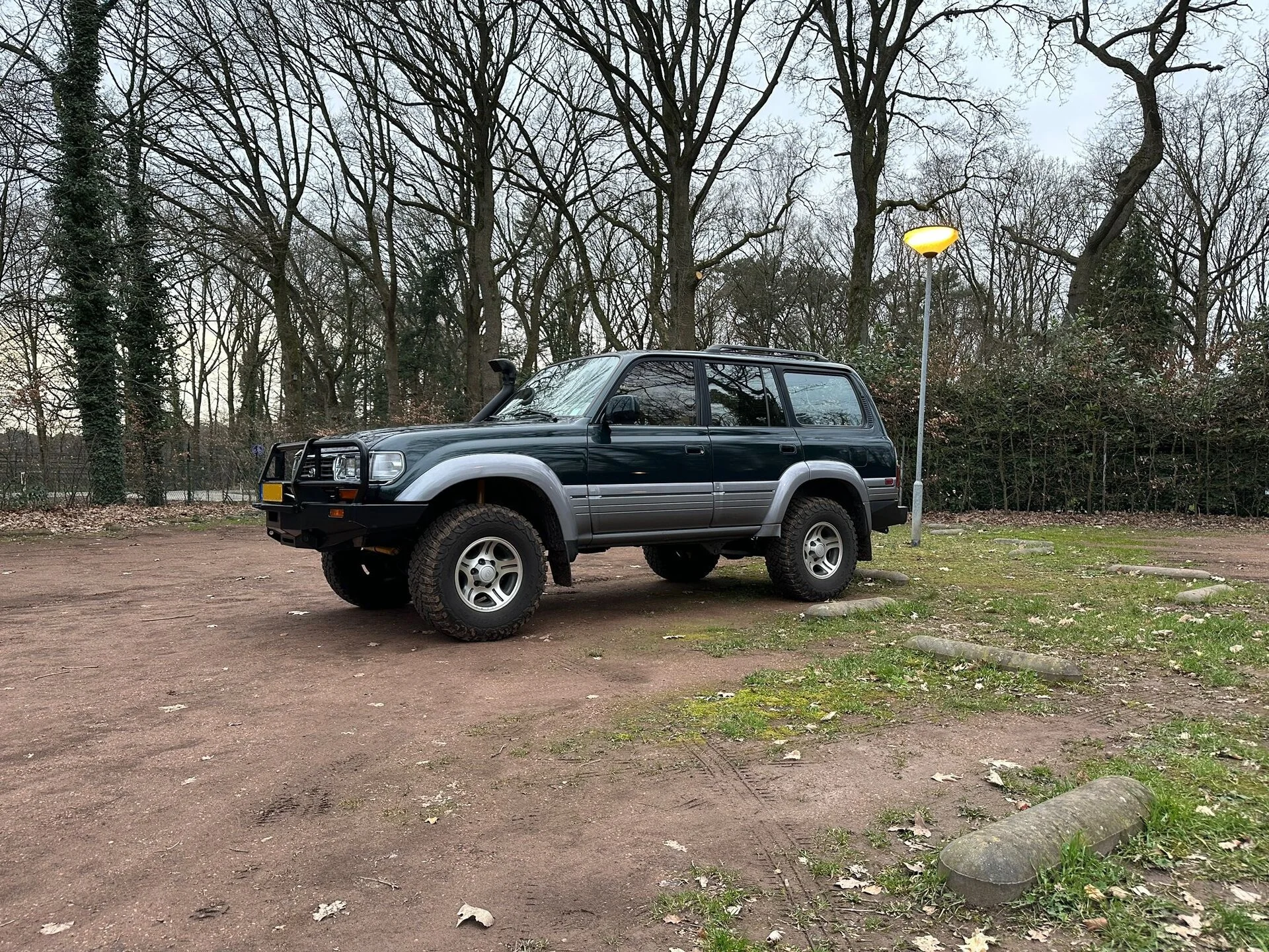

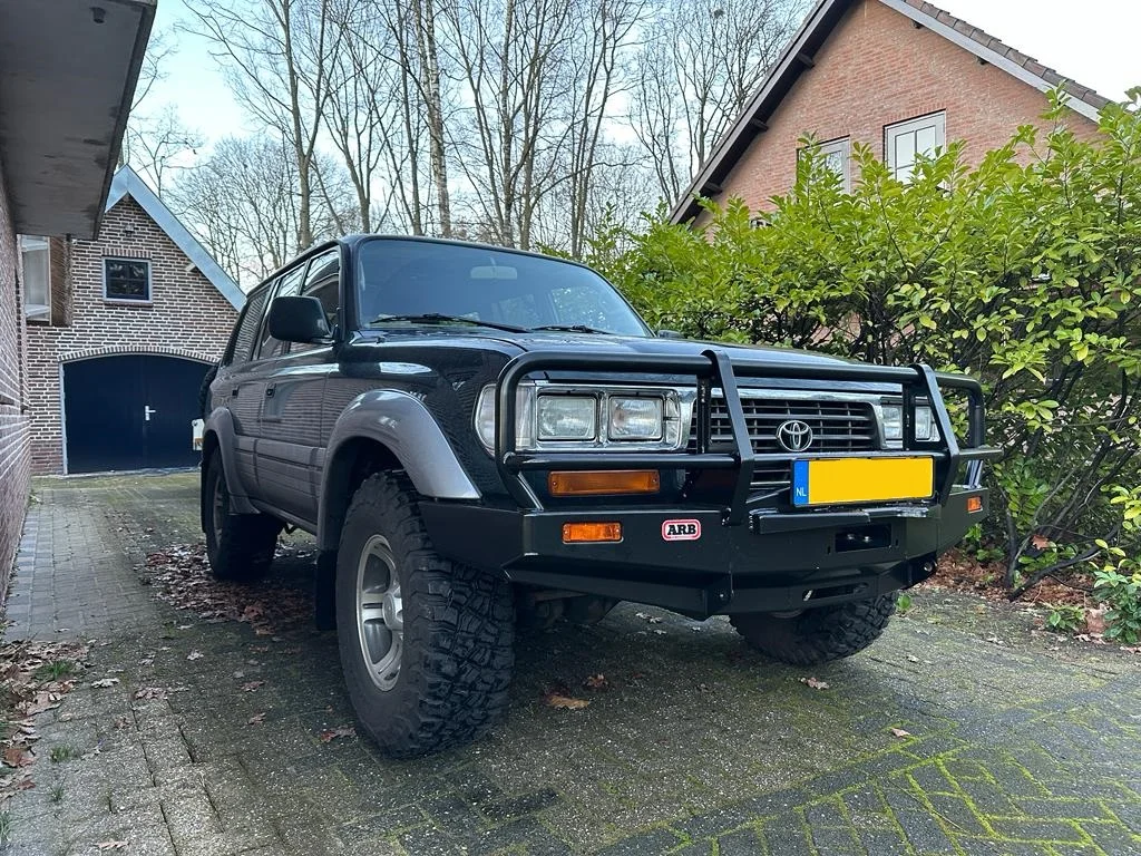

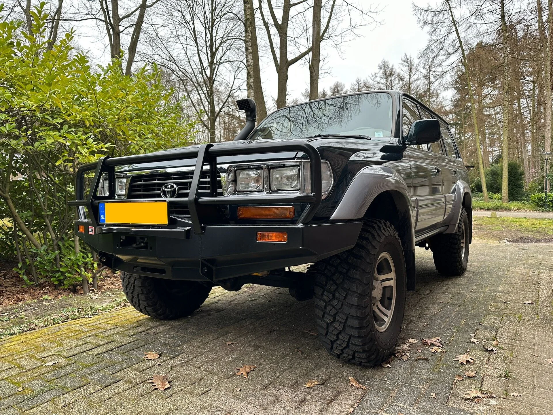

Next up was the front bumper, and eventhough there is only a few option availabe in europe I didn't mind this time, because I love the oldschool look of the square ARB bumper, eventhough it is probably not the lightest/best.
So off went the old and on came the new one:
The theory proved slightly different than expected. It drove like a pig with the already saggy suspension when all the added bumper weight was also added 🤔
So shortly after I figured it was time for the lift kit, I was planning to go with a 3" lift but settled with 2" lift over stock height to save myself the hassle of changing panhard mounts, swaybar and bumpstop extenders etc.
Maybe I will still go that route in te future but for now I am quit happy with the 2" lift. Due to the saggy suspension and added weight of the bumpers the 2" kit actually resulted in between 3 and 4" of lift over how it was sitting before 🤭 I guess it was due time:
The observant might see that I also couldn't resist putting a cheeky snorkel on around the same time and found some one piece third row windows which don't make constant howling noises on the highway and are actually water tight 😏. Looks a lot better already in my opinion!

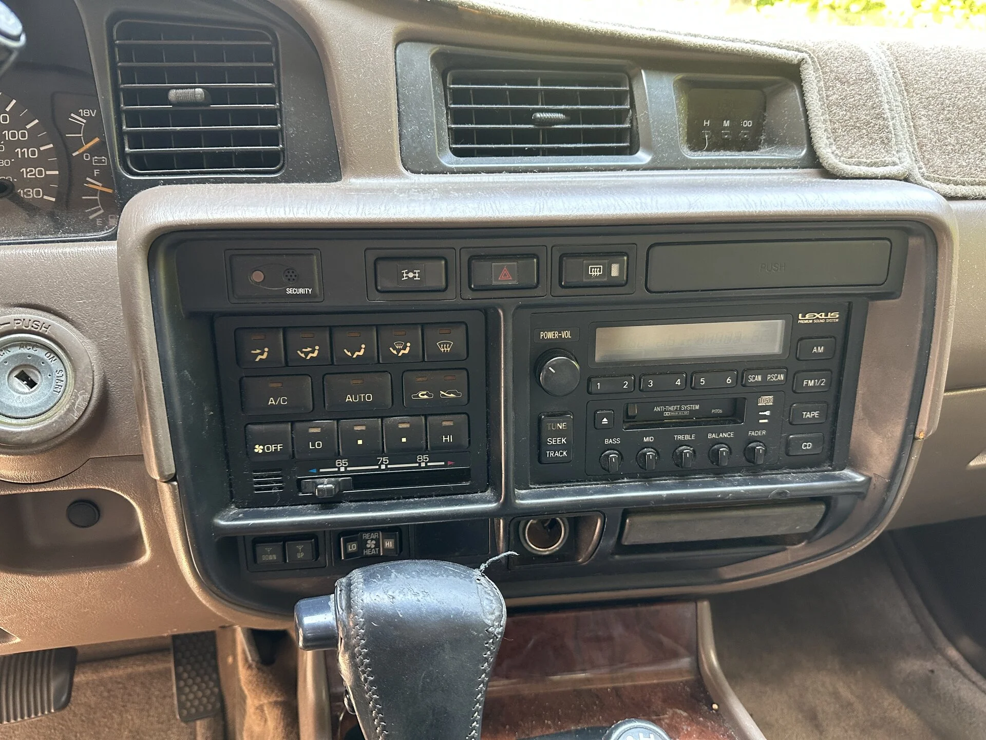

what luxury items are you referring to? i have had 3 lx450s and 2 land cruisers and they have all been equipped the same
Most NZ models I was familiar with didn't come with electric seats, had manual heating control, definitly no cd changer/subwoofer. electric antenna, cruise control, automatic climate control. etc
I personally like cars as simple as possible, because in my experience that makes them as bulletproff as possible, so no sunroof, no A/C, Diesel. manual gearbox, windows, seats, mirrors, antenna, etc.
And if something goes wrong, it makes diagnosing the issue in the middle of nowhere significantly easier as wel

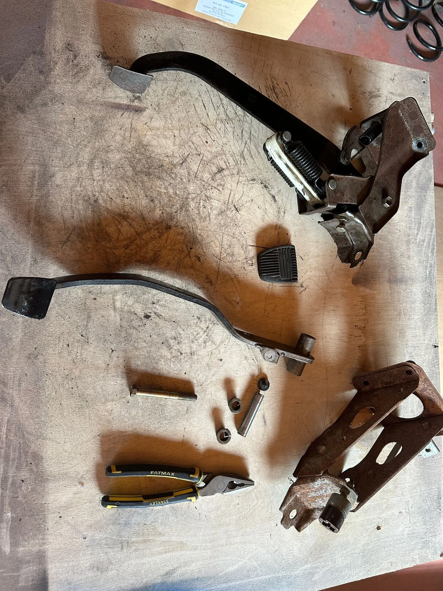

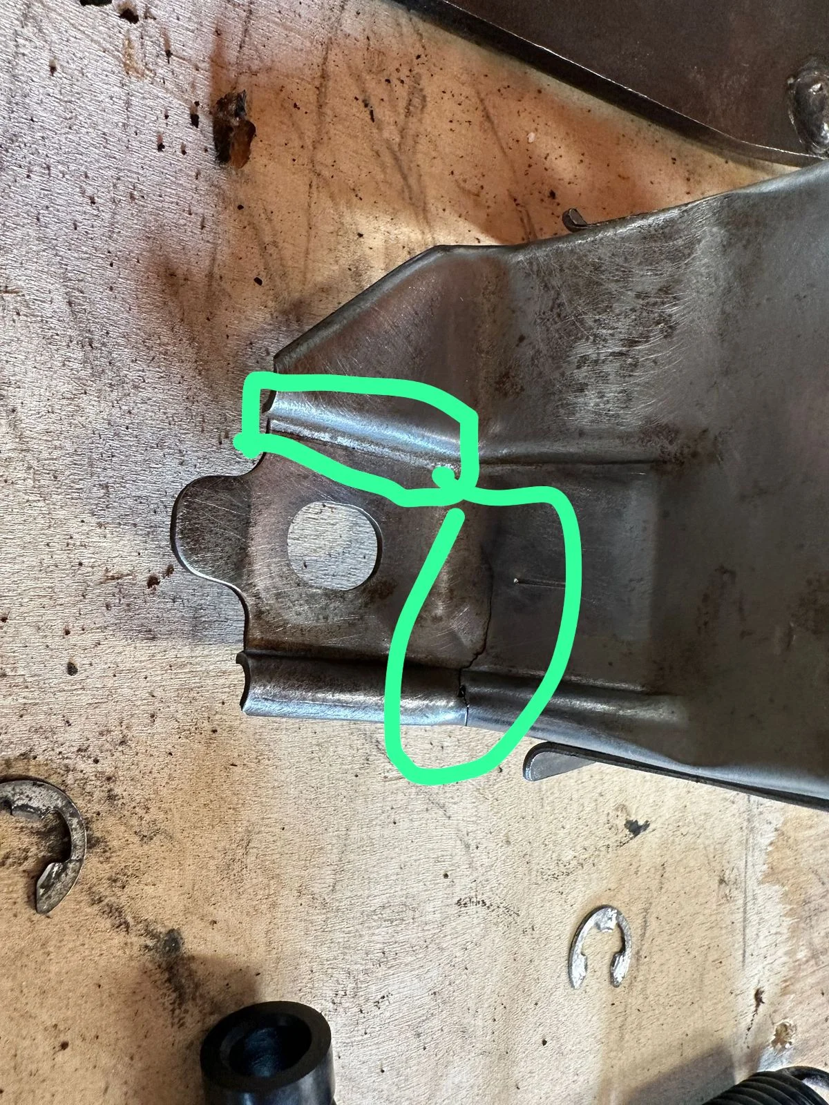

Just a little up date, the new to me clutch and brake pedal assemblies arrived today.
Bit rusty, but hey beggers cant be choosers nowadays. Started stripping them down and cleaning them up straight away, the brake pedal is in nice condition, and I can reuse my current brake pedal mount from the auto brake so I dont have to use that rusty bracket.
Clutch pedal disassembly and cleanup

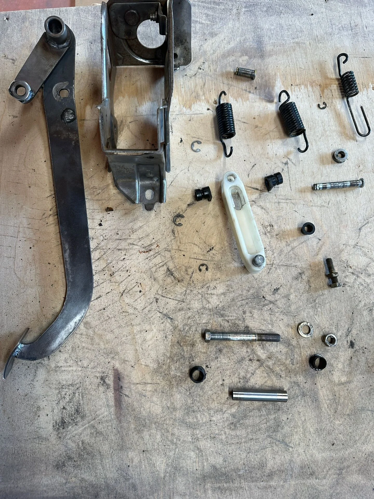

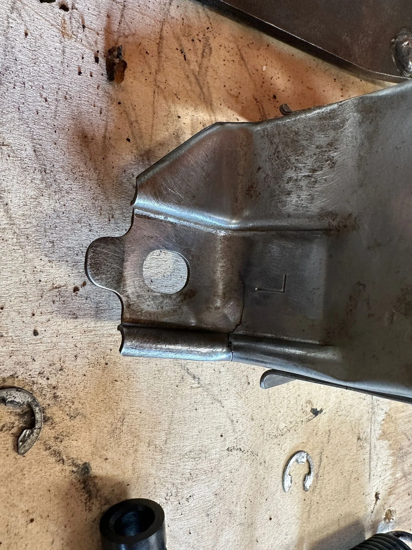

Unfortunately the CLutch pedal is more worn, the bracket is cracked in a few places and the clutch pedal itself shows pretty heavy wear too 😔
I should have another set on the way from france, I had a feeling this could happen 😏 so I'm hoping that the clutch assembly of that one is in better shape.
I'll still weld up the crack and the hole to redrill and restore this pedal, and for the manual conversion use the best set and the sell on the second for someone else to enjoy.

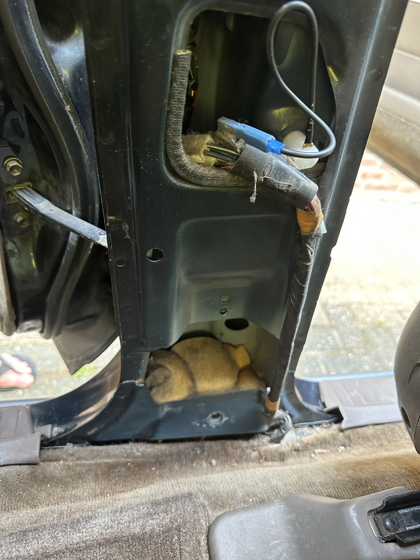

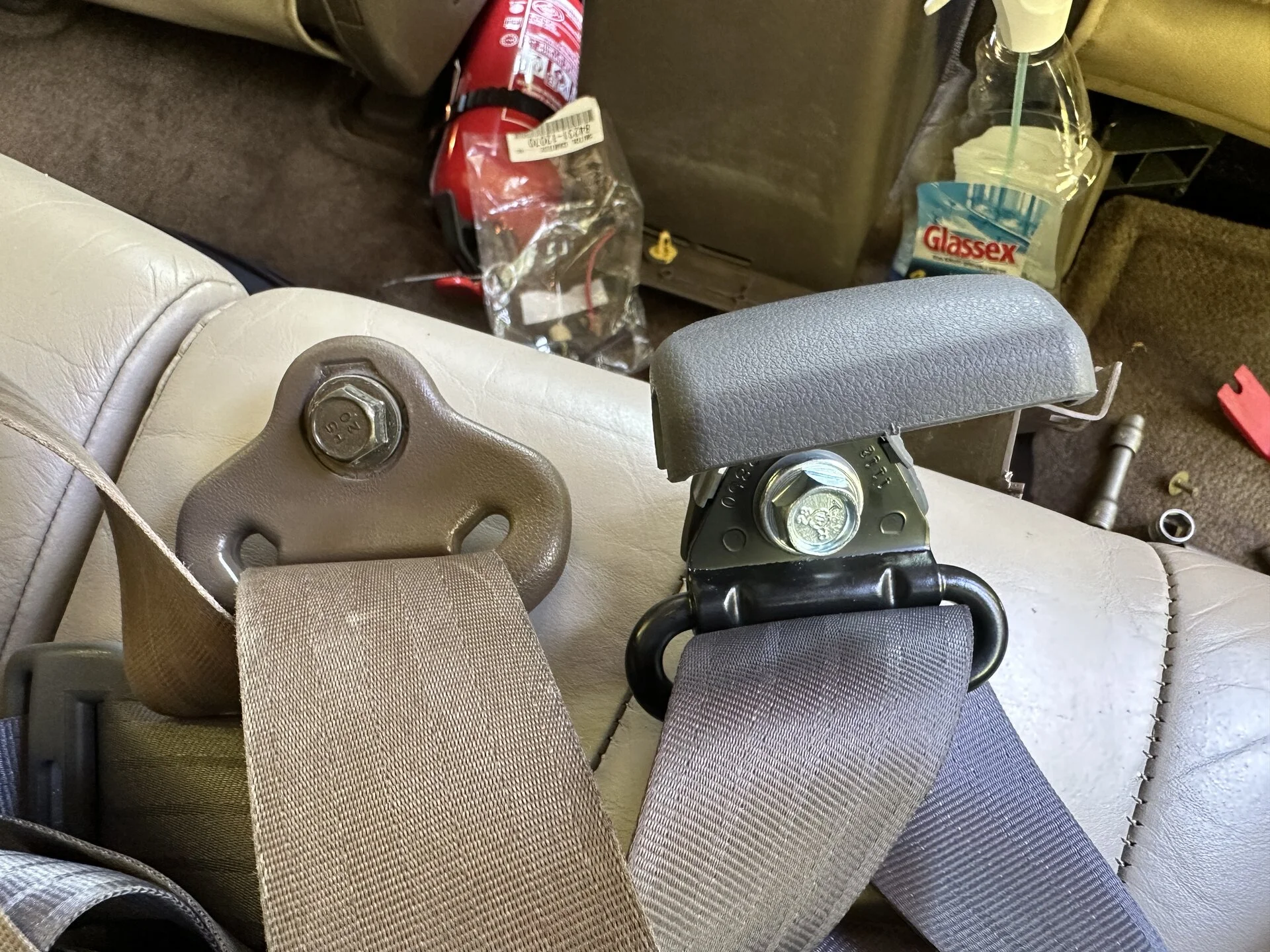

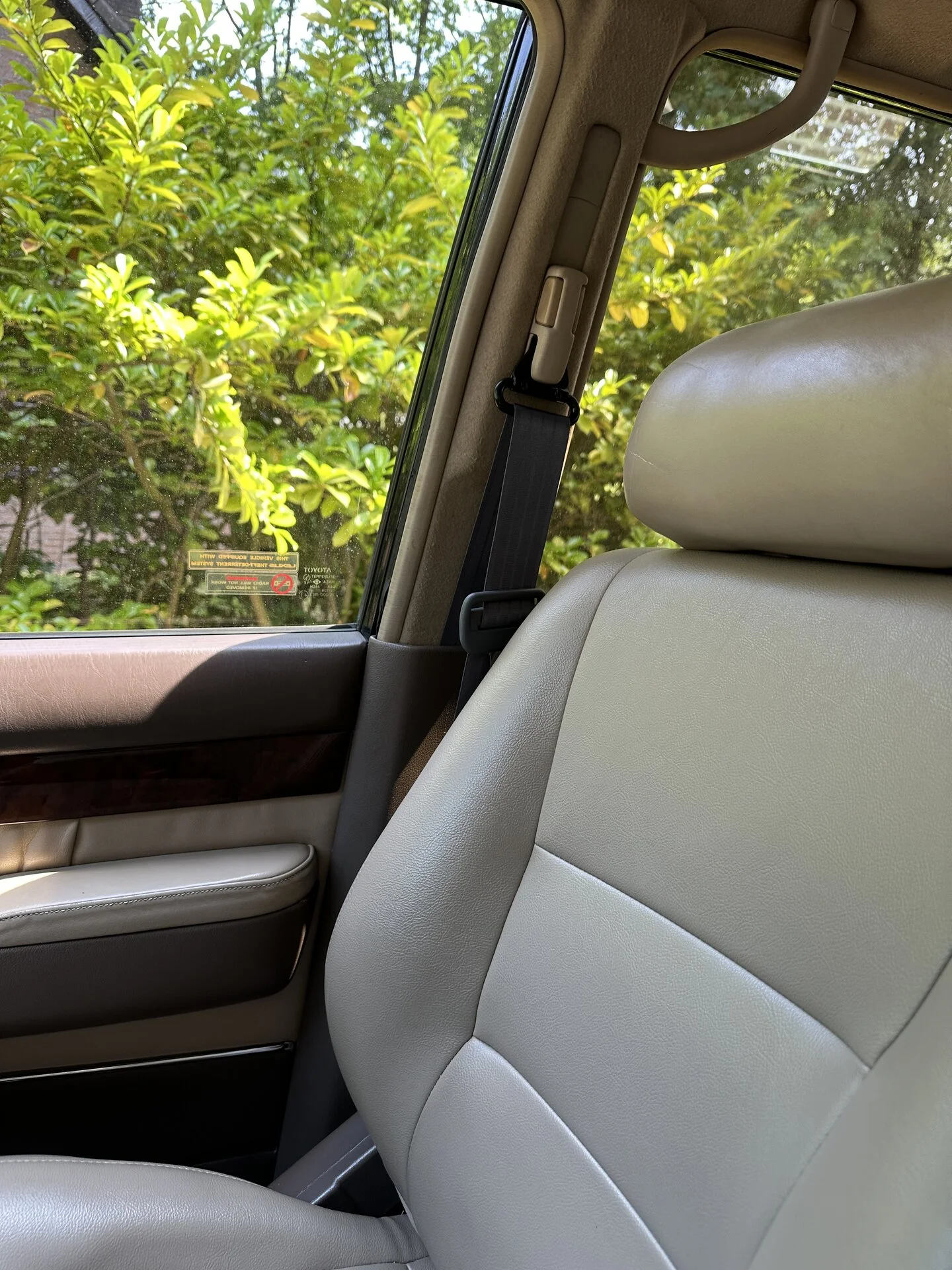

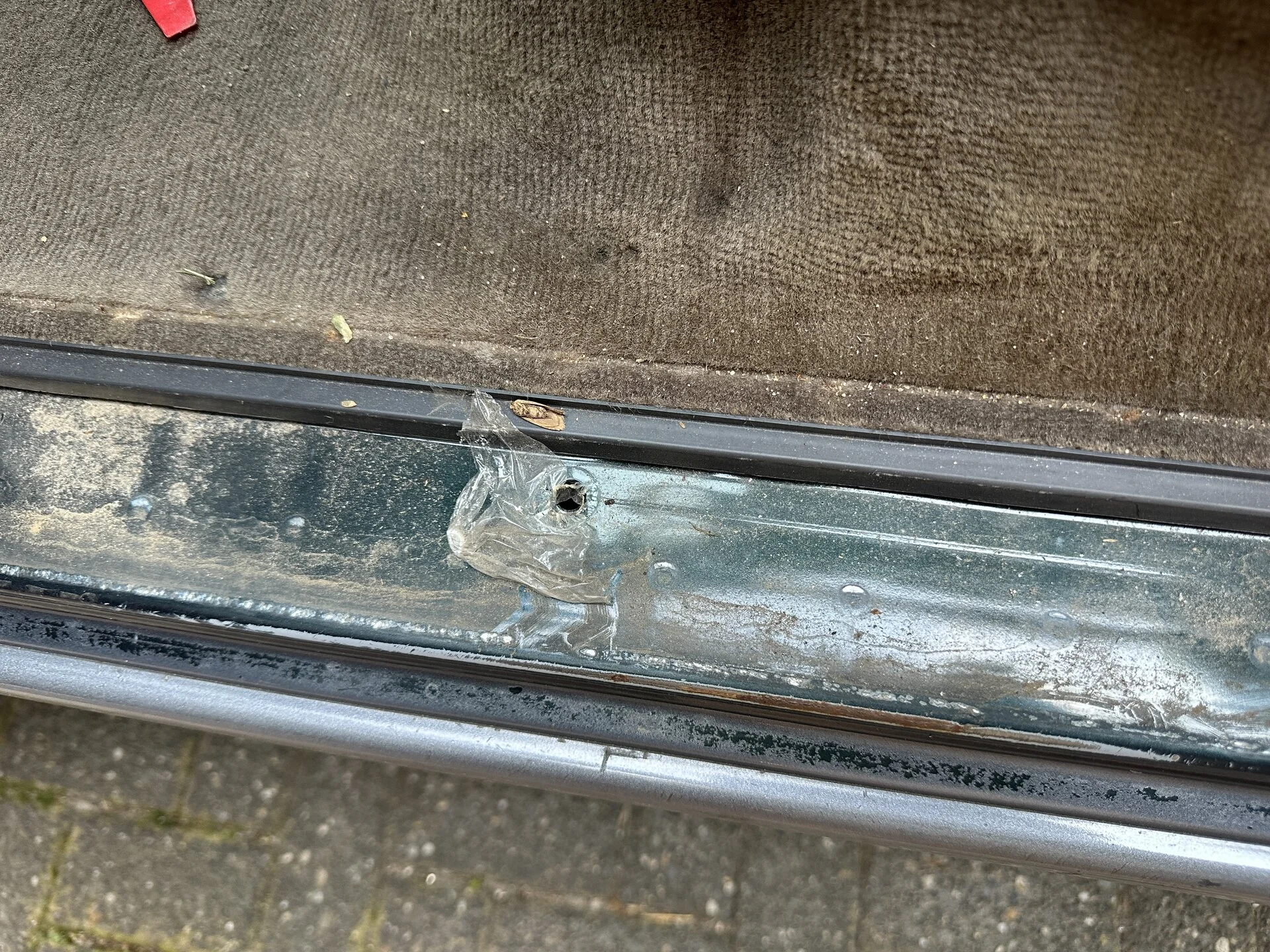

Then the new seat belts arrived which I had ordered a while ago. The original ones didn't retract properly anymore and the buckle of the passenger side was broken (the plactic has become to brittle. So I didn't bother trying to rewind the spring a bit more and just got two new ones, unfortunately they where only availble in grey and from a HZJ80 on the passenger side, so they look slightly different:
Eventhough the look is a tiny bit off, they feel amazingly smooth compared to the old ones and its refreshing not having to check if they are not between the door and the doorjam constantly.

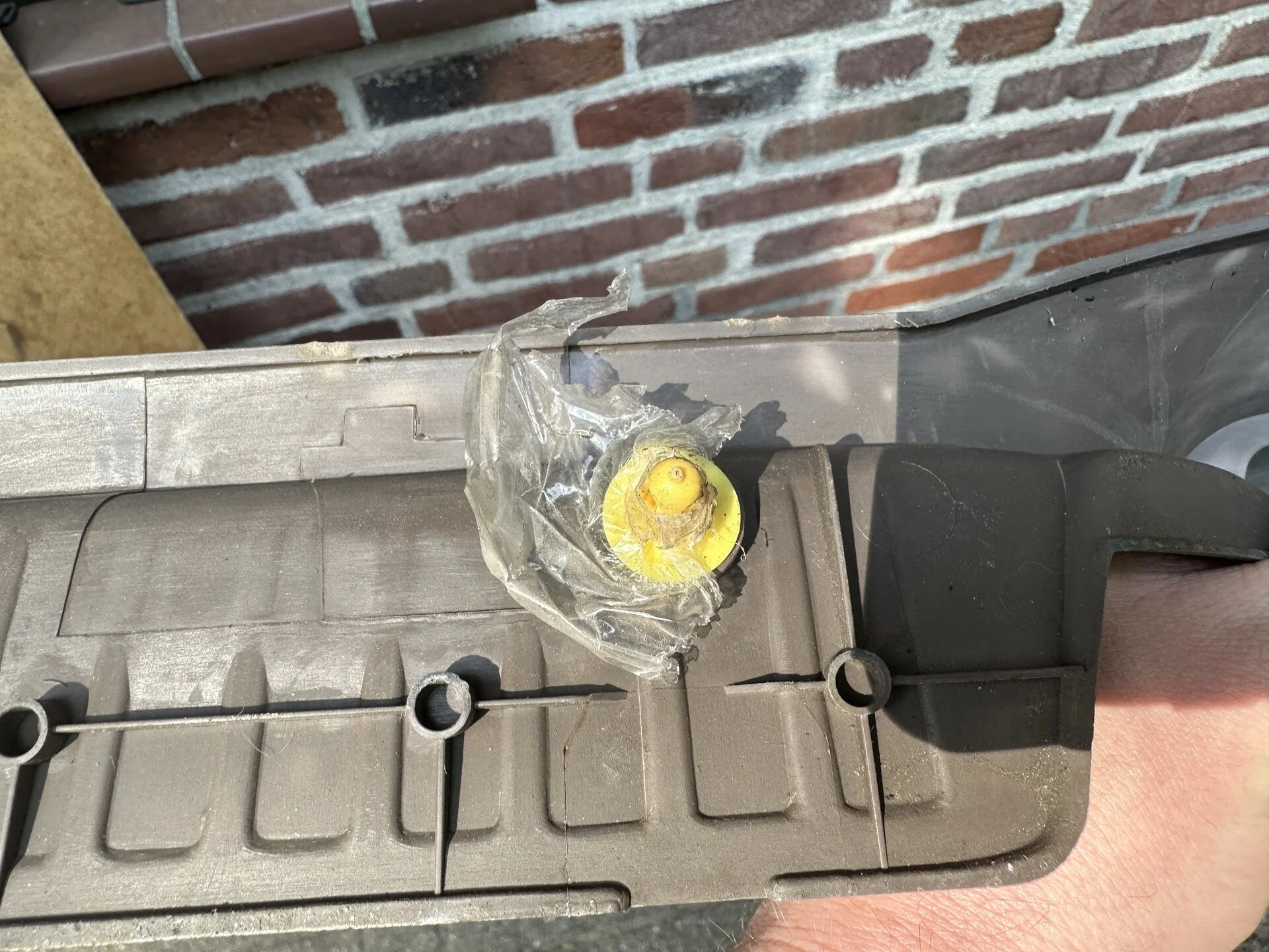

When installing them I noticed that the bottom of the pillar has foam inside, do all of these have this, it doesn't look like the most professional job so I was wondering if it has just been done by the PO.
It was nice to see that not much of my car has been messed with before, there are multiple panels which still have pieces of the original cellophane underneath:
Overal I was quit happy with the end result:

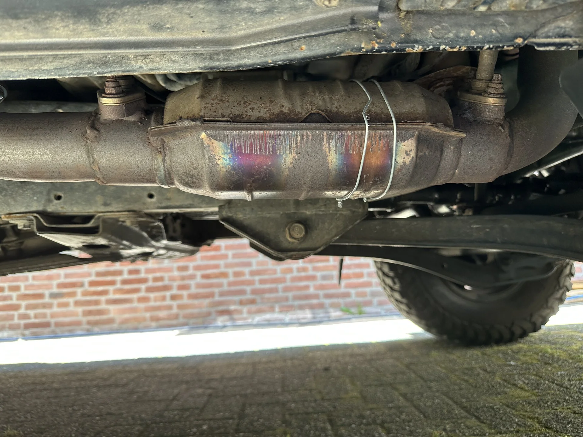

Next up was a very anoying sound, for documentation sake in case it helps someone else in the future it happened mostly around 1350 RPM, but also at a few other RPMs. The sound was a scratching sound like there was a stone jammed between the brake disc and the disc shield. It only happend during acceleration and not while coasting/deceleration.
So the search began, first I took the heat shields of the exhaust manifold (mostly because the local LC specialist said it could be a heat shield) but with no result. I have ordered some new ones though because while taking them off I had a good look at them and they are munted. Cracks throughout, some of the mounting holes are bigger than the pillar they bolt to etc. So they should come in a month orso.
Next I changed the A/C idler pulley, it didn't solve the noise I was looking for but it was due time too, the bearing was comepletely shot and it idles significantly more silent now.
Then I discovered some play in one of the front driveshaft u-joint so I wanted to go for a drive without it to see if this causes the anoying sound. This seemed like the perfect excuse to install a CLD switch since i've had it on the to do list but never made time for it. Gladly they had it in stock so I stuck it in and did the 7pin mod at the same time. I didn't make much pictures because it is wel documented already.
Unfortunately this didn't resovle the annoying sound so I just stuck the driveshaft back in and will get the u-joint changed during the next inspection.
After frustratingly banging everything below the car with a rubber hammer to try find the noise :deadhorse: eventually I figured out it was the cat shield. So I did a very professional wiring job until I can borrow a welder for a minute somewhere to tack the bugger back to the cat. I am a bit disappointed with the quality here though because the cat is about two years old. So maybe I just got unlucky but I was expecting more from OEM parts. In case you are wondering why the cat looks like this, I changed the exhaust system 2 years ago and simultaneously went to a single cat which is actually tucked in far enough not to drag over rocks.
