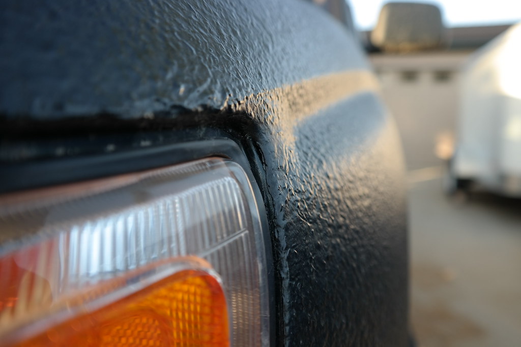

I used Monstaliner that was color matched to my original color after I rolled my 4runner. It turned out great except where I sprayed over some touch up paint. Those parts have started to peel up.
Here is a picture showing the texture as well as where it started to peel.

My clearcoat was shot before the roll so doing this made a lot of sense. There are 30 pages of my rebuild there, and I am still not back to 100%. I will be selling her soon to move on to my LX.
It is a roll on product but must be sprayed if color matching. If you are going with one of their colors, you can roll it with great results.
I am extremely happy with the product and will be using it on bumpers and such in the future. It is good stuff! I know some others on mud have used it as well.
