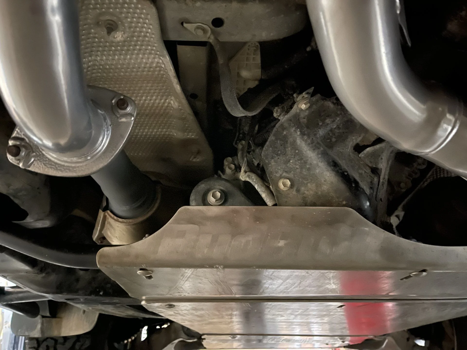

This is what it looks like right now. I’m pretty sure I followed all the install instructions. From pics I’ve seen other after market skids leave the same parts exposed to the exhaust pipe.

Yeah, that was something we looked at. Here is how my truck sits now, I grabbed this quick picture when walking into the garage a second ago but we got to talk about some background stuff with this picture.
So Bud put a couple temp sensors on the plastic actuator body itself, both with the heat shield and without it. What we found in mine was indistinguishable ranges between when the heat shield was on, and when the BB skid was on. But... we found a very slight increase in temp when the factory cage had its bottom cut out of it to keep the heat shield with a BB transfer case heat shield. Weird right? I wasn’t expecting that. So that’s why I never mentioned to anyone or put in the instructions to modify the factory cage to keep the heat shield.
The reason why the factory heat shield is back in mine, is because my entire exhaust is coated in jet hot. Jet hot 2500 (the reason it is a kinda gunmetal look) on the headers and mid pipes with jet hot 1300 on the muffler. So for my own person testing, and the fact that I have endless factory t case cages around me, I tested both with and without a heat shield again. No real change with it with or without this time around, but I have a bit over 55ish% overall drop in under body temps because of what I did to my exhaust. More or less up and down the trans tunnel.
I hope that helps shed some light on the reason why we did this approach we did on at least this aspect of them.

While Taco2Cruiser responded, I was in the garage creating a bracket and installing the original heat shield. Once I finished I realize my solutions was flawed since I have one part of the shield fastened to the skid plate and other to the transfer case. But the transfer case is on rubber mounts, so there will be movement between the skid plate and the case. Plus Toyota heat shield is only on one side, which is 5 inches away from the exhaust, yet the wiring is 7 inches away on the other side and remains exposed. Heat shield wrap around the exhaust pipes is probably the better solution, if one thinks there is a problem.
