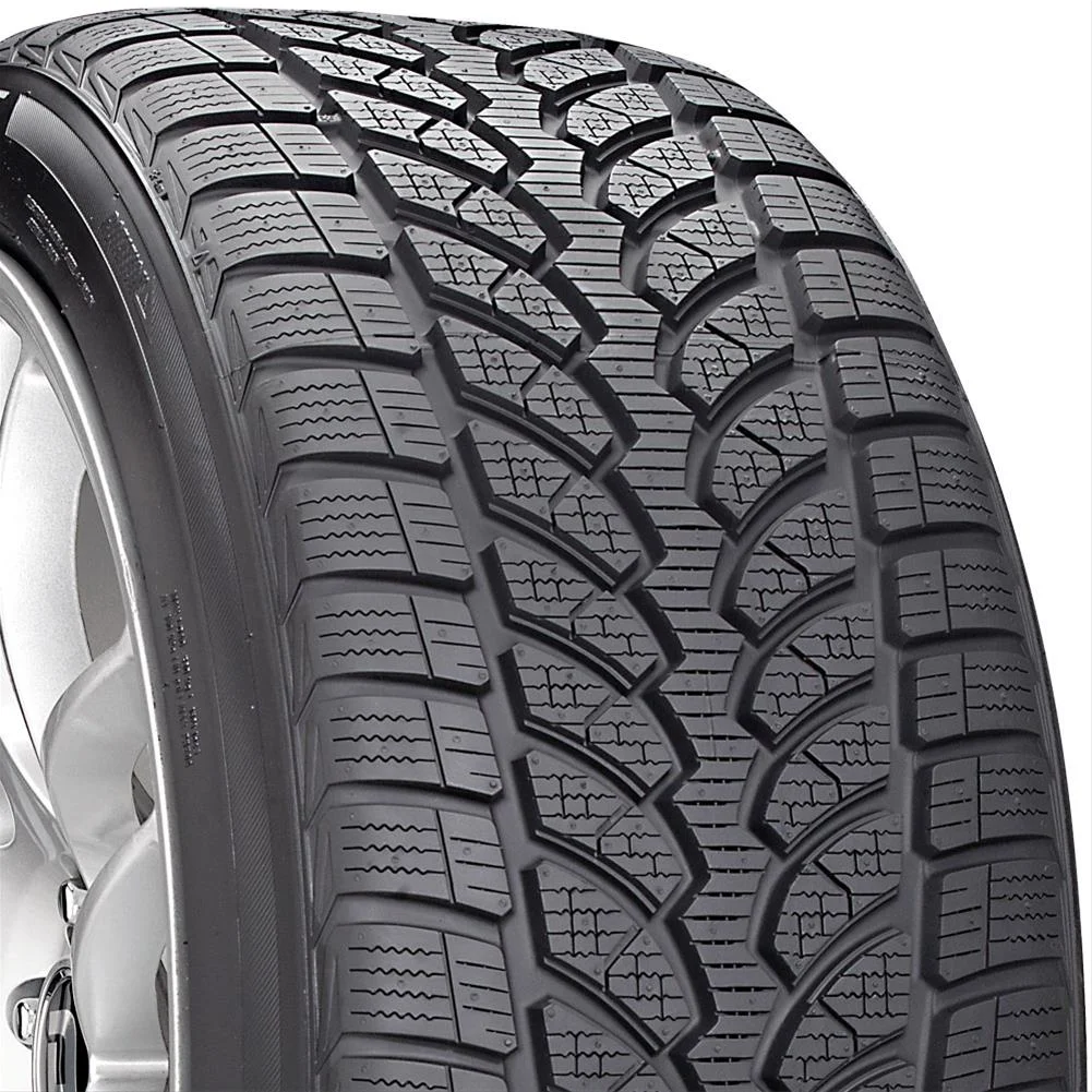

Tests have shown Blizzaks outperform steel studs. From what I have seen, I'd believe it, and Colo roads are already destroyed and don't need help from studs.

Bridgestone Blizzaks are industry leading to be sure. The only other brand I am aware of that comes close is Noikan Hakkapalitas. Very impressive tires. My understanding is the secret ingredient is soft rubber, and special siping that is actually designed to trap snow to use as a friction enhancer. For this same reason they are actually not ideal rain tires, all season and summer tires tend to have superior rain performance as tread deaign is more dedicated to acting as an aquifer channel for water displacement.
Winter tires are designed to work best under 40°F ambient temperature
Winter tires without studs are best on snow and great on pavement
Winter tires with studs will do best on pure ice and actually not great on pavement.
All season and summer tires will perform better in rain/standing water, even more so above 60°F
US driving conditions its exceedingly rare you need studs. If you needed them where you lived youd have used them last winter like everyone else in your town does every single year.
