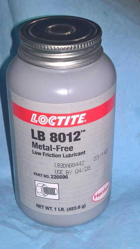

Swapped clicking/worn birfs side-to-side in my 96 model 100,000 miles ago, still running, no clicking but then no off-road driving so less stress on those Birfs. What may have helped is that I added a very high percent Moly (Molybdenum Disulfide) paste made by Honda (60% Moly) meant for motorcycle driveshaft splines mixed with Valvoline Palladium 3% Moly grease.
Unfortunately that specific Honda product is no longer available but a good substitute IME is Loctite LB 8012 which has 65% Molybdenum. IME the LB 8012 is compatible with Lithium Complex greases and can be brushed heavily inside the cup or bell of the Birf (or mix with grease before you pack the Birf). It also can be brushed onto the splines of the CV joints (Birfs) as well as on the spindle bushings followed by whichever grease you're using for the knuckles.
FWIW

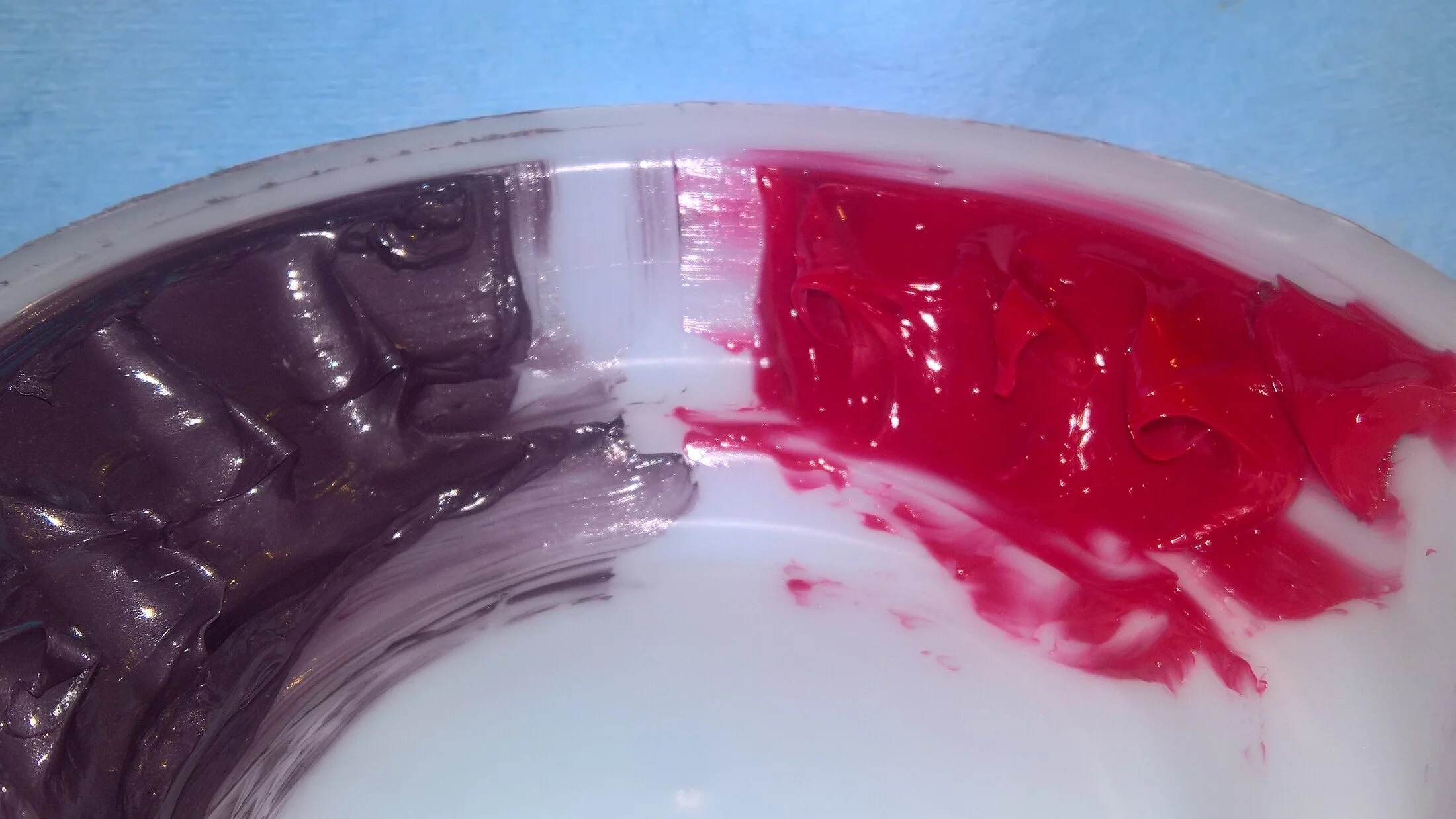

FWIW here's a photo of my Frankenstine Moly grease. I mixed (Mobil) Mobilith SHC 460 synthetic PAO grease with the LB 8012 (roughly~8-10 parts grease to 1 part Moly), stirred very well repeatedly, then using a flat stir stick pulled the stick straight up which formed peaks of grease. Then put the bowl above a warm surface (~110'F) and let it sit there for a week. The grease did not slump or separate so I called it a good (enough) test of compatibility. Have used it for Driveshaft splines also.
Mobilith SHC 460 on the right, Mobilith SHC 460 mixed with LB 8012 on the left after sitting undisturbed for a week:
