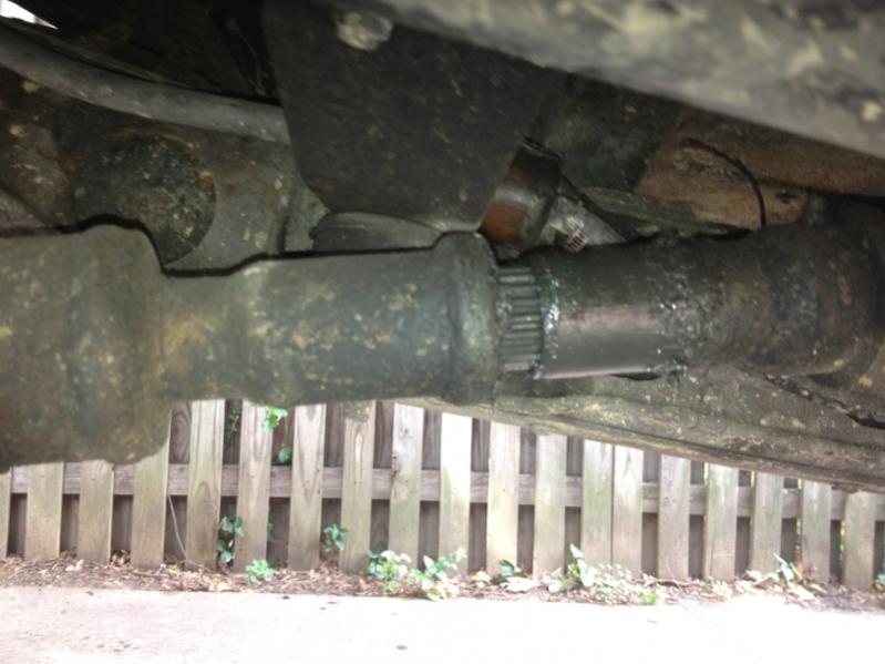

Driveshafts
Thats extended or flexing

You can reinforce the splines by cutting ~inch of outer spline from a junk shaft and welding it to the end of your good shaft. The ends are already tapered so you can butt them together and weld in place using the inner shaft as a fixture. Although it's still a PIA to keep the alignment straight. It took me several tries. I have extended both my shafts this way.
You also have to ditch the dust cover and replace it with a shock boot.

Ya you need extend them. Should not be much maybe 2 inches if you are not shackle reversed. You need a new long travel one if you are shackle revealed .
Charlton, that's a great option as well! I may do that with my drive shafts.
Just don't make them too long or they'll ruin your nose cone/xfr on compression.
