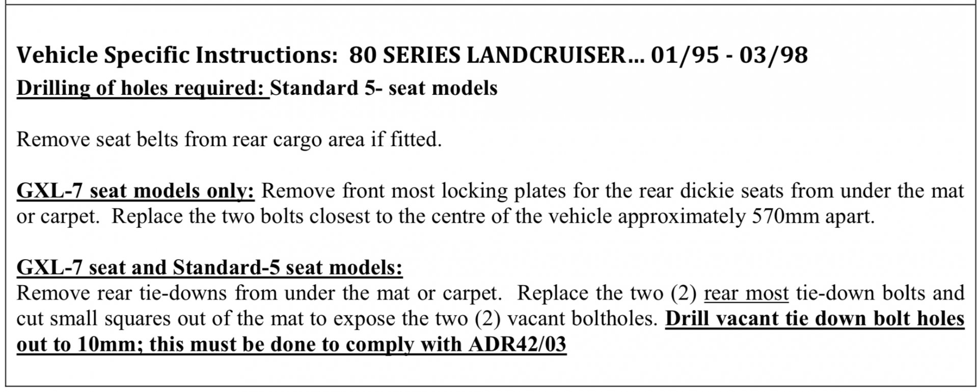

Hey all - installing a single ARB roller-drawer into the back of the 80...was thinking this was a simple bolt in using the existing 3rd row holes (where the locking plates are), however that only appears to be the case for the forward mounting location while the instructions indicated drilling is required for the aft-most mounting location? The instructions are a little confusing as well since it seems to indicate that drilling is only necessary for 5-seat models but then the diagram and directions go on to say drill a 10mm hole to install the rear “B” mounts for both 5 & 7-seat models. Posted wording & diagram below, just want to confirm before I start drilling...Thanks all!

Not gonna lie - these instructions suck.
So the online document on install gives 2 conflicting spacer sizes for the 80 for hat position A :
I assume this is 5 seat vs 7 seat - The paper instructions that came with the drawers agree with the 15mm spacing for hat position A for the 7 seat. However it says you don't remove the decorative trim strip - which the above from the online docs says to remove in both cases.....
The online docs say you only need to drill out the 2 holes that are where the tie down mounts were - the paper docs say to drill out all 4 mounts to 10mm.....
I suppose it'll become clear as I start the install - I'll post back here with my findings to clear it up for the next poor bastard....
