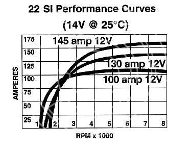

Aside from any component limits and cooling issues, I'd also make sure to look at the alternator output curves to be sure that the added output is actually in a usable RPM range. Just like an engine, some of the high power alternators only reach that peak power at high RPM's. If you need power at idle, for something like winching or running other items at camp, then having a high peak output isn't much of a benefit and could be a disadvantage. Personally I would prefer an alternator that outputs the most current at idle, because that's when I would probably need it the most.
This is just a random alternator output chart I found on the web that illustrates the point, I don't know if you'd be able to find something similar for your particular alternator. If your engine idles around 600-700 RPM and you have a 2:1 crank/alternator pully ratio, then at idle a 100amp alternator would be spinning around 1200-1400 rpm and putting out ~75A at idle, while a 145A alternator would outputting 0 current. It's not until after 2500 rpm (alternator RPM) that you'd begin to see an advantage to the higher output alternator.
Thanks for the info. I think no matter what size alternator I get I am sure it will be fine doe my rather small loads. The original alternator would work fine at 60 amps. But if I am going to have it rewound. It will cost the same amount for me to wind it at the original 60 or go up a certain percentage. I haven’t found out what that is but to be honest it really isn’t important. I have been wondering if there are any other parts in the alternator that would be placed under increased stress as a result of a higher current wind. If it doesn’t affect any part of the alternator then I would just give it as much of a boost as possible just for possible future modifications.
