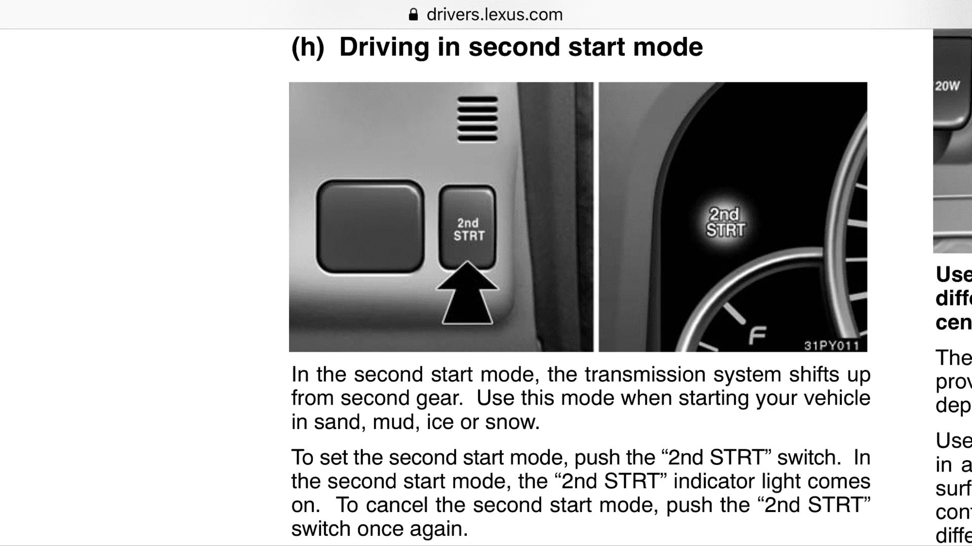

You might try the "2nd Start" button to switch between 1st and 2nd so you don't wear out the linkage. I find it useful because 1st is such a granny gear.
Does that button work that way? My impression is it allows you to start from a standstill in 2nd gear to avoid wheel slippage...?
I'm not positive it will shift on the fly, but it won't hurt to try. I use it at long red lights because 1st tends to pull through the brakes at idle without really firm pedal pressure. (600 rpms). I hate to constantly pop it from neutral to drive because of linkage wear.
The manual seems to indicate that 2nd start is to prevent wheel slippage in mud, sand, ice or snow.
If you do second start it just allows 2 to be the first gear vs shifting from 1-2. That's it.
Yeah. After I thought about it some more, I realized it wouldn't help shift back and forth downhill.
