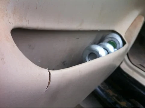

So for the last two years I've carried 4-5 screw pin shackles in my drivers door compartment. Ready for immediate use. I never liked this arrangement for safety issues but now am abandoning it all together. Te compartment is not designed for the weight.

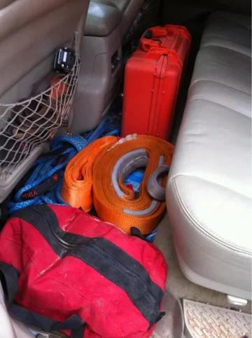

Ill be moving everything to the back seat footwell directly behind me where the rest if the recovery gear is.
I really want a footwell storage box to keep things safe in the event of a rollover. My kids won't touch the floor for several years so I don't really need the space. Anyone have any advice.
This is my current back seat mess. Recovery bag (40-50lbs), tree saver, winchline extension , recovery strap and EMT kit/ dog pedestal. If I could get a form tired box for all or most if this I'd be all over it.

I use a milk crate and carry my hi-lift base, tow line, snatch strap, tree saver, winch remote, gloves, 3 d-rings, jackmate, and a snatch block that doesn't really fit. I usually keep it in the trunk but I suppose it could fit behind the drivers seat. I am 5'11" and seated the way I drive, I can definitely place it behind my seat.

Loud and I talked last night a bit and we might be working on a home brew solution. Some hurdles, once consideration that I feel needs to be addressed is that seats in vehicles are designed to break at the pivot point and colapse backwards/flat in the event of a severe rollover that pancakes the truck. This is something I would like in any design, so I'll be incorporating an angled front to the box.

Good to see you last week, Jon. Soon you will need that space for soccer balls, lego's, american girl dolls, and such. Bummer about the door pocket.
You could do a flat box that picks up the two front seats bracket bolts and the 2nd row hinge to bolt it down pretty easily.
That was the idea, but making the compartment somewhat of a trapezoid to give maximum clearance for the seat, and still keep as much cubic space inside. Put a latch on it and a hinge for the top and should be good to go. For $650 you know you will be getting the highest quality box Harris can provide. He'll even throw in some eggs & a hen.
Or, just do a flat latch plate that picks up those bolts and then a pelican case with opposite latches on it. Kinda like a fridge slide lock thing. Then you can remove the box if you are carrying a passenger or want to show off all your recovery gear at a moment's notice.
Throw some anchors in the floor pick-up truck style and use straps to hold down pelicans or similar. Maybe some Logic trac or other removable anchors that would allow for quick re-configuration and growing children?
