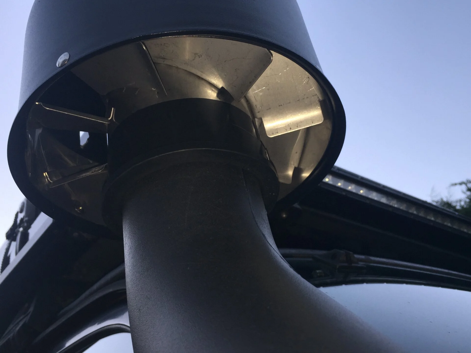

I run a Top Spin HD. It’s an all metal unit and actually a bit heavy for the standard Safari snorkel. I had to swap out the A pillar square plastic screw nuts for Nutserts as I had the screws shear out on a trip. Other than that, it does a great job at keeping my air box clean, as well as the tuna can. I can’t remember the part number on the one I went with. It took a bit of research. I think I am running a rubber sleeve between the snorkel and the pre cleaner so it may be a 4” inlet diameter. Similar specs to a Sy-Klone 9001.

I run the larger Donaldson cyclonic filter on my 80, started with the smaller version, but didn’t like the “swoosh” noise it created and switched to the larger version. I find it very effective for catching dust before it enters the filter housing,
which I think is the biggest (only?) reason that I have a snorkel.

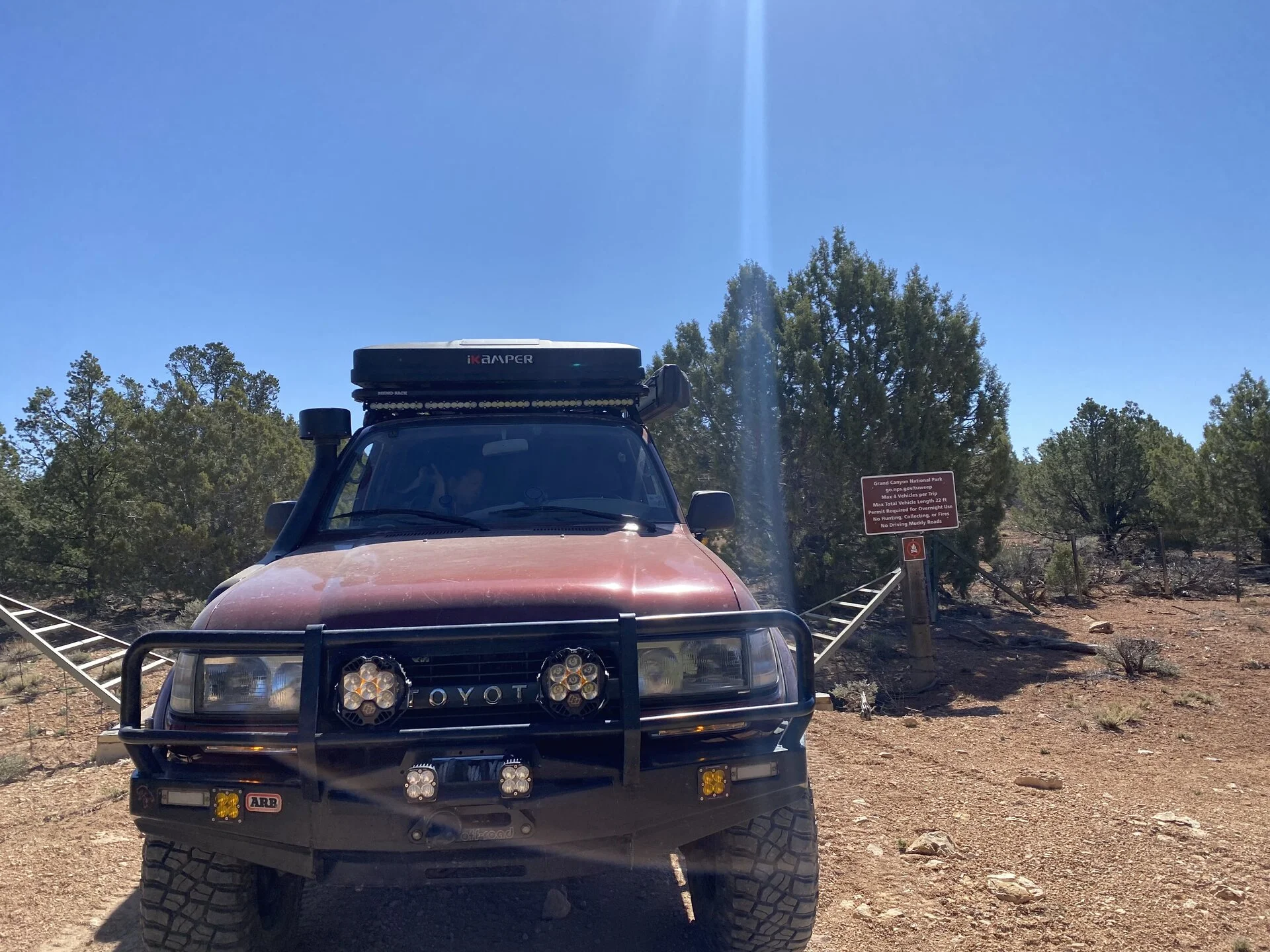

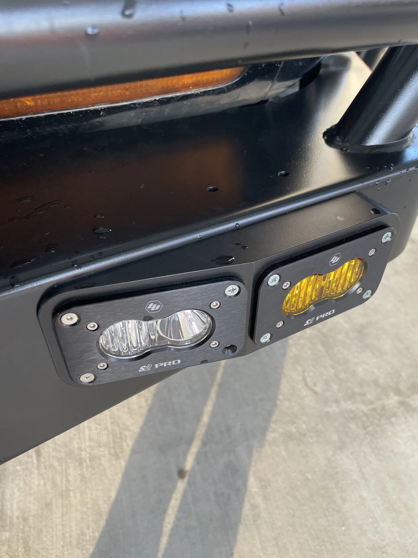

OT but how are your fog/amber lights on ARB setup? Is it a mount they are on?
They are the Baja Designs flush mount versions mounted in an angled housing to help compensate the angle of ARB bumper that a friend designed and machined at his manufacturing company.
