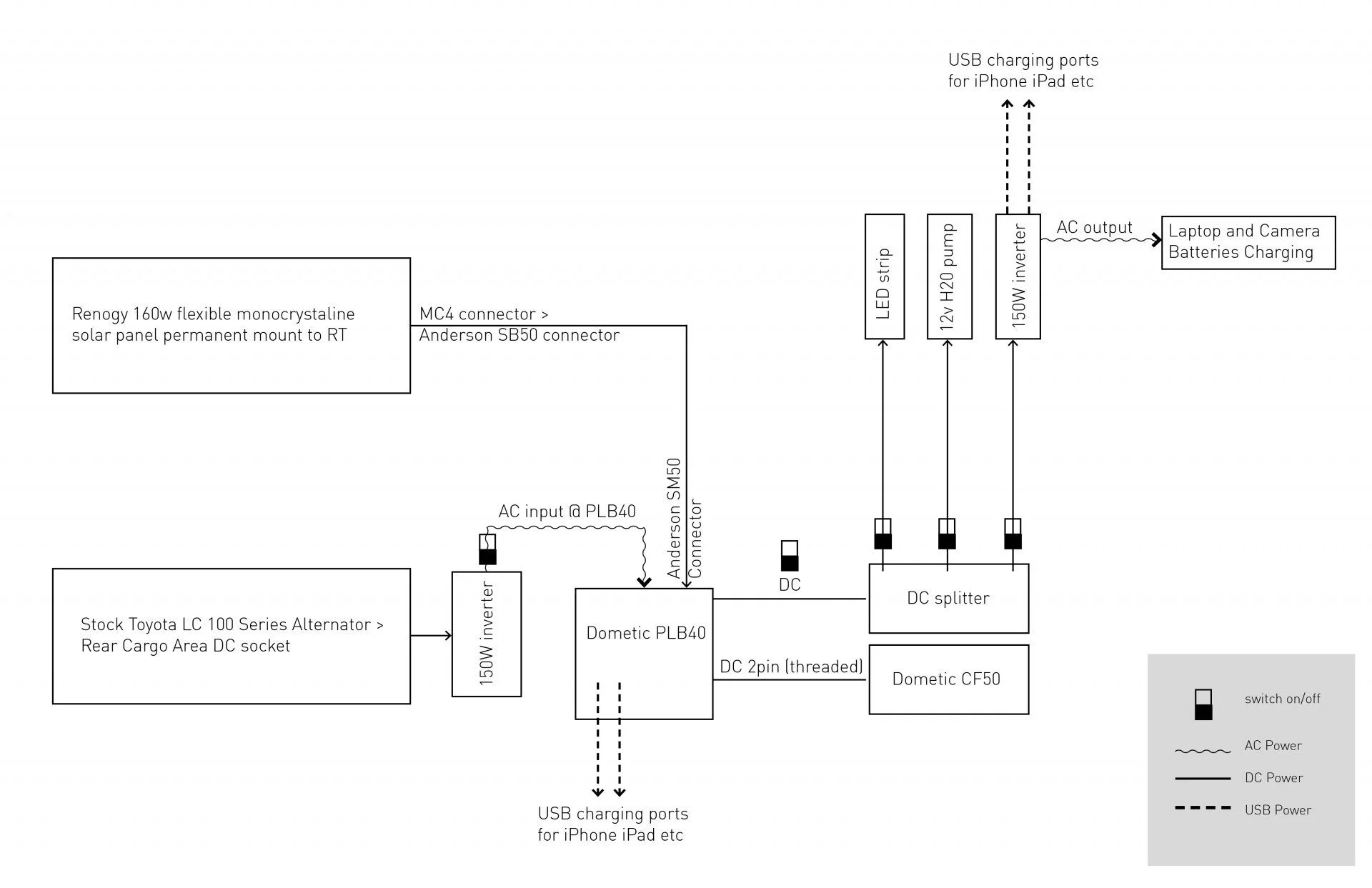

So here's the plan. If anyone on here has some advice, please post! The goal is to have everything hooked up at all times and control each piece with the switches that are already part of the unit. No fuse box or distribution network for DC. Just rely on solar and alternator charging and the PLB40 as the main storage/power source when the car is not running. One main thing I'm wondering about is hooking the PLB up to a 150w inverter off the rear cargo 12v socket and running it AC instead of running it directly into the socket and eating up the anderson connector (which is also the DC input) as I want to use that for solar and not have to swap every time I stop etc.
Electrical needs are: Dometic CF50 for fridge temps mainly (24-26F), Laptop Power for ~2hr/day, Drone/Camera Batteries recharge for ~30mins/day, (1) strip LED lighting for ~2-3hrs/day, iphone, ipad, garmin, 12v DC water pump for ~4-6min/day.

Does anyone see problems with this set up?? I've all the parts now, just going to mount and wire everything up!
The dometic CF50 needs to go into the 2 blade 12V threaded connector on the PLB40 but my cable that came with the fridge doesn't appear to have that threaded connection... I'll need to source a cable like that has that 2blade threaded end I think..

It didn’t have the 2pin. I was sad about that. I wound up buying a replacement cable for an arb that had it but spent 23$!!! I wound up splicing it with a coiled 12v adapter cord (like an old telephone) to work with the tilt/slide fridge set up. Not super happy it did not come with the 2pin threaded and I didn’t easily find a replacement part for it. I’m sure it exists.
