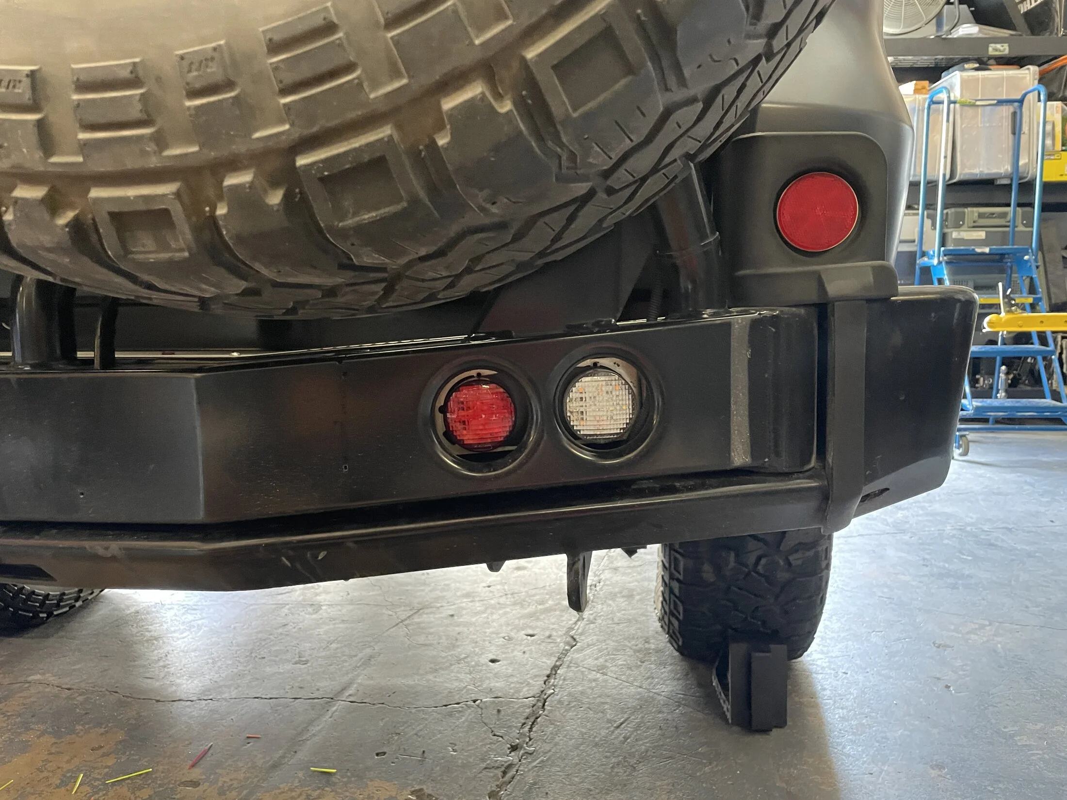

First is the finished product (Turn, Brake&Running, Reverse) look like:

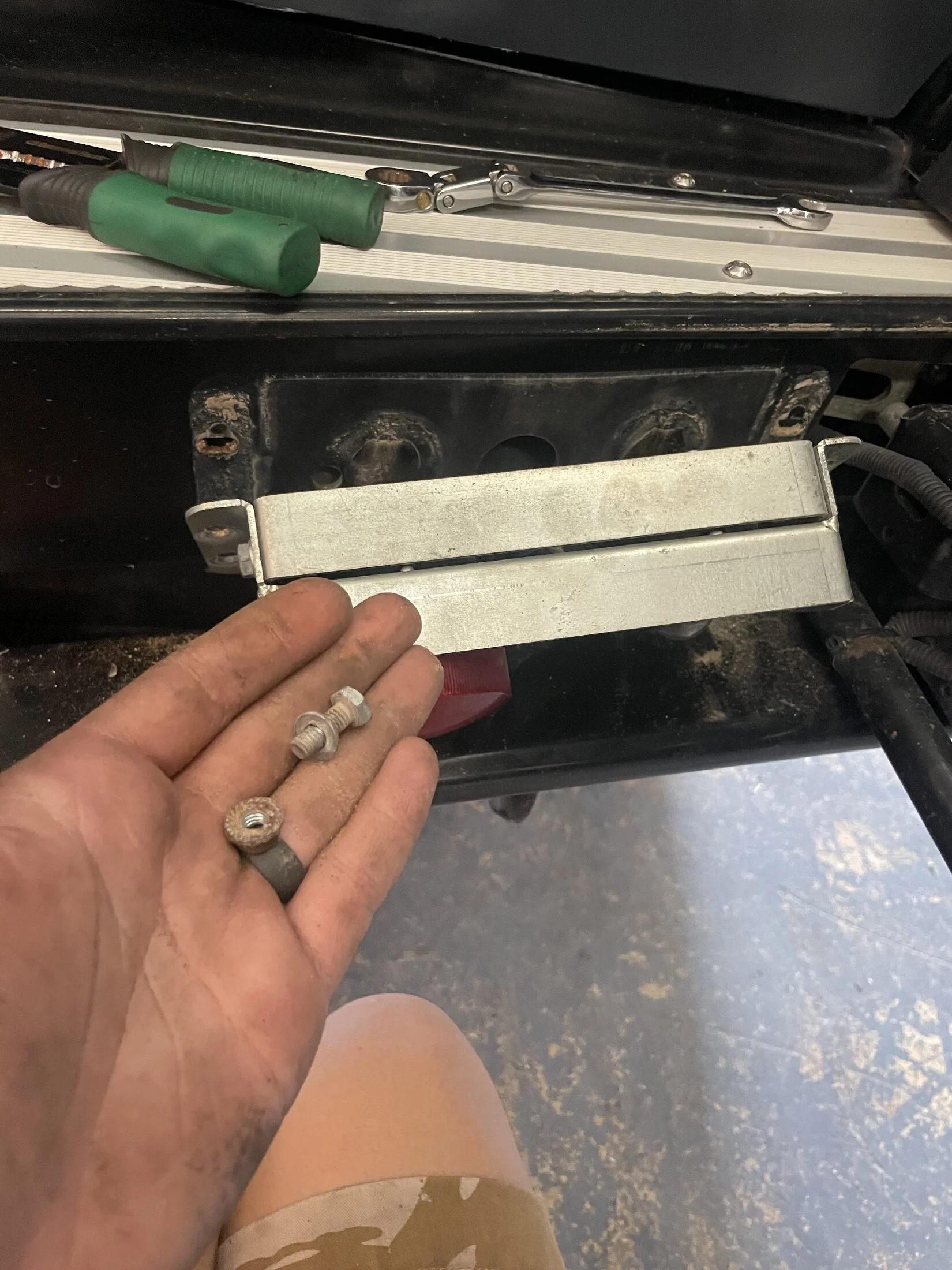

1. Take off 4x 10mm bolts that has a 10mm nut in the back, you might need a small 10mm wrench in the back
2. Depending on how you wired your lights, I decided to cut closer to the lights ( since mine is busted and I am not reusing it for any other purpose)
3. Use a phillip head to remove lenses and the rubber seal, 2 per lights

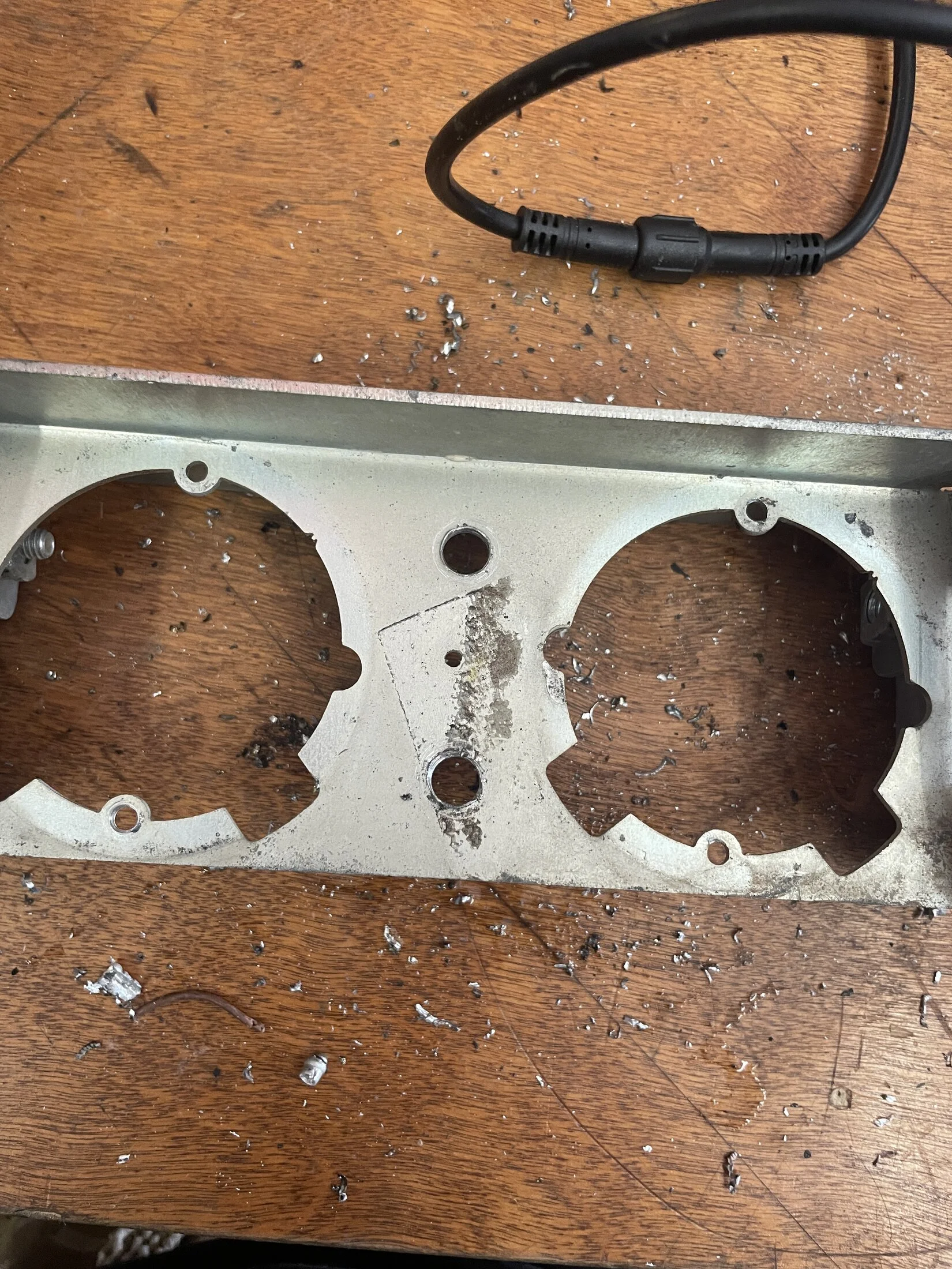

4. small drill bit to drill thru the rivet to remove the housing from the ARB light bracket.
5. Get your Dobinsons lights and put them on the bracket, line it as center as you can, mark & drill 2 holes in the center
Note this is for passenger side, I choose to remain ARB's way where turn & reverse lights is on the right and brake & running is on the left side (driver side would be reversed)
6. Get some bolts washers and nuts from store or your random parts bin, align and tight them up.
Note: To avoid fitment issue, 2 bolts in center need to be at similar length to the Dobinsons bolts that are on the lights.

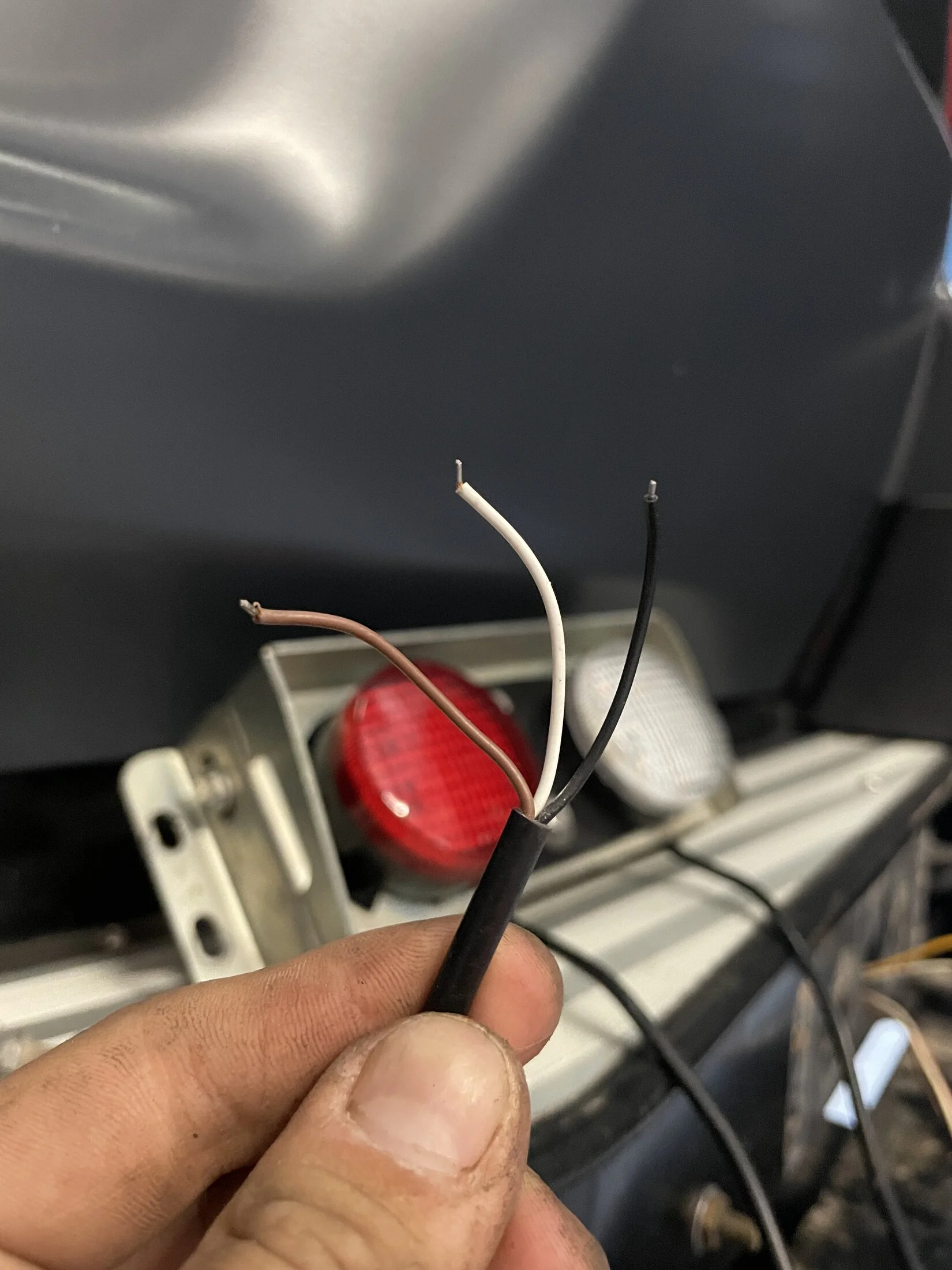

7. Back to your truck, reconnect all the wire back together.
7.5 I added an extra wire from my reverse light during the process, if you wish to have reverse function, you need to have this step
Note: On the Dobinsons lights
White Light:
Brown- Turn
White- Reverse
Black- Ground
Red Light:
Brown- Running
White- Brake
Black- Ground
8. Bolt the housing back onto the bumper, replace the bolts and nuts if needed, mine is rusted so i did. Then close the swing out to make sure it sits in the center of the cut outs. Adjust if needed.
9. Clean up the wiring with some zip ties and tapes.
Then it's the end of the little upgrade! From bulbs to LEDs..
