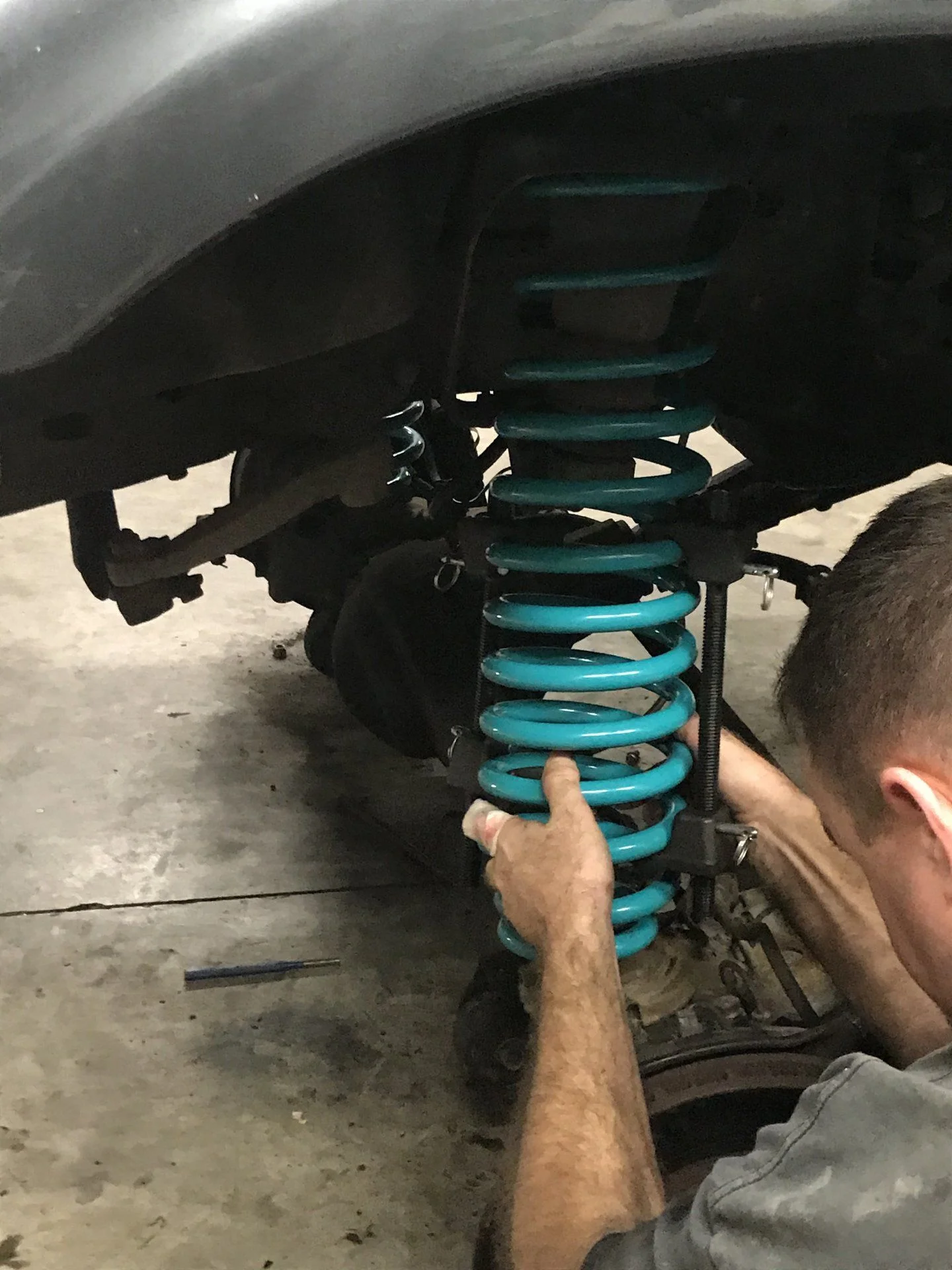

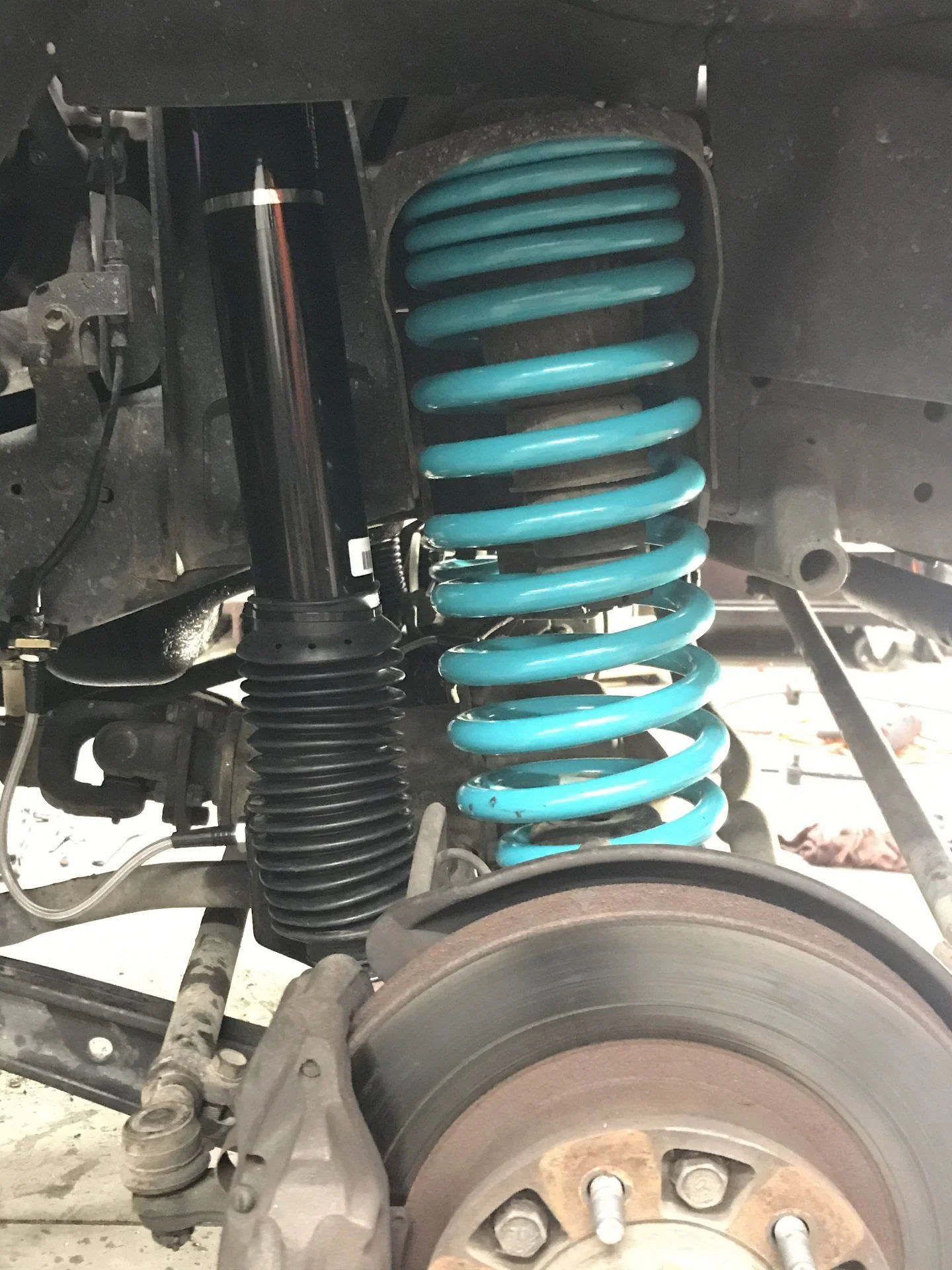

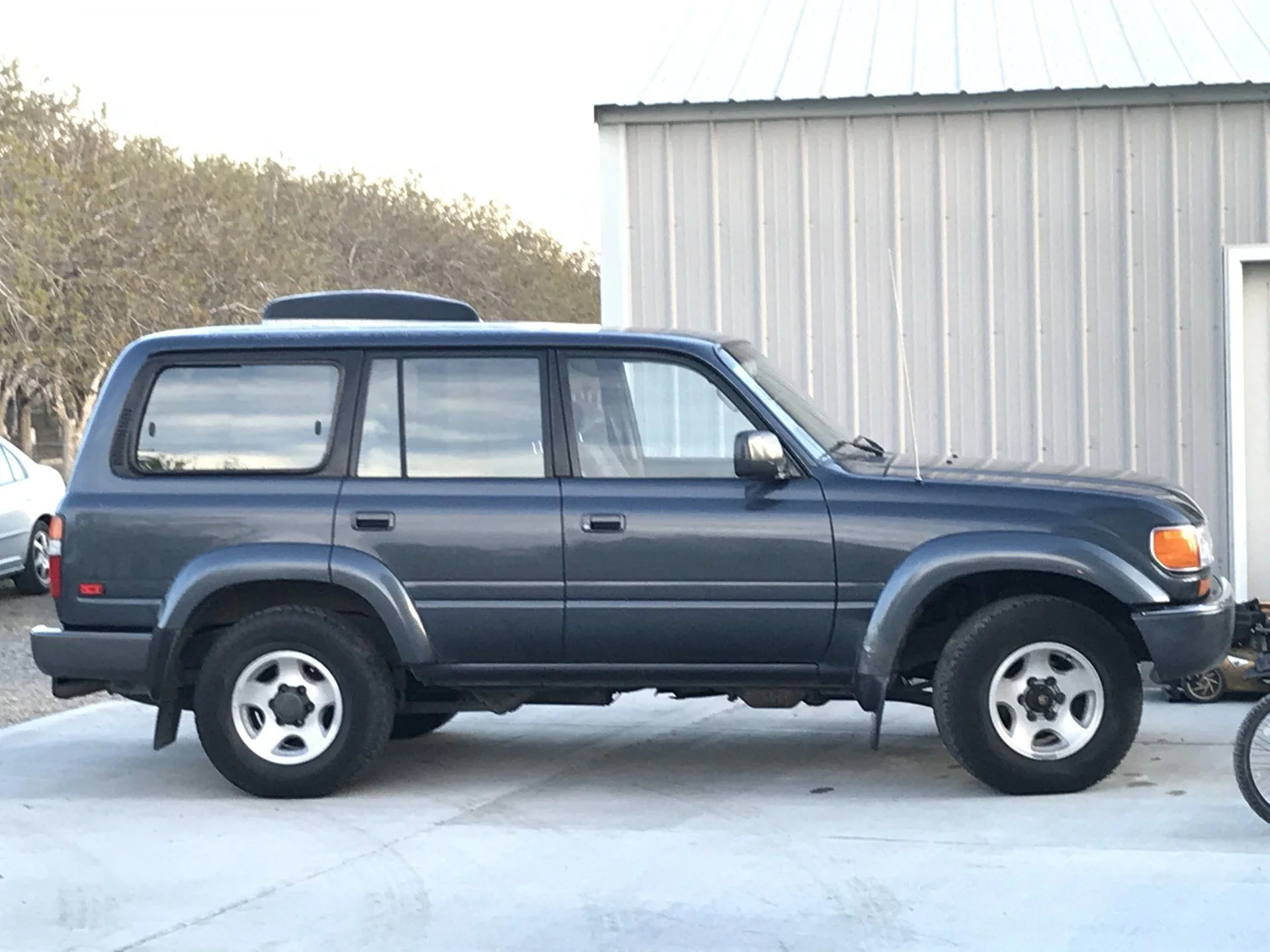

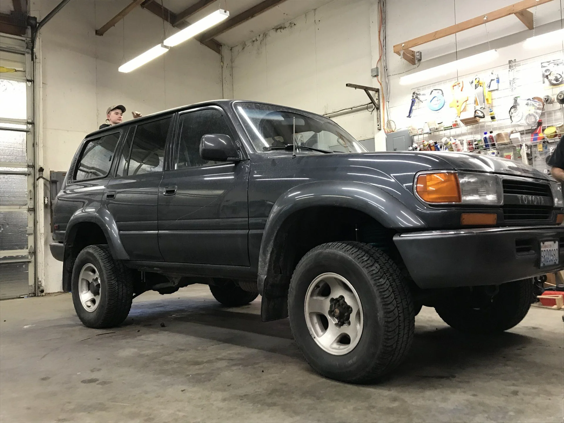

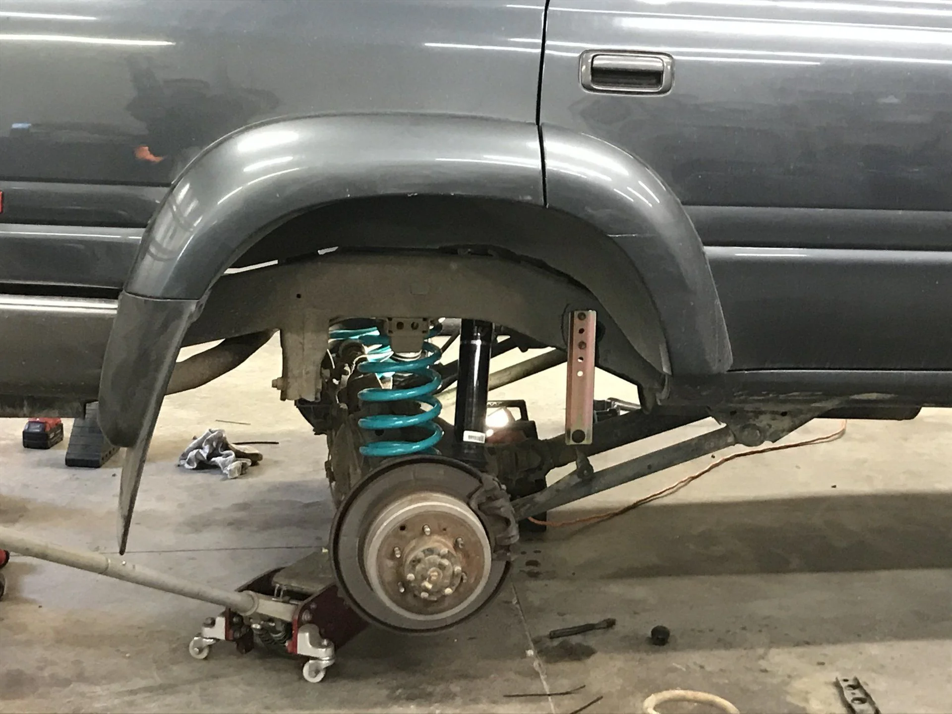

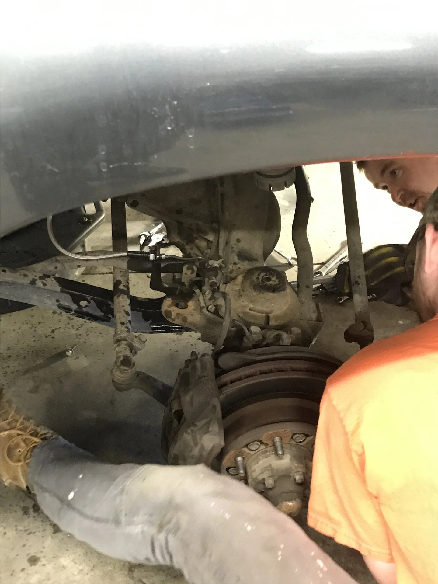

Here she is before and after the operation. Big shout out the Pascoscout for all his help and expertise! Install went great thanks to his expert help. More pictures to follow. After install measured 24” from hub to bottom of fender, 23 3/4 on one side. The springs were labeled correctly for US left hand drive application.
So far she drives great. There is a little body roll, but not enough that I’m worried about it. I don’t have any weight to speak of. Drives strait, no vibrations or drifting that I’ve noticed yet. This is the Dobinsons 2.5” tapered springs with 4” lift IMS shocks, castor correction bushings etc. planning to do the breaks and fuel filter next
