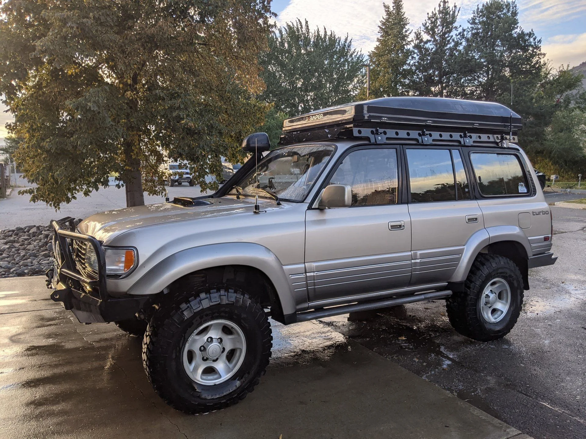

Thanks @crikeymike ! I would be totally ok with 23". Just don't really want it any taller than 24". The ride height in this picture is pretty well perfect. With my weight (7,000 without gear) would I be after these guys? And, are these all still "long travel"?
Rear: (3" REAR HEAVY)(C97-145VT) (or)
(3.5" FRONT HEAVY)(C97-144VT)
Front: (2.5" FRONT)(C97-146VT)
