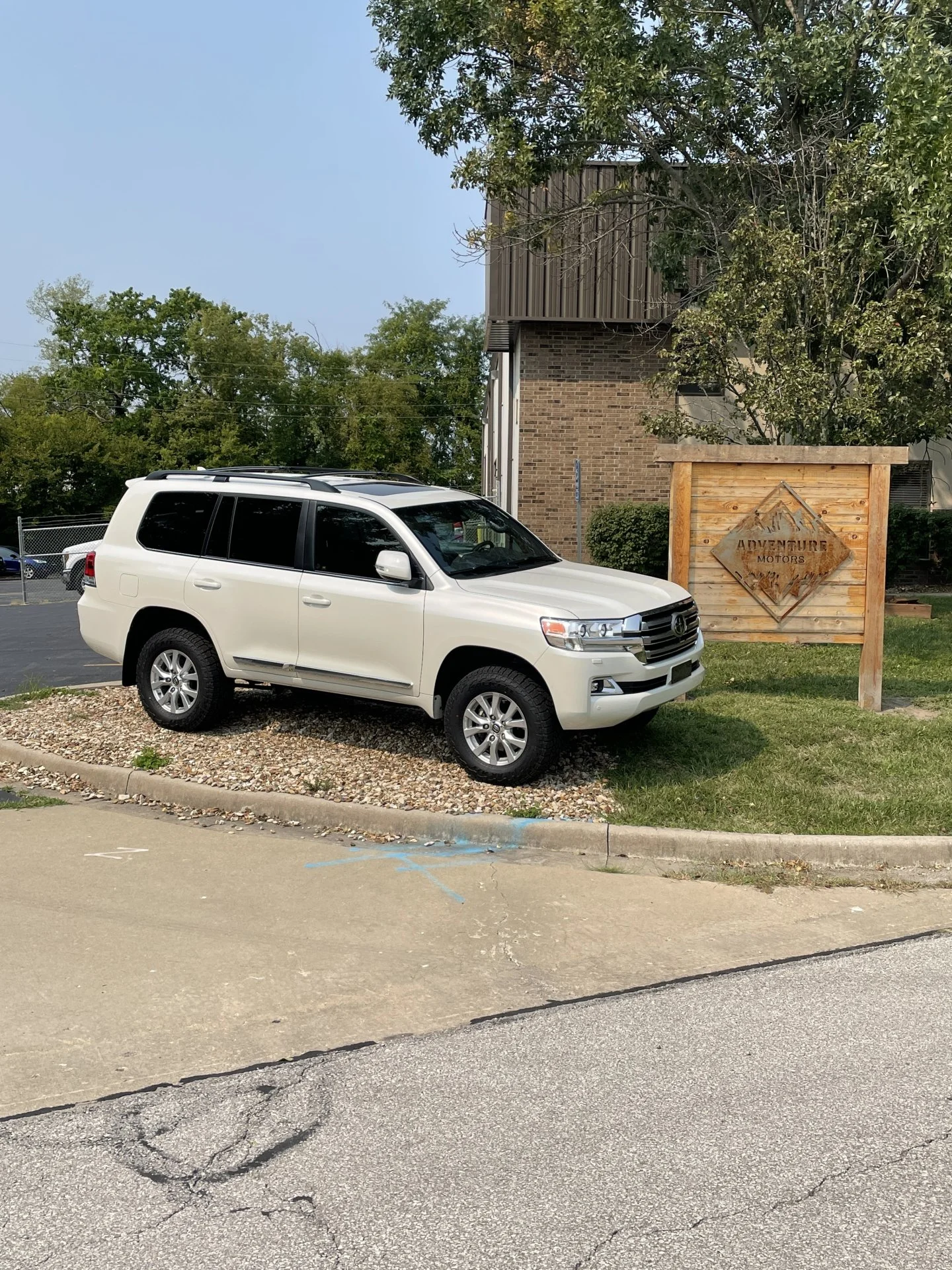

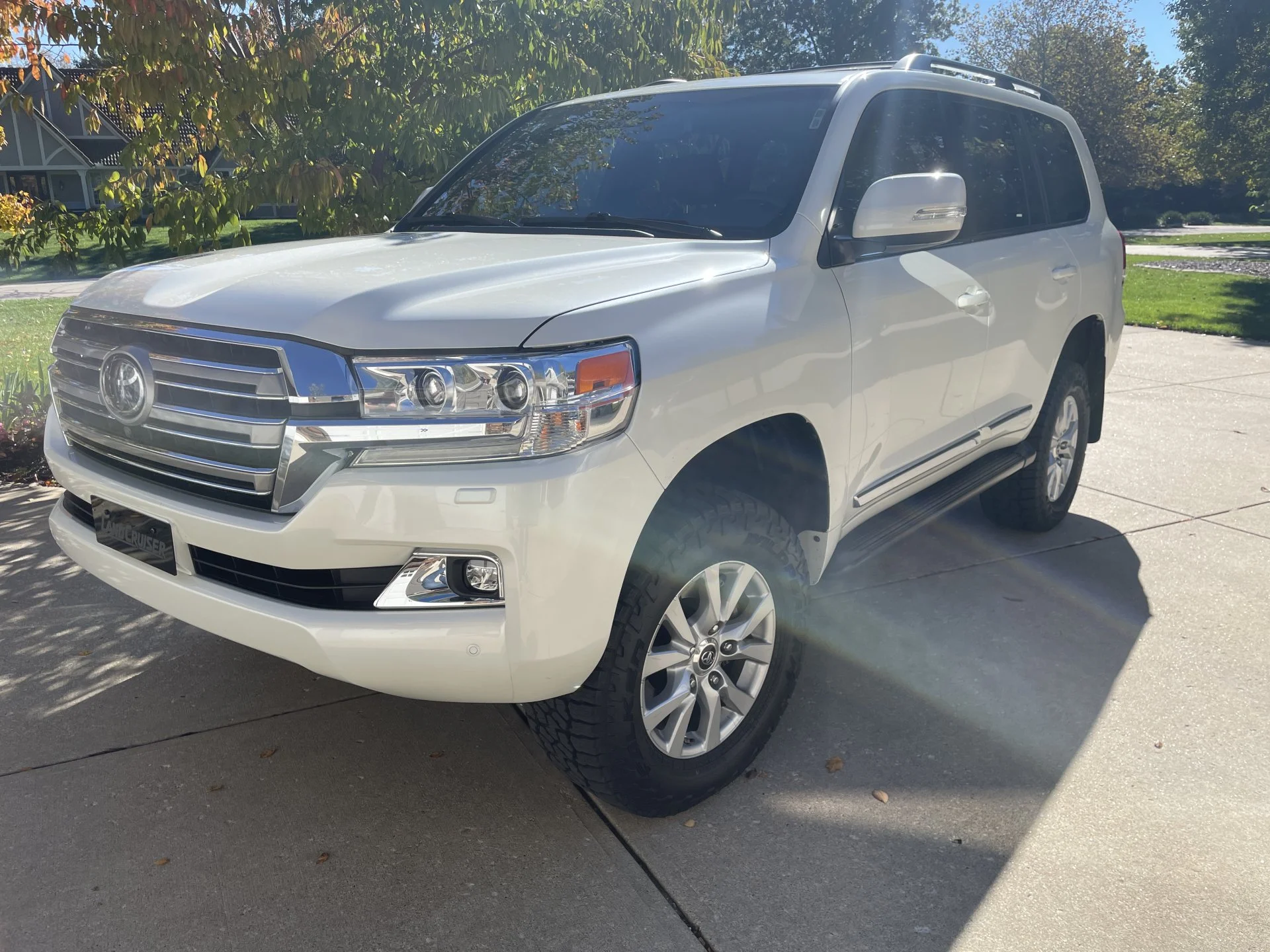

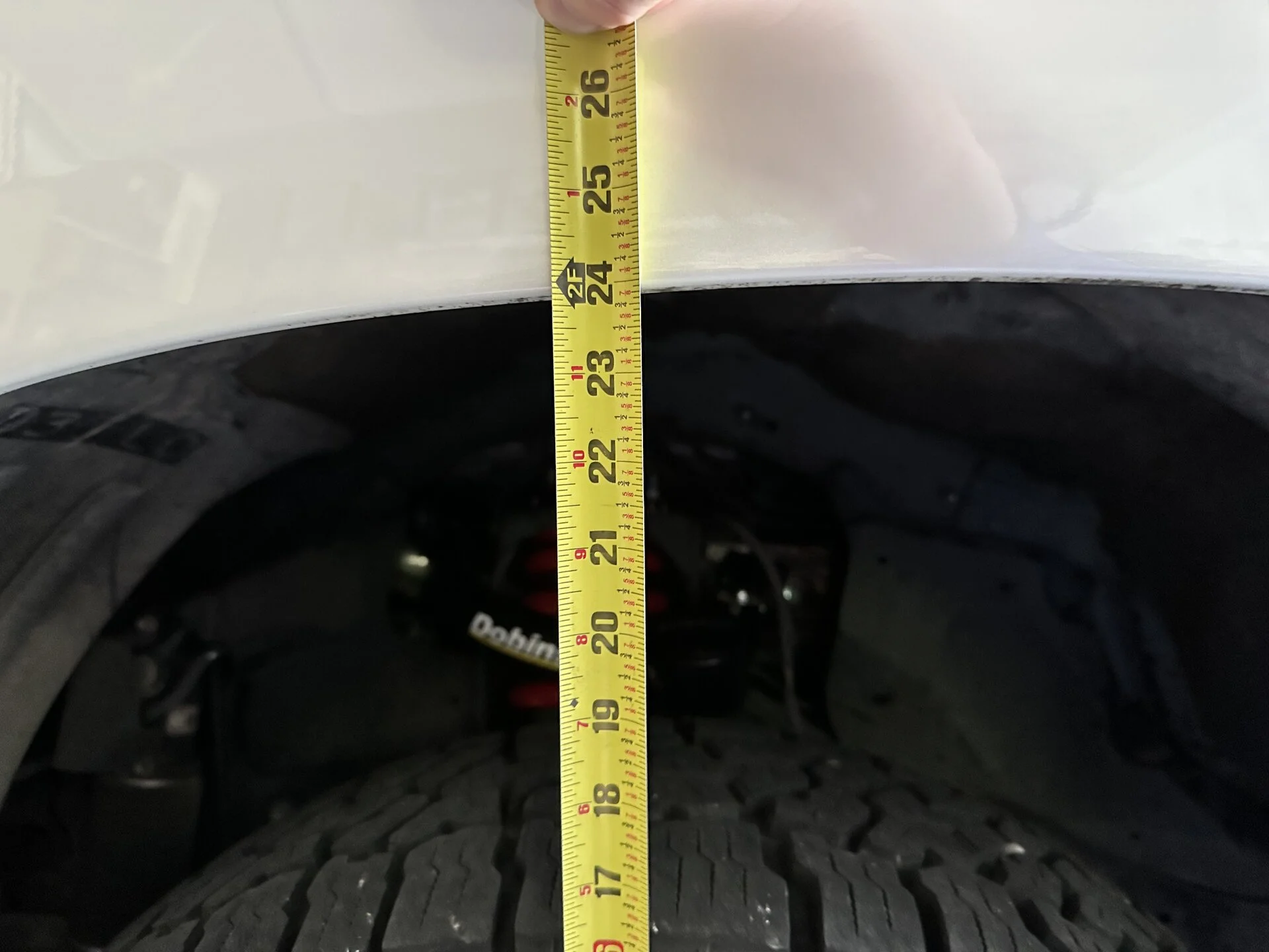

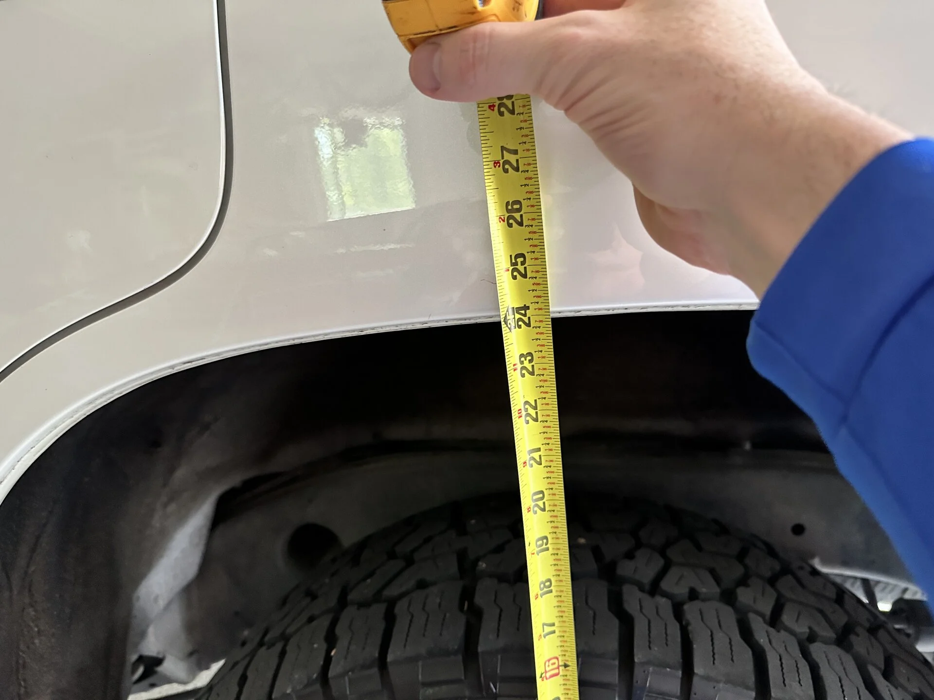

For those interested in the lower cost Dobinson IMS kit as compared to the MRA kit. Was purchased and installed by Adventure Motors Kansas City on my 2019 LC. They did a fabulous job and shout out to my guy Drake over there. Adventure Motors - https://adventure-motors.com/

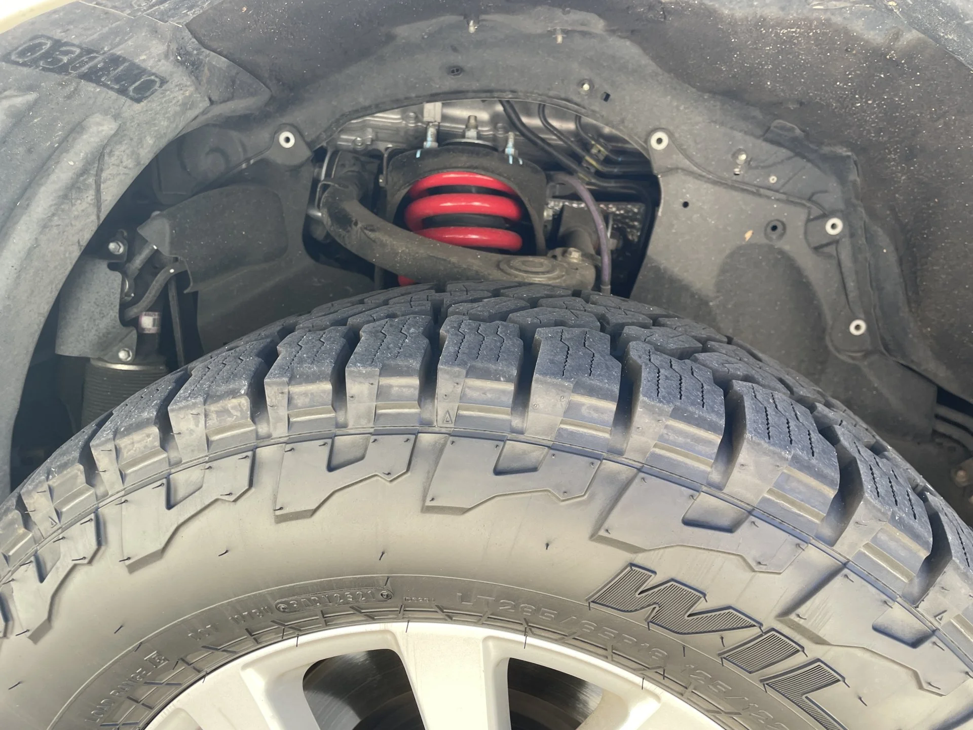

Parts & Part #'s
Front Springs for V8 4.7L or 5.7L Gas : C59-542 (50mm-2") lift coil - 0-110 Load (Red)
Rear Springs: C59-545 (50mm-2") lift coil no load (Red)
2 Front IMS Struts, 2 Rear IMS Shocks
Optional Install Parts: DD59-530K Diff Drop Kit (Recommended for 2" Lift) (Installed)
Falken Wild Peak 285/65/18

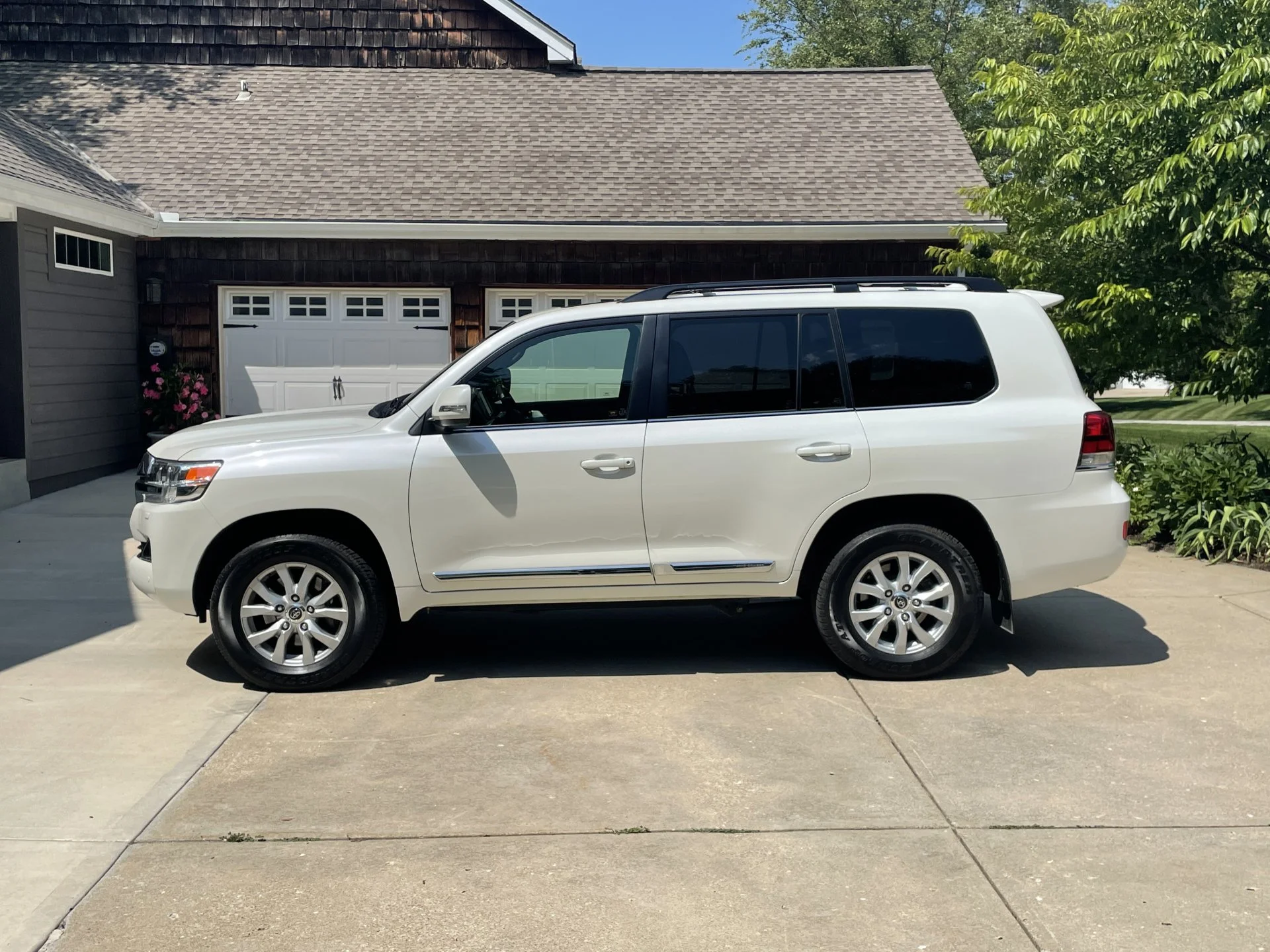

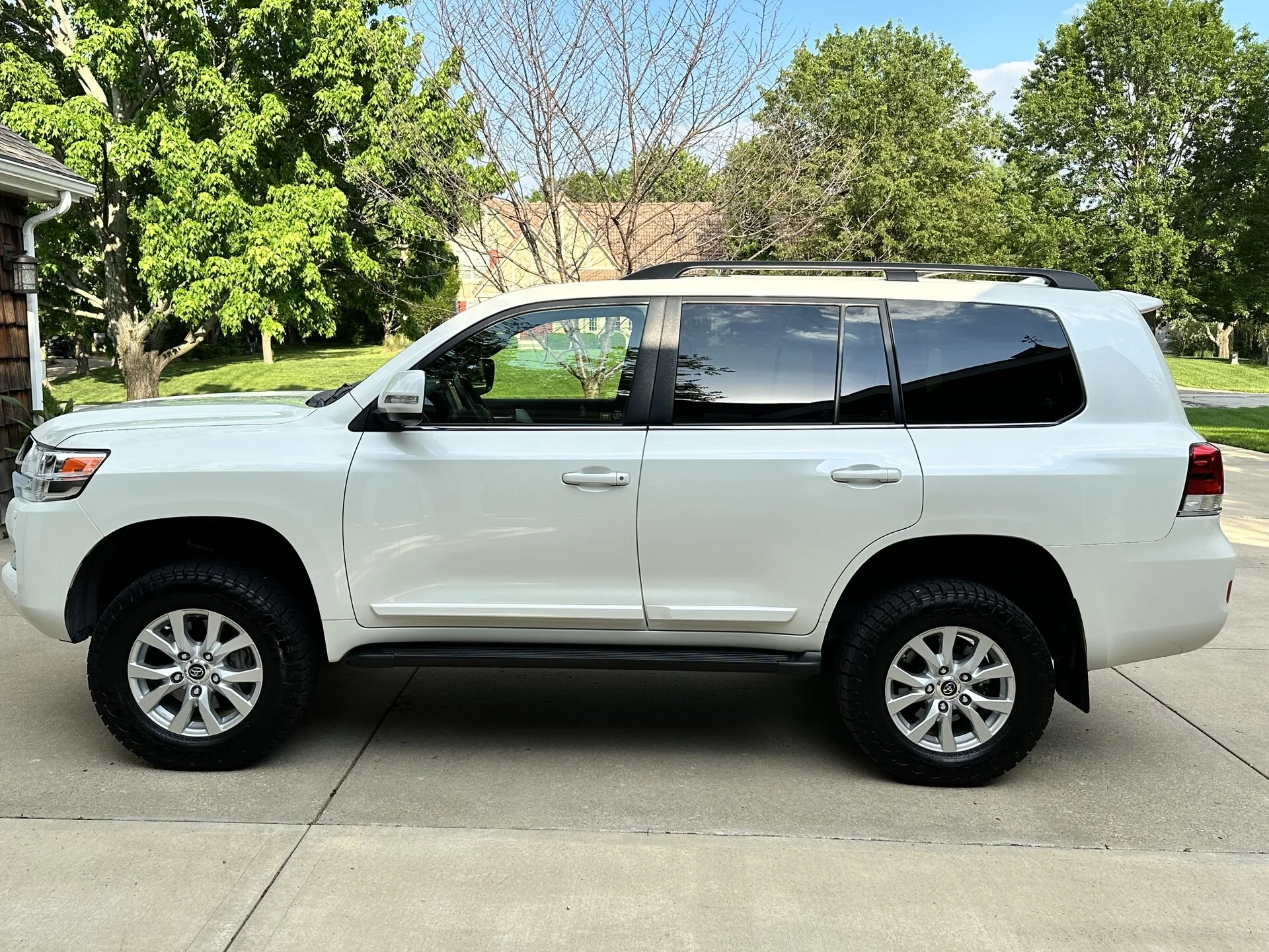

Gain was roughly 2.5" in front (no load) and about 3/4" in rear over stock rake. No rubbing issues at all.
There is still a slight rear rake but levels out nicely pulling my boat. Ride is great, took about a full 1.5 MPG hit.
Before and after pics:

I am not sure about the 34's, there is plenty of height clearance but the inner well rub might get you.
The ride is great, no nose dive, it is high I will tell you that. Smoother than stock, probably not, stock was a little floaty to me, this is solid without being rough. I actually took my running boards off at stock then put them back on for the Mrs. I am tall 6'5'' and I step down to the ground, the pictures dont do it justus to just how far it is off the ground. With that height it is a little more top heavy IMO. I am not pulling any G's though!

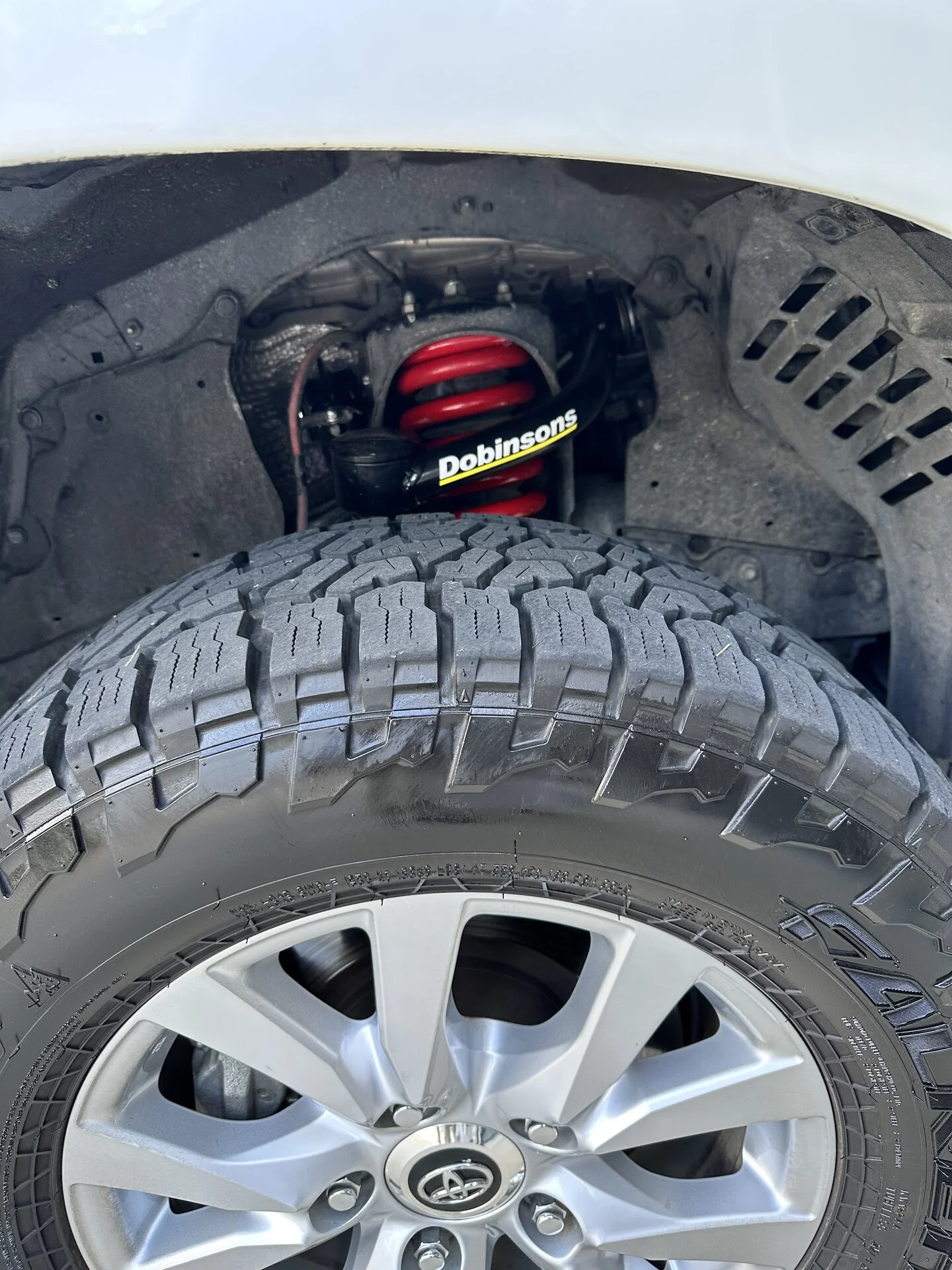

Did some upgrades today. Adventure motor sports in KCMO did the work. New Dobinson control arms and changed the springs out to C59-544 had the 542's originally. Front is just shy of 1/2 lower than the rear. Definitely on first drive it is a little stiffer up front. I think I can definitely get some 34's under it next tire change.
Looks great with the new upgrades. I am doing a little research on the Dobinson lift. My local shops loves them over other lifts.
PS love your body matched painted body moulding on the doors. Was a pretty simple deal? I always thought I wanted to paint mine flat black but the white looks awesome!
My local shop Adventure Motors are big fans and guided me that way. It works well for my needs. I actually have that other set I originally put on. They would work perfect with stock rear springs.
That is actually wrap and it has worked out great. Been about a year now. I run it through car wash weekly, no issues. I bought the wrap on Amazon, 3M has a color match. Local shop charged 300, I just took them off and gave it to them.
