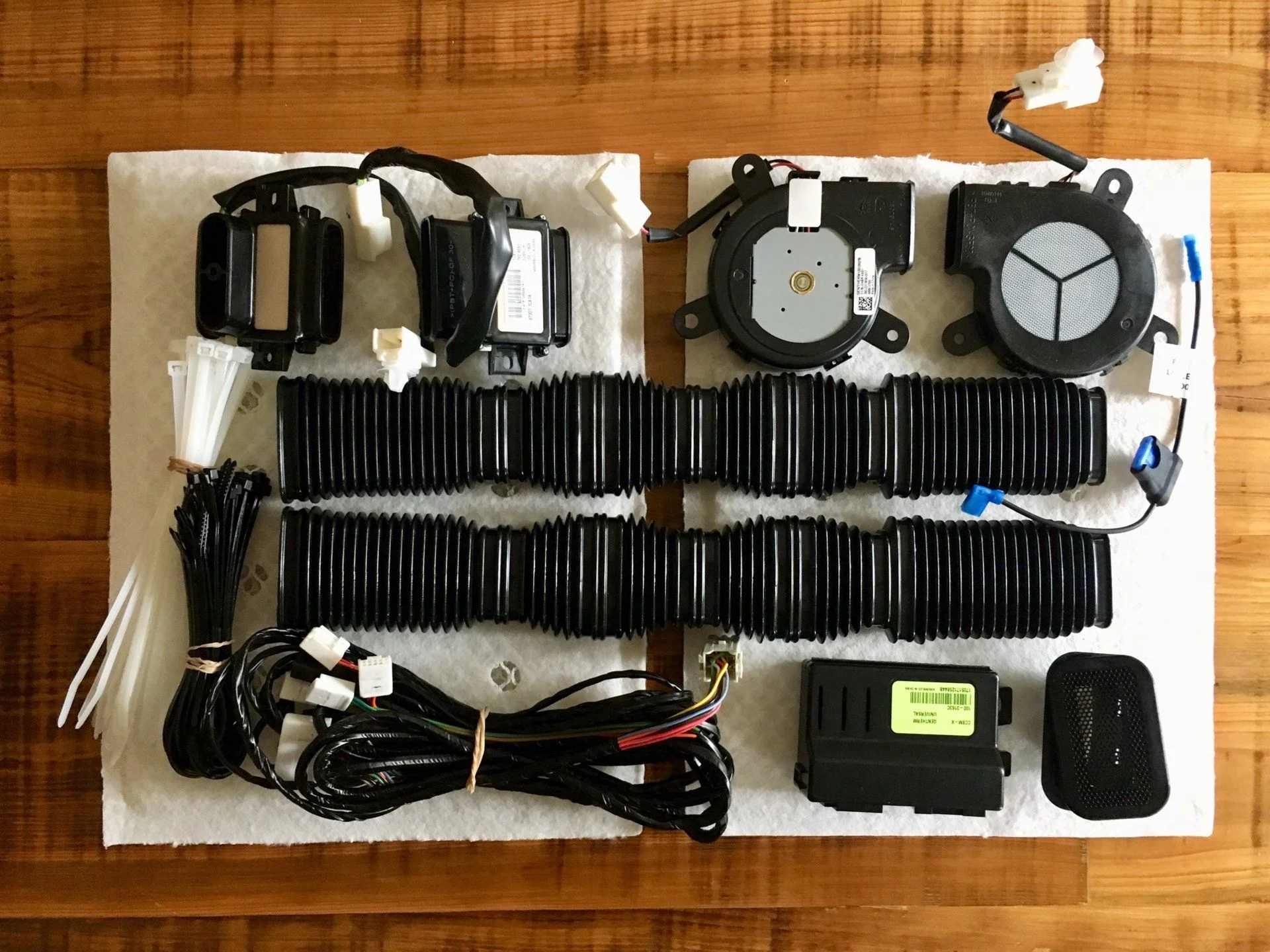

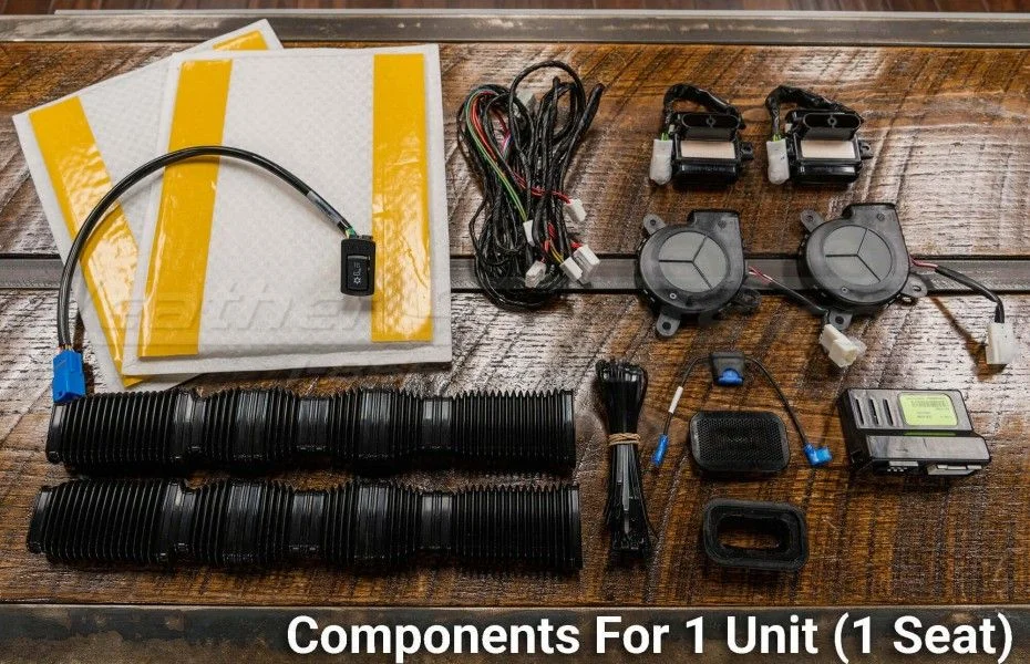

One option I found online is using the Sanctum Seat Ventilation System from Leatherseats.com. Its $350 per seat. I've contemplated buying two of these and a set of seat heaters for the rear bench.
Another is the Champion Seat Heater/Cooler system at $249/per seat.

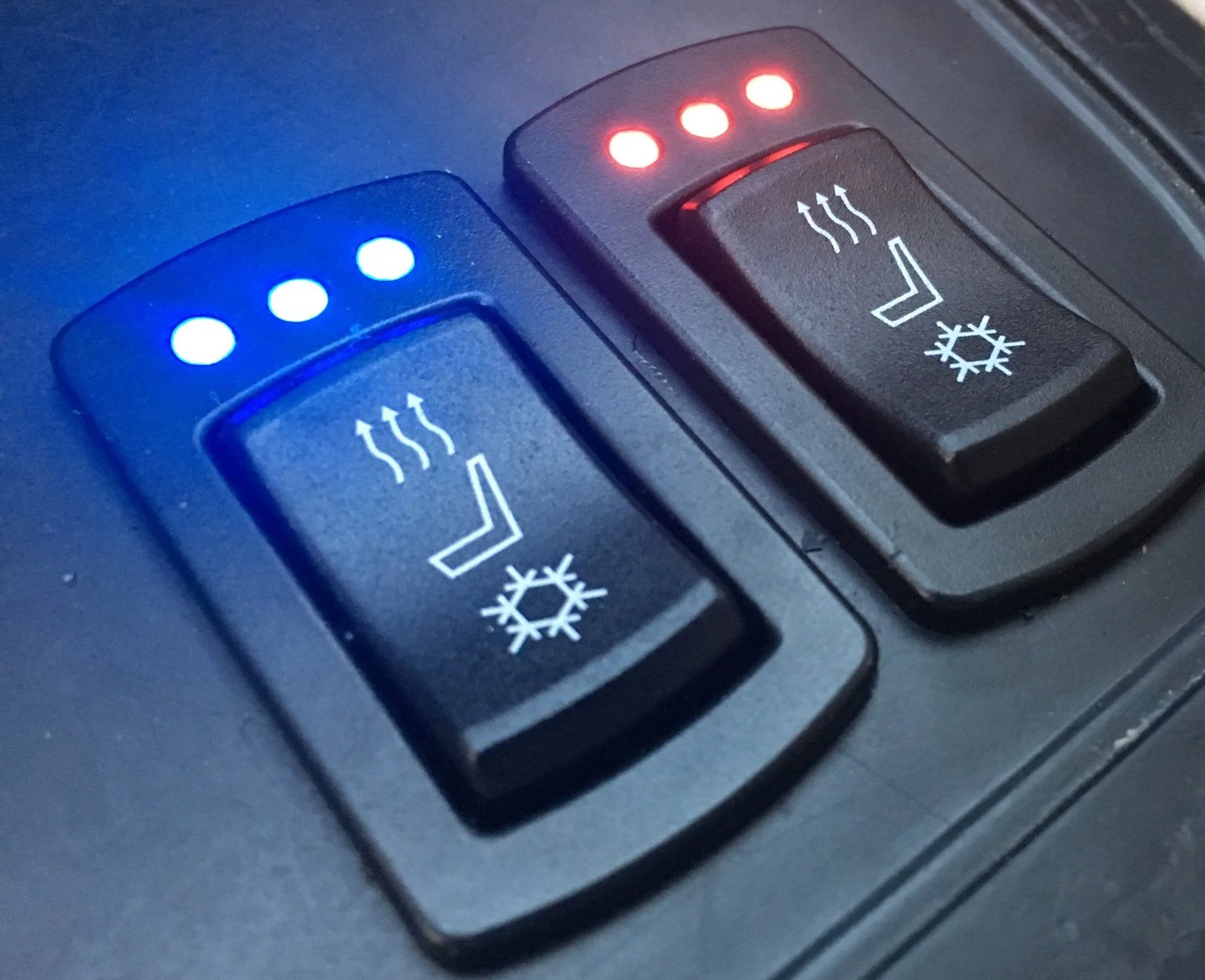

The heater/coolers above look just like the Gentherm system (now sold as Katzkin Degreez), and they work great in both heating and cooling mode. Yes, they do cool vs just blow air. (Full disclosure: I sell them :grinpimp:)
Your upholsterer should know this, but you need reticulated foam backing running the entire length of the perforated inserts.

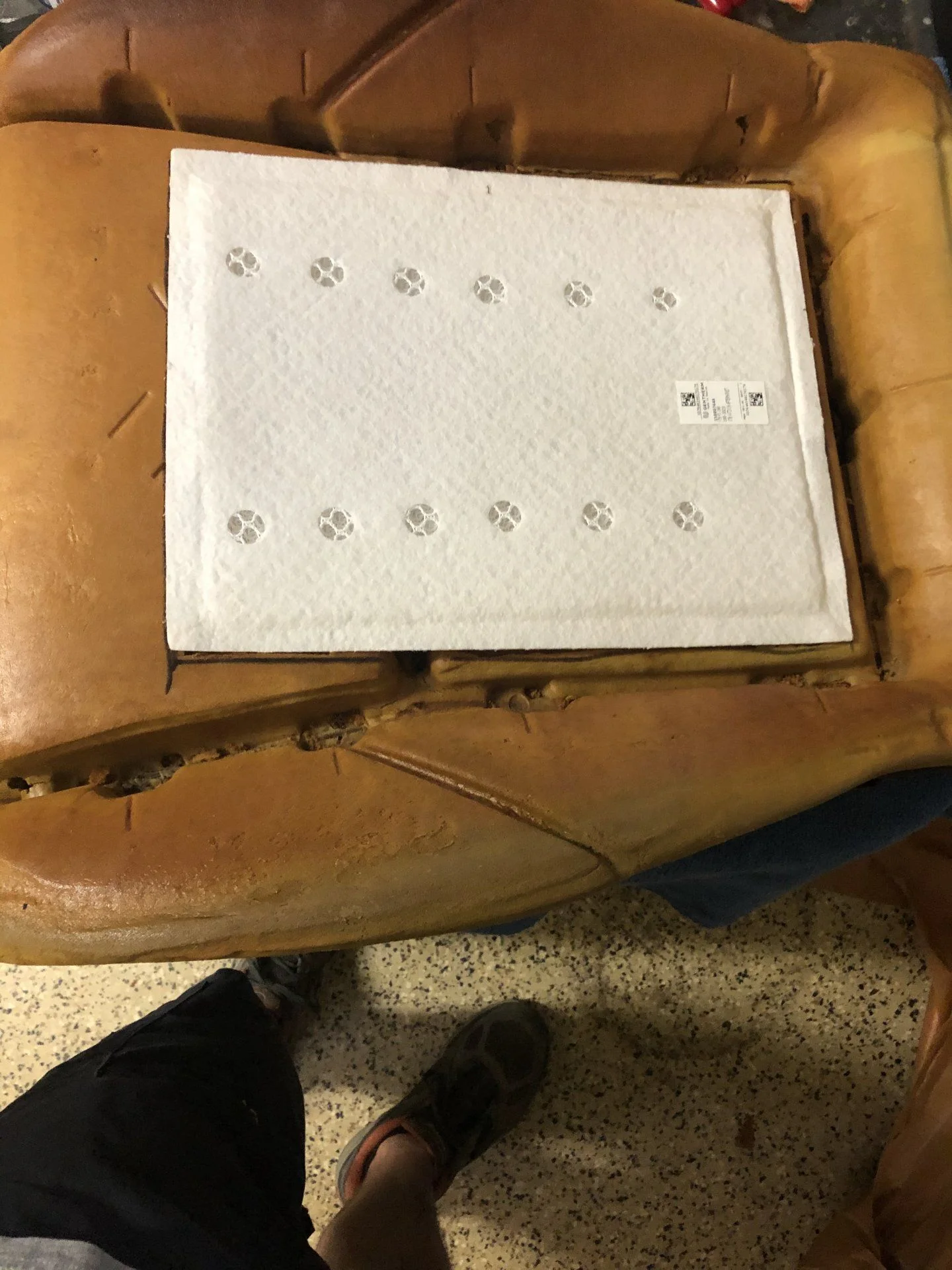

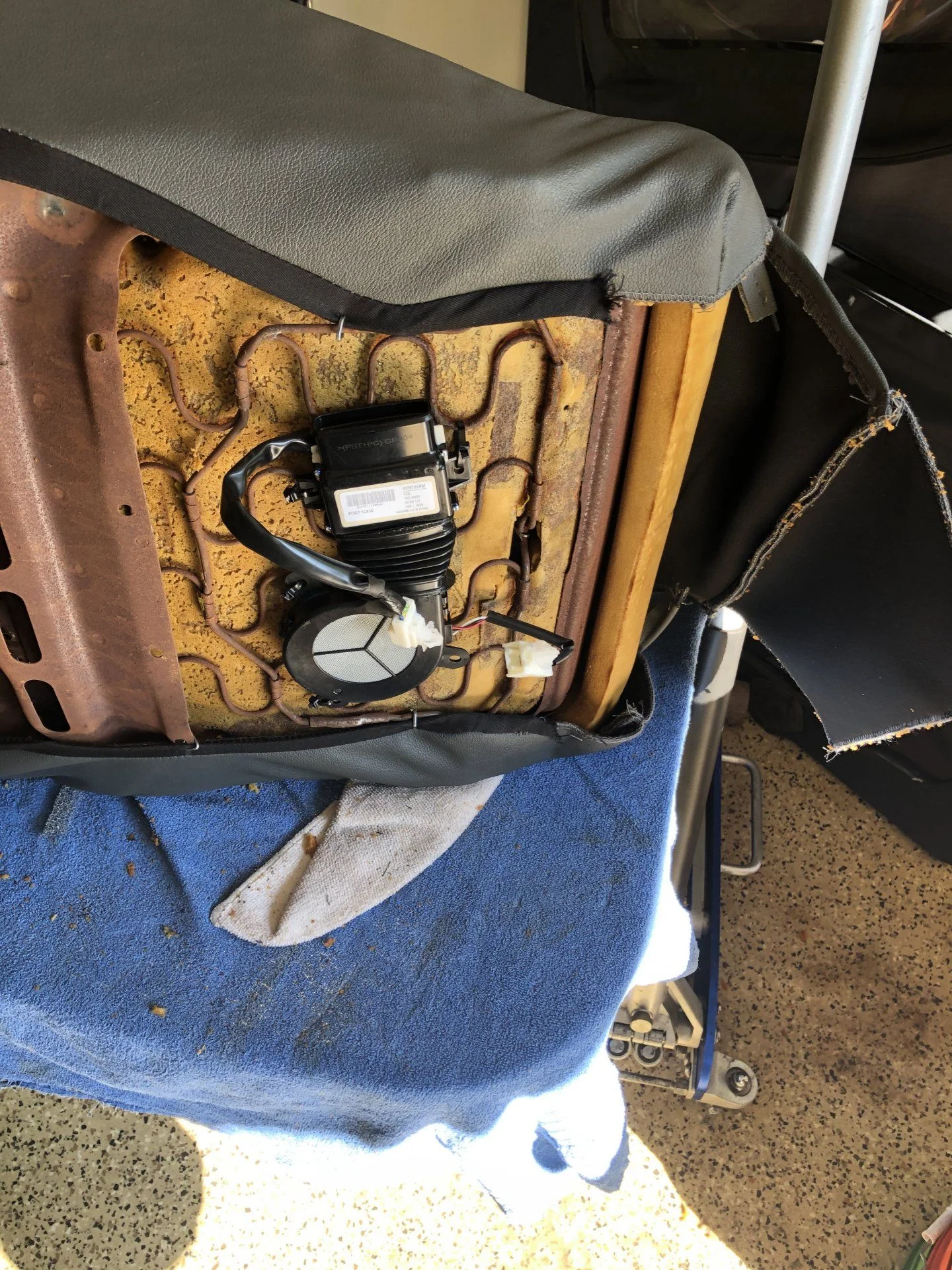

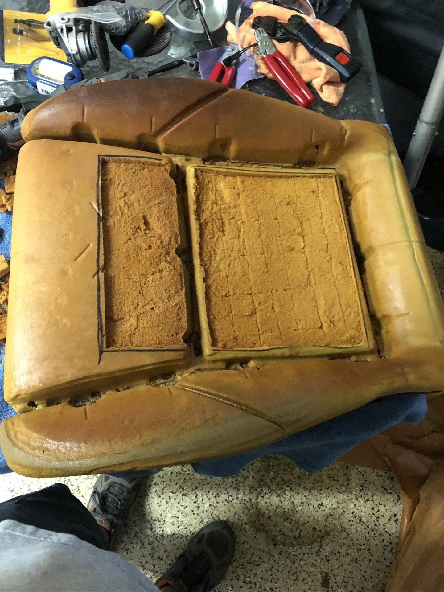

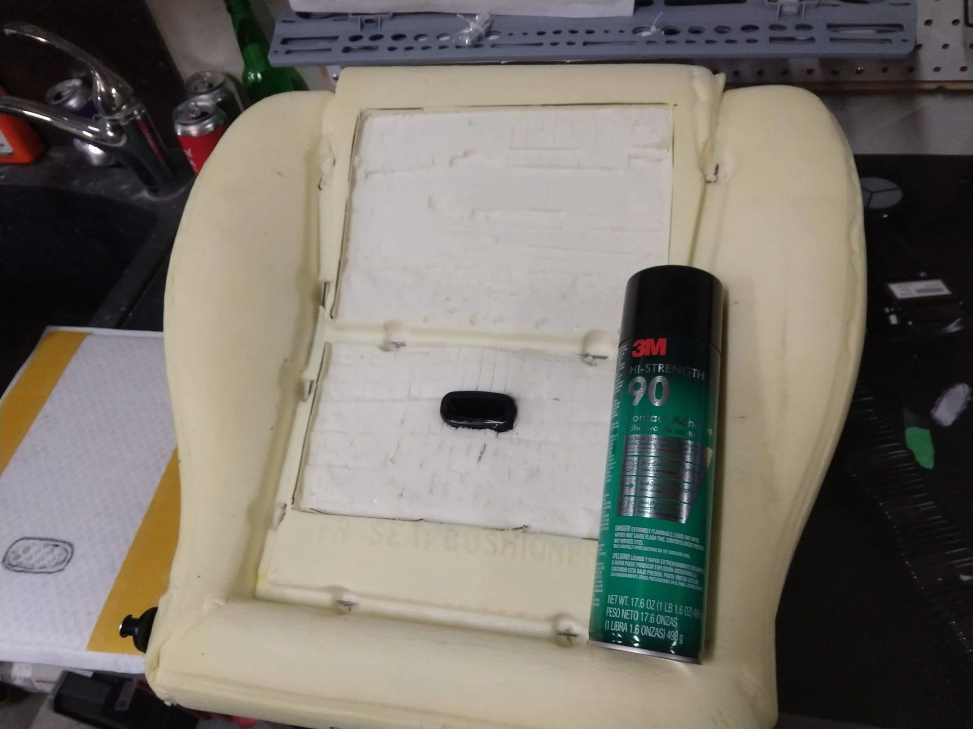

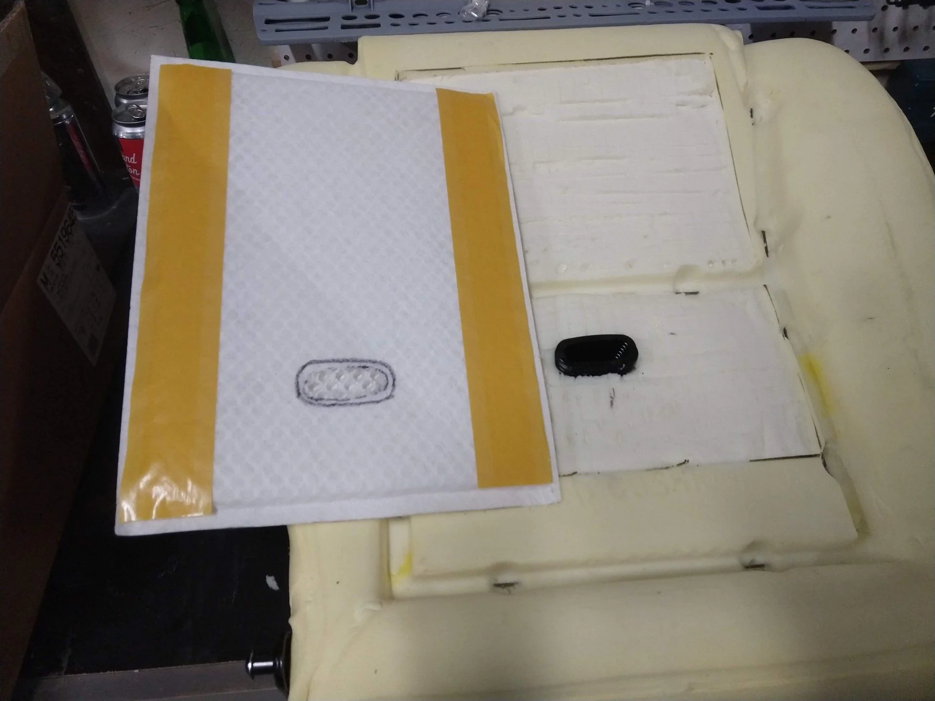

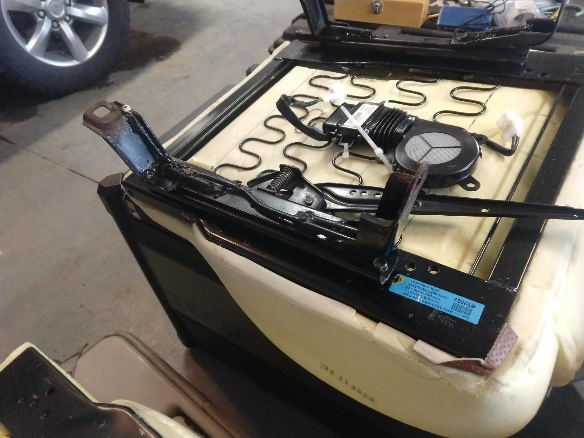

I took the brackets off my OEM seat and it might be a little crazy, but I think they might actually work on the Bestop Seats without any modification. It will be off by 1/8" - but that's fine by me with some screws and bolts... This ended up taking forever. So if you go this route, plan for 5-10 hours of work to cut out the foam, shape it and make the cuts in the tubing for it to fit perfectly. I haven't even finished the electrical installation yet or had the seat reupholstered.

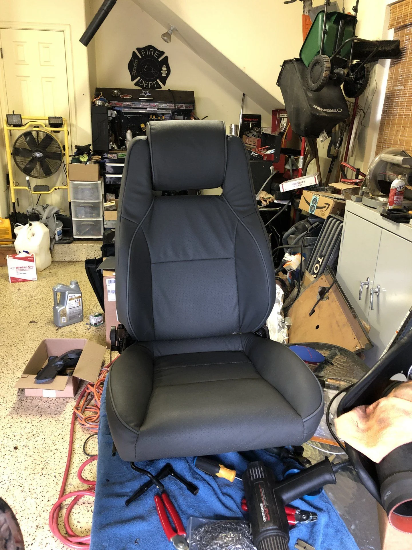

Yes @4wdgr8r got it all done. Been using it for over a year now. Game changer.
Summers I have cooled seats and during winter I am nice and cozy (very nice when it’s -30 degrees in Montana).
